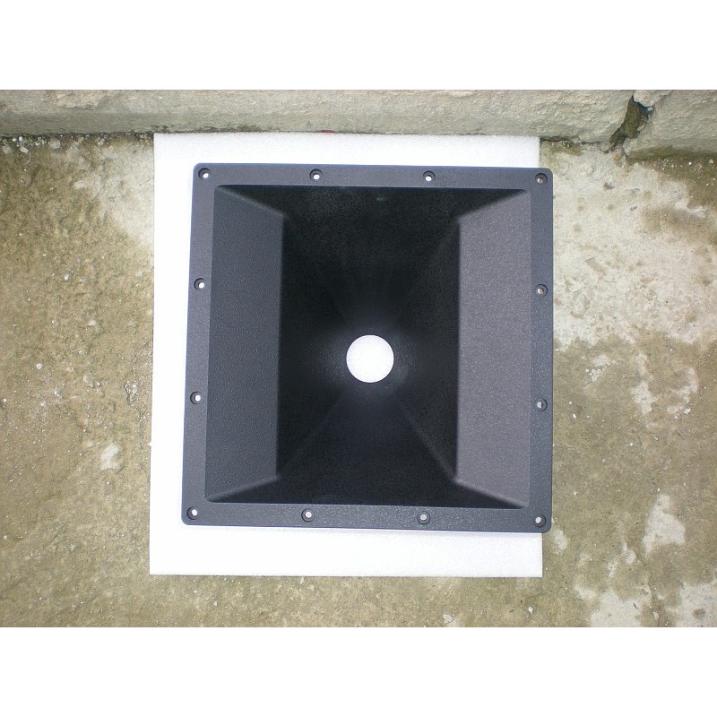

I also have a pair of AXi2050, but I havent desided wich horns for them yet. I bought some cheap P.audio PH 642, just for getting some sound from the AXi'es.

Here are the in room raw response without EQ in these cheap horns.

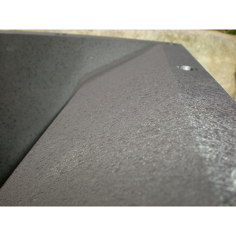

What's your overall impression of the Axi2050?
That horn, straight walled with 2 steps in the horizontal plane, is not too bad and doesn't produce the typical cuppy/quacky horn sound.
This is due to its smooth throat area and limited depth.
It could be improved with a mouth section that's 3-5 times bigger, which would reduce the ripple.
