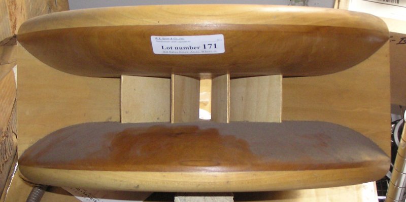

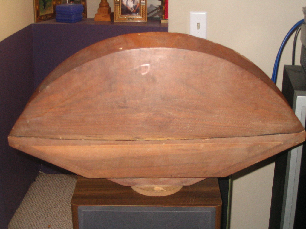

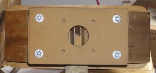

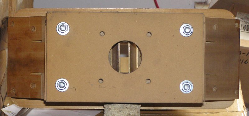

Augspurger horns in the later monitors are actually more akin to radial horns. In the past, Augspurger (also used) the Westlake style Smith derivatives, which came with, and without vanes (for the smaller HF horns).
Augspurgers are completely DSP-ed these days, but the old ones are presumably crossed at 800Hz or even higher, which is still quite low considering the size of the horns.
Anyway, Augspurer's old constant voltage networks are quite complicated/ingenious.
Here's an AES comment paper, in which he also touches on the angled baffles.

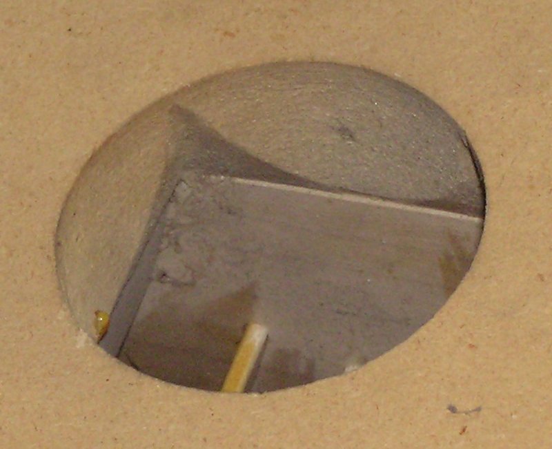

Westlake Smith horns, check the chamfered mouth:
Augspurger Horn:

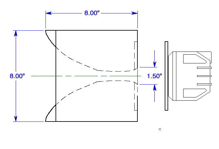

Second, why would a large horn beam any more than a small horn of the same design, say large jmlc vs small jmlc...of course the pattern would contain more frequencies within the directive spectrum of the horn but the beaming of the treble....why wouldn't that be identical...this aspect is governed by the exit size, is it not? If both horns have a 1.5" exit then the beaming should be identical as well, if not.....why not.
Someone else with more knowledge than me I'm sure could answer your question better, but since no one is trying I'll chime in. We discussed this many pages ago sort of, but the way I understand it, the angle of the horn walls at the frequency in question is the issue. A Tractrix has fairly parallel walls at the throat (where high frequencies launch so to speak) so it has narrow directivity at those high frequencies. A constant directivity horn like an oblate spheroidal is wider angle right from the throat so wider directivity there. A larger Tractrix horn profile will have to stay narrower longer in order to keep the profile right if that makes sense. An OS waveguide would suffer less . Just look at a large Tractrix, that throat is so long. Even at the point where it's 3" in diameter the walls are fairly parallel, yielding narrow dispersion at the wavelengths loaded at 3" area. In a smaller Tractrix at 3" diameter the walls may be flared significantly. Think about it like a garden hose spray nozzle, with small wavelengths squirting from the throat and lower frequencies squirting from the mouth. wavelength launched from a given spot of the horn correlates with the horns area at that point.
I understand this is an idiots guide and it would be an honor to have someone explain to me too exactly what's wrong with my analogy.
