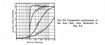

I often see flare rate specified as a frequency, ostensibly the cut off frequency of a horn with that flare rate. Is there a mathematical formula for this or is it just a heuristic?
Chapter 5 of this is the best info I've stumbled on re flare rate / cut off.

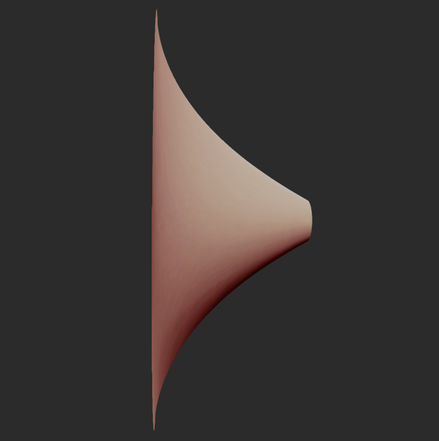

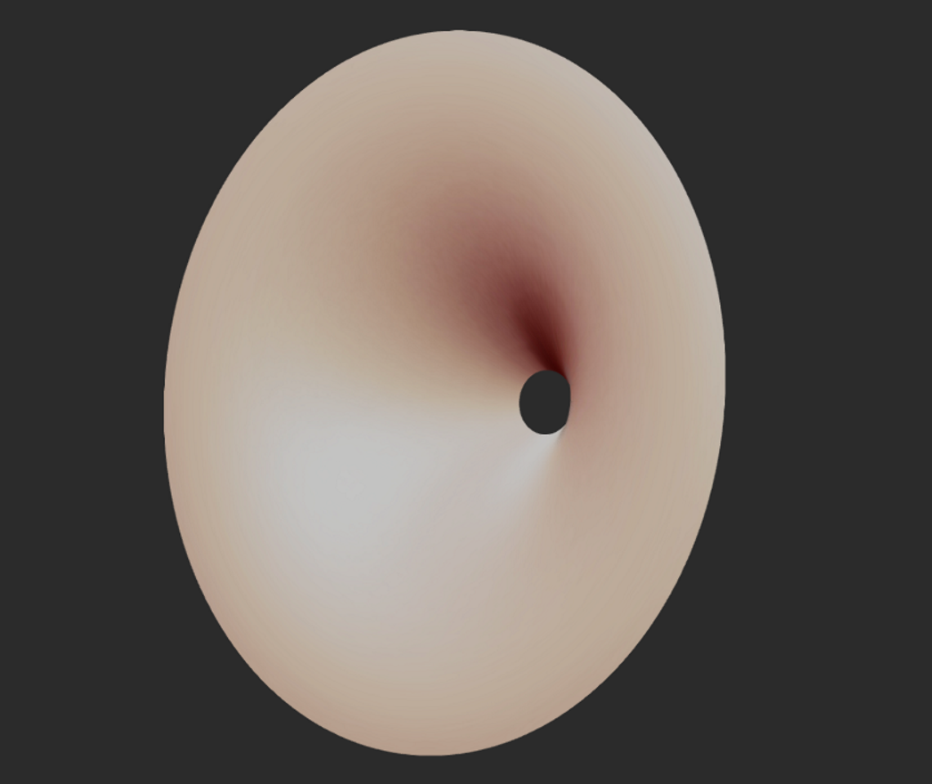

Sure, the curvature effects the area expansion, although less than the starting area for determining rate of expansion
If using area expansion as the definition of flare rate:
Isn't the highest flare rate at the throat where curvature is lowest?
And the lowest flare rate at the mouth where curvature is highest?
I think this is why I get confused when flare rate is interchangeably used to describe both area expansion and curvature...since high and low descriptors get swapped...
You're correct, the flare rate depends on the horn's flare type (its mathematical curve).
A tractrix has a lower flare rate at the throat and much higher towards the mouth. This is why people often prefer tractrix to exponential, because the latter doesn't open up to the same extent (the flare aka the curve is exponential).
It's confusing.
In my previous post I zoomed in on the OS throat section.

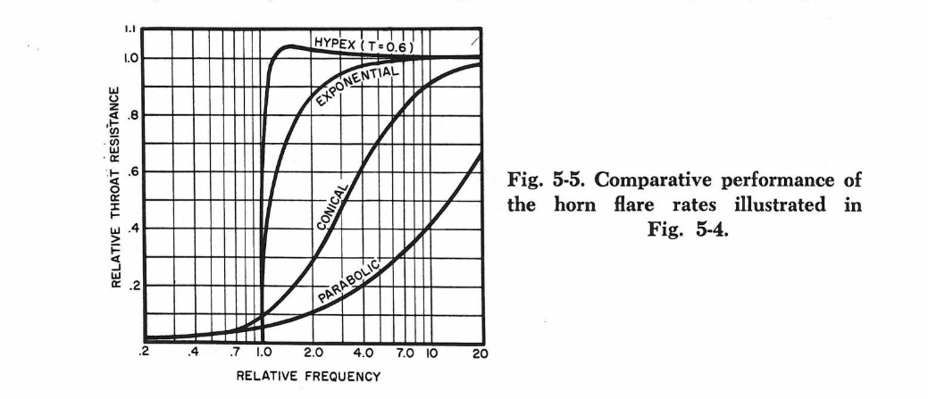

I am starting to get confused myself...
If we consider the curves in the plot below to be representive of "Flare Rate", then for the exponential it's nearly constant (very low) at low frequencies, increases in the midrange and decreases above 7kHz.
It's still confusing, because this plot shows flare rate versus throat resistance across the frequency range.

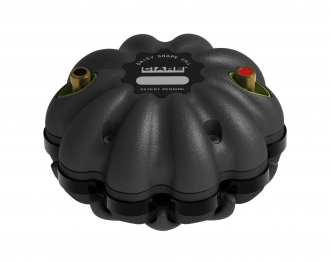

I've never seen any of those 'being used' either.
A bunch of the appurtenant drivers - FMJ - 60 "Daisy" - were recently offered at 50€ each.
![449_foto.jpg](/community/proxy.php?image=http%3A%2F%2Foem.ciare.com%2Fik_files%2Fcatalogo%2Fimg%2F449_foto.jpg&hash=3f72d84bfd162c6280bb4534ce0b9646)
Due to the short throat there's hardly any loading of the driver below, say 800-1000Hz.
Is this problematic? Dr. Geddes doesn't think so, but I would still be interested in a "1P to the power of 1.4" OS throat![]()
The "loading" - as much as I dislike that word - depends on the angle of the OS waveguide as well as its radius. Hence, for a 90 degree 1" waveguide the radiation resistance is falling below about 500 Hz. A narrower angle lowers the cutoff as does a wider throat radius.
These differ considerably from horn theory.
And no, I do not see any issues with loading from an OS waveguide. As I have said many many times before, this "loading", from the waveguide is insignificant in the bigger picture.

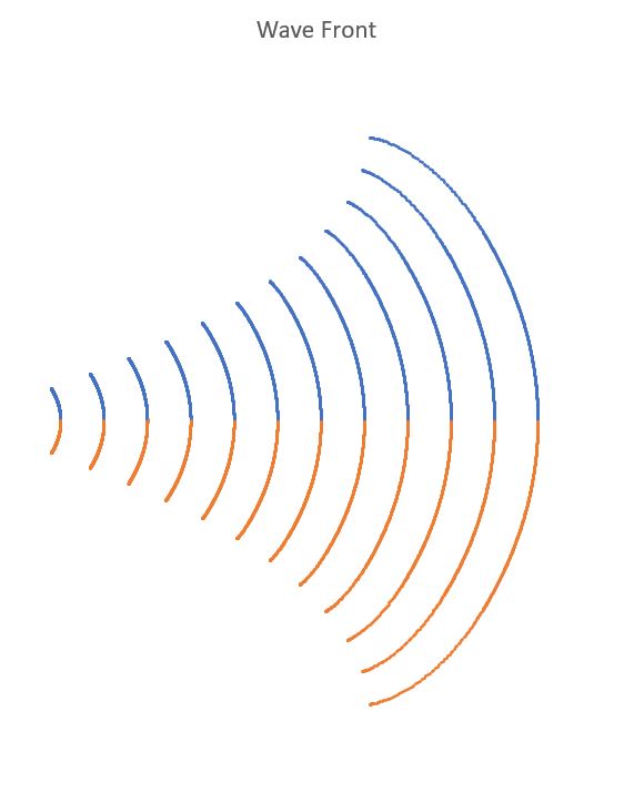

High Flare Rate Waveguide:
Your drawing of the wavefronts cannot be correct. For it to be correct, the wave would have to move faster at the center than at the edge - not possible.
In fact, it turns out that the true wavefront (not one drawn by hand) cannot have a curvature whose center moves past the origin (thoat) - it can be behind the throat, but not in front of it, i.e. the wave can be flatter, but not more curved than it is at the source.
