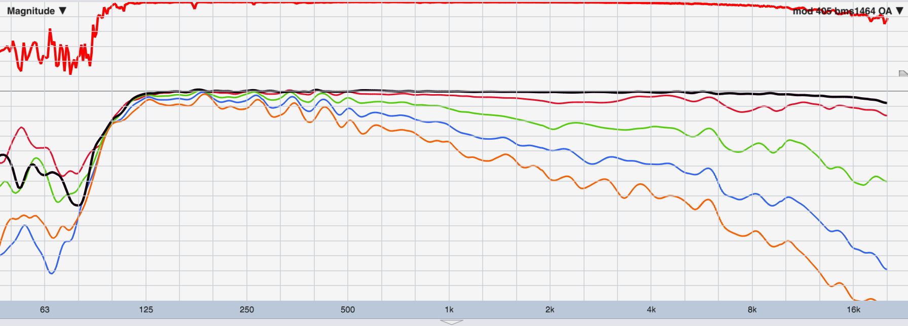

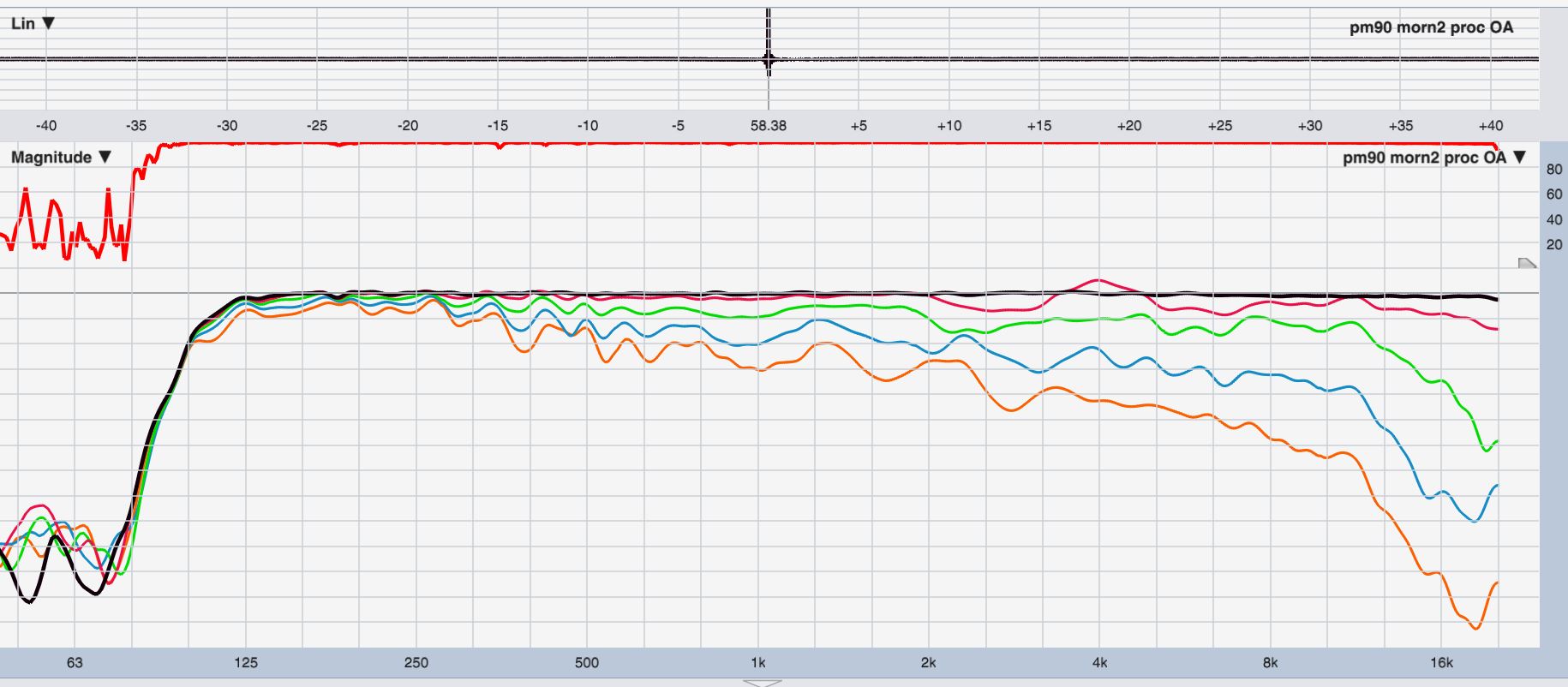

This morning, before the wind rose (and because test setup still in place) I reran the PM90.
It's the first plot below.
I found it interesting that the worst ripple was in the cone section (100-650Hz). (rcf mb12n351's)

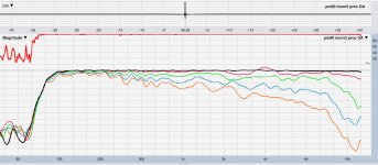

So for contrast, I quickly set up one of my modular builds that I often listen to indoors. It has a single ported 12"rcf mb12n405 which is in its own box and covers the same low/mid passband as the PM90/60s. Top was the same bms coax but on a xt1464 instead, and in its own box too.
Second plot below.
I find it doubly interesting that the low/mid ripple matched fairly closely, a single ported 405 vs dual horn loaded 351s. Need to explore this....
Wind was coming on quick, you can see its presence down low in the second modular plot.
So I only grabbed OA, 15, 30, 45, and 60 degrees for each...
Oh, Is there any software that would let me turn these magnitude traces into the polar plots you like guys have been showing? Like in your immediately previous post?

Mark, those responses look good! Wrt to Polar Maps, I don't know if Earl still offers this or not: GedLee LLC
Second plot below.

ARTA is one possibility:
http://www.artalabs.hr/images/directivity-sonogram.gif

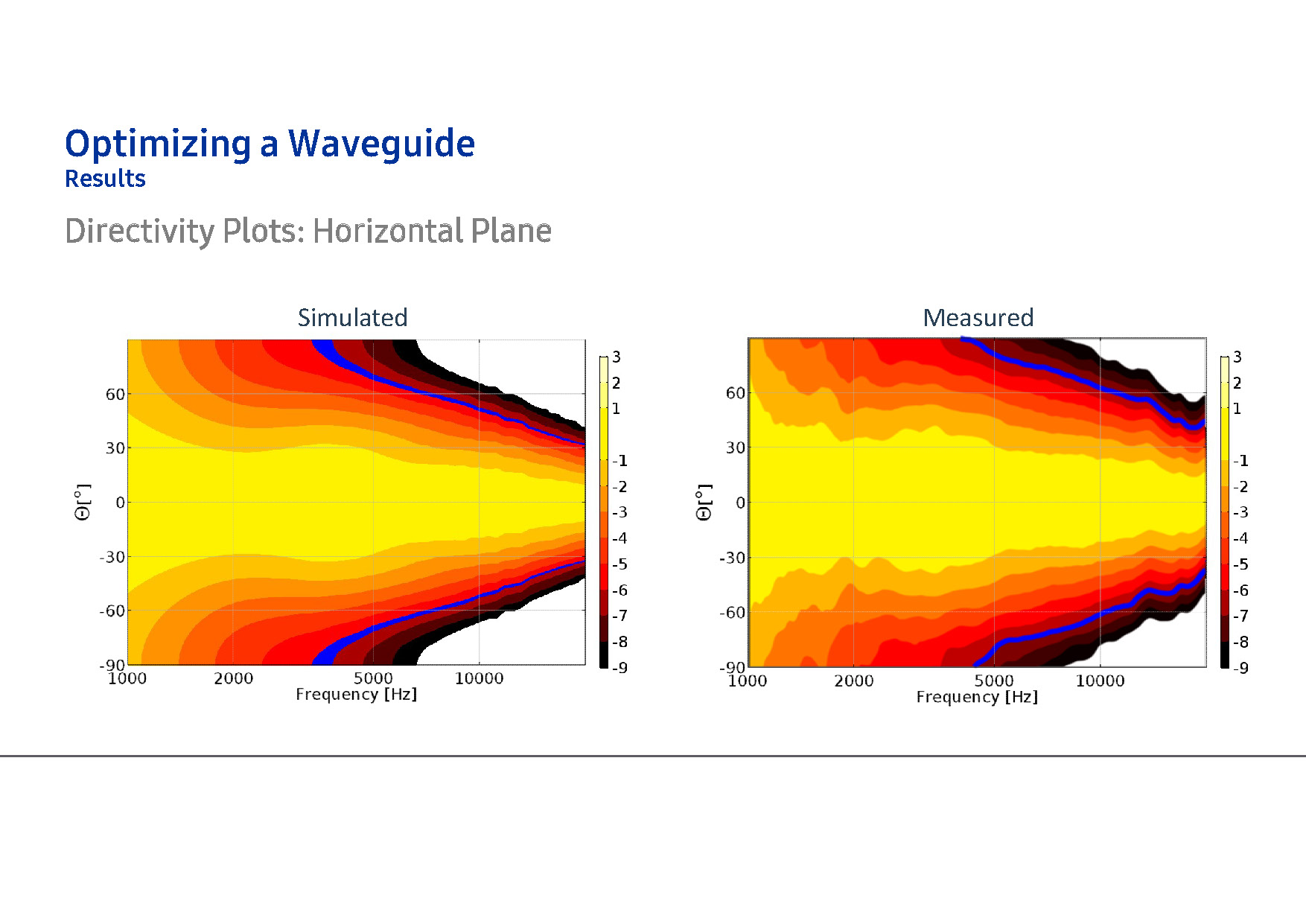

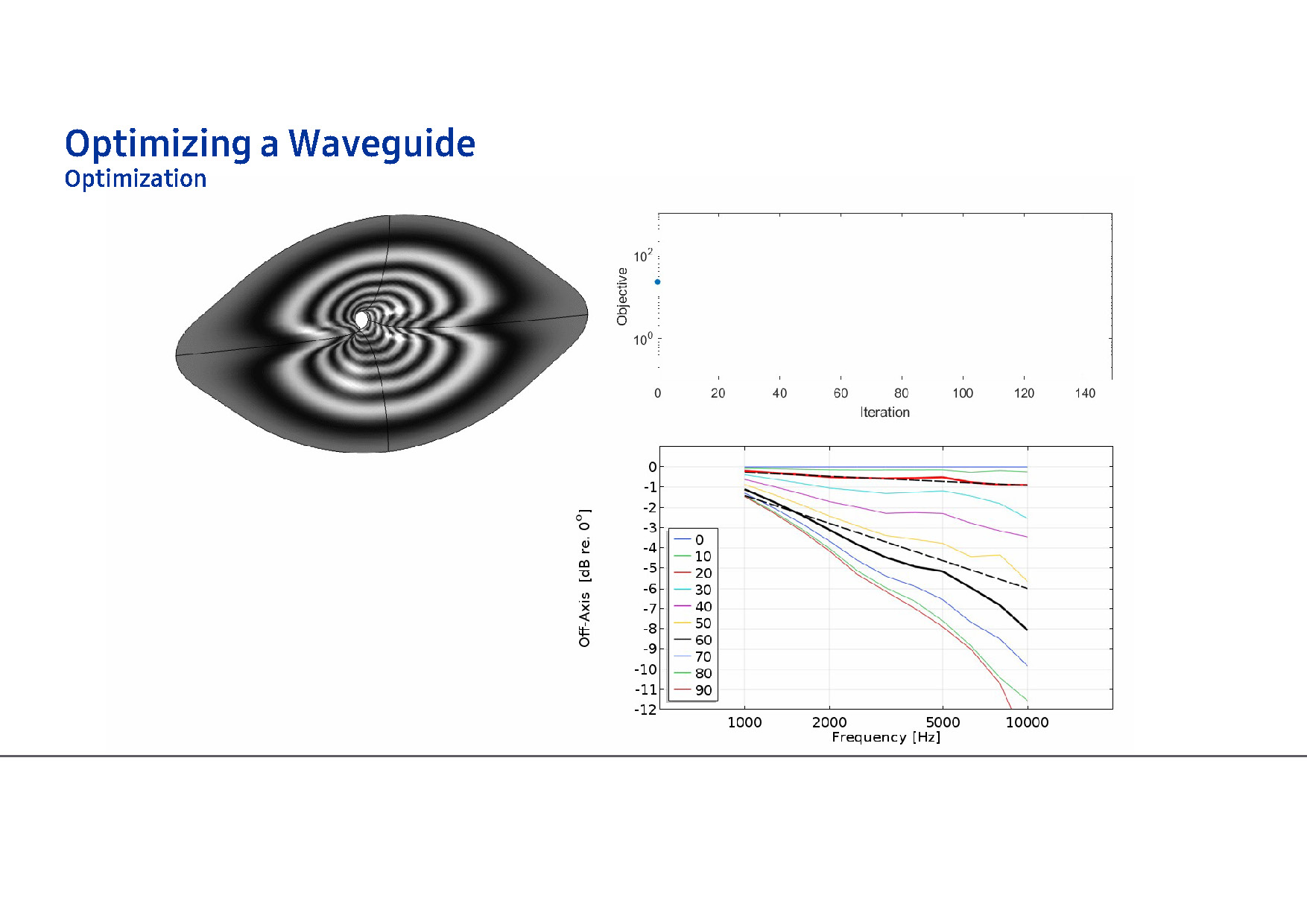

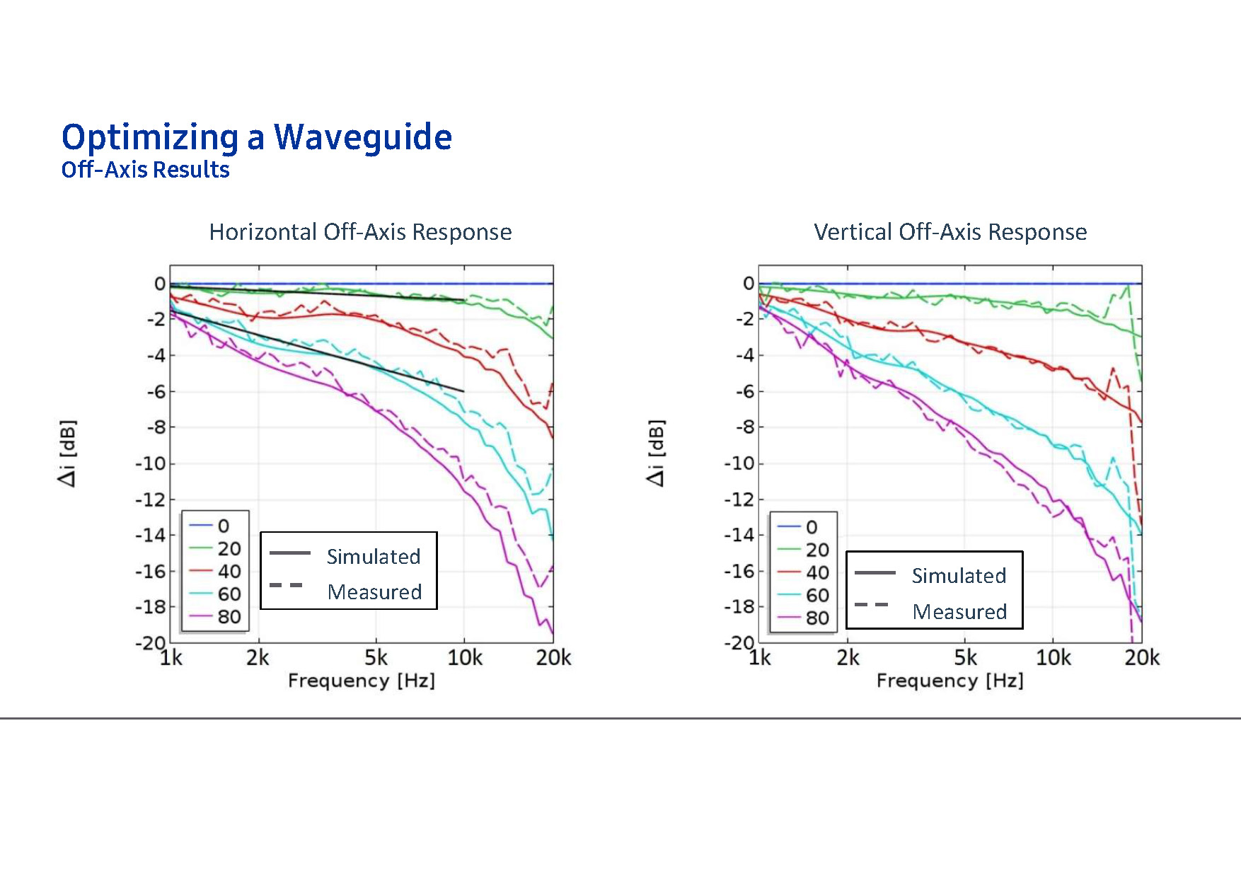

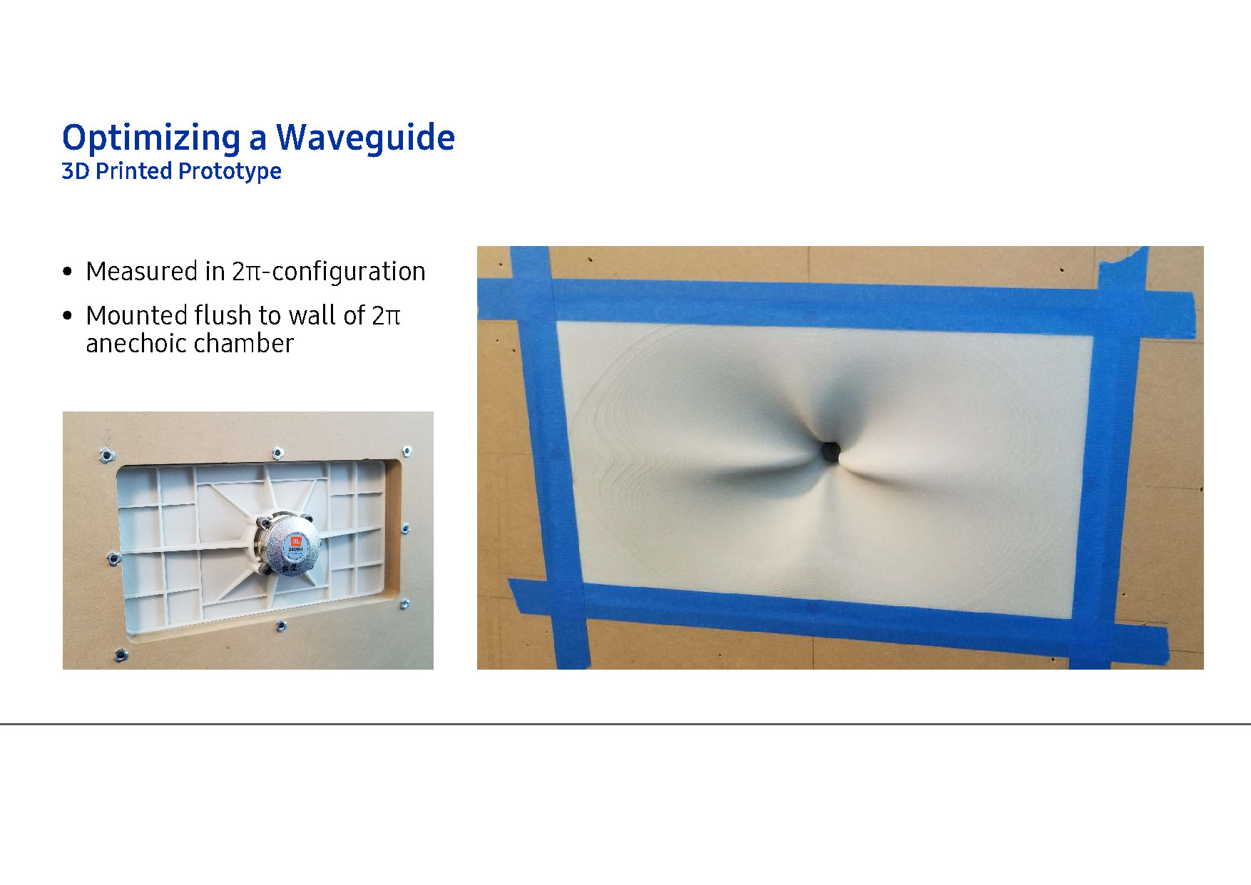

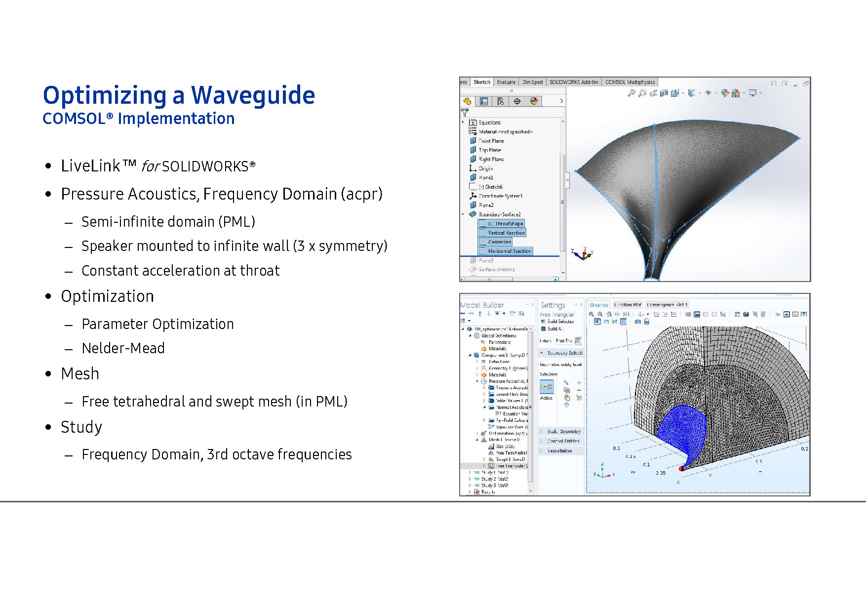

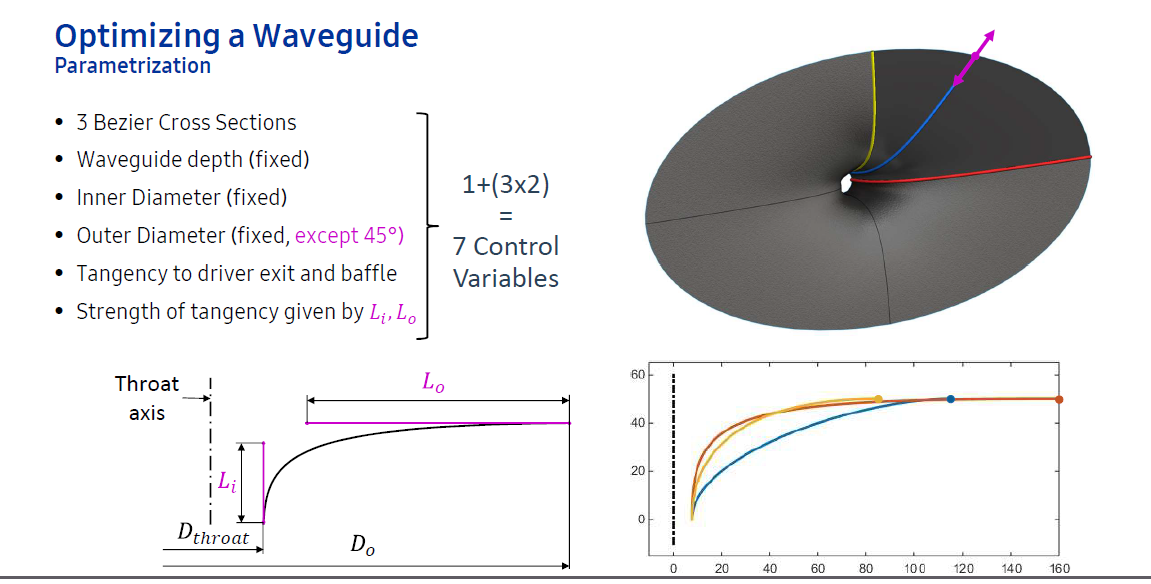

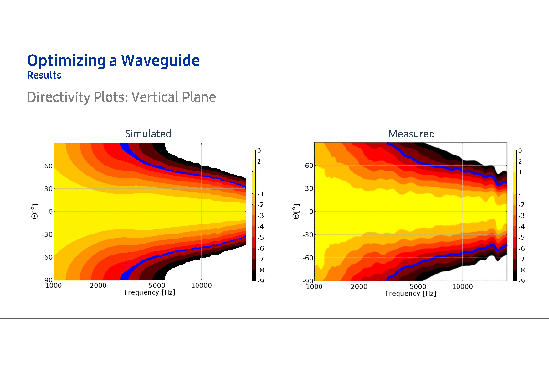

Years ago, WHGeiger proposed to use Bezier Curves to design waveguides, which wasn't greeted with great enthusiasm.
It looks like somebody stole his idea.
This basically shows how the M2 waveguide was designed, even though it looks different.
Bezier curves are just a mathematical means (one of many) of how to construct curves of arbitrary and smooth enough shapes. There's nothing special about them regarding horns whatsoever. They are convenient and easy to work with - that's the reason they are often used for various occasions when you need to get smoothly from one point to another with something else than a straight line. It's an obvious choice if one wants to optimize some shape by chaging the countour in easily defined way - a Bezier cubic is really the most simple solution one could come up with. Not "optimal" in any global sense however. It's just a shape, one of many possible, limited by its own constraints.

1) If you want to optimize driver loading at low frequencies use a Salmon horn with 0<=T<1 and annul driver reactance.
2) If not using room boundaries to extend the horn, increased mouth curvature is still required.
3) If you also want to mitigate beaming at higher frequencies, then introduce VIR acoustic lens into the wave front pathway.

Sorry, I don't follow. I've been using Bezier curves for decades, i.a. to generate a simulated air traffic, smoothly changing velocity vectors, etc. They are great for these tasks - extremely handy. For horns, why not, but let's not call it a "horn type" - it is not. You can get almost any shape with these curves, including OSWG or anything else 🙂
It starts to look somewhat familiar.
However, this waveguide is developed for professional cinema, instead of 'monitoring'.
Therefore it's optimized for mid- and far-field coverage.

There's is not a single 'perfect curve'. The best horns are often composed of a combination of these, ATH-4 being an example.
For this specific design process the Bezier is likely convenient.

" optimized for mid- and far-field coverage." by this I assume you mean by how wide the dispersion pattern is....
Indeed, those waveguides are wide coverage, similar to this Synthesis In-Wall loudspeaker (100 x 100 deg).
