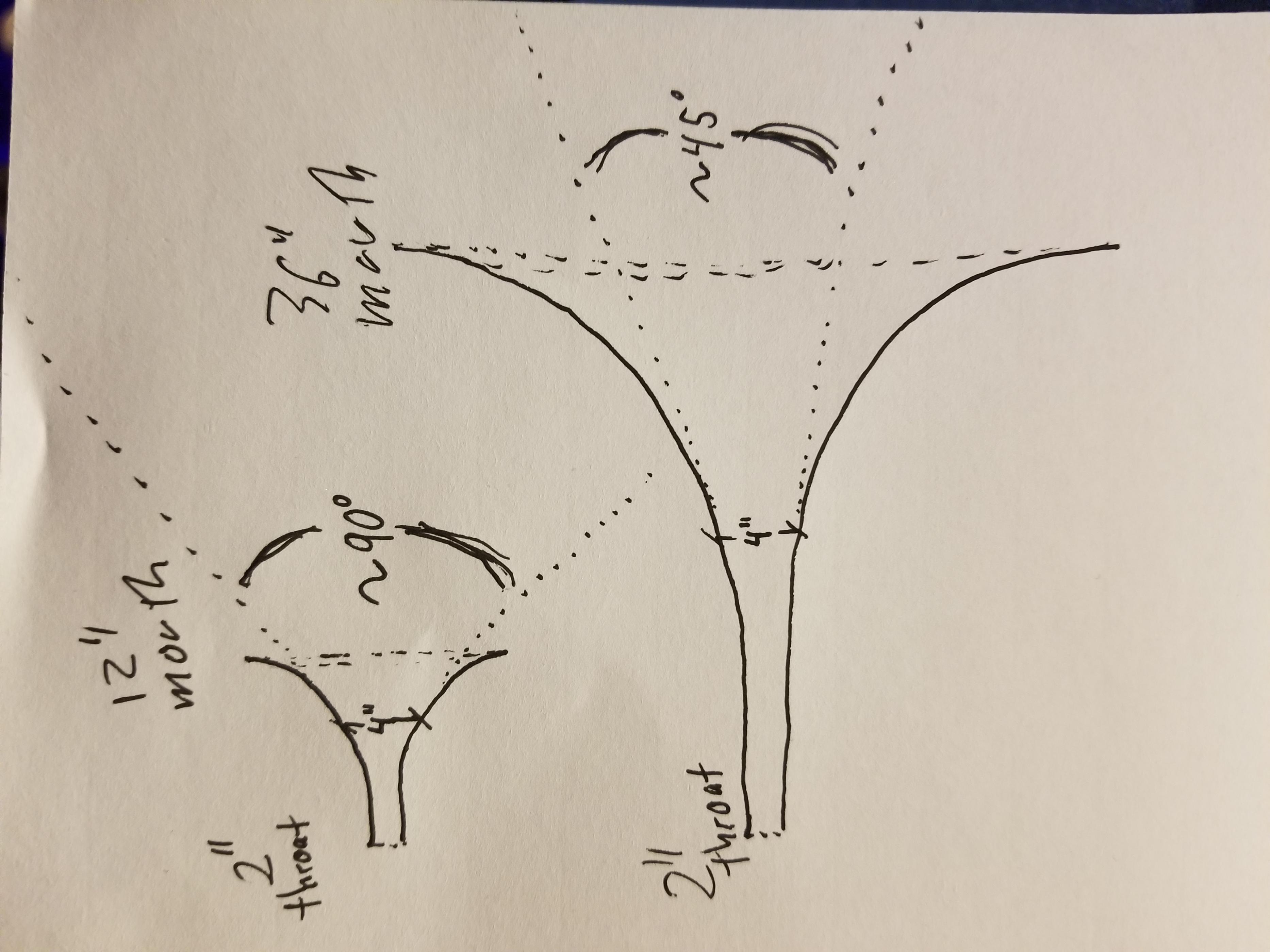

Camplo. Hopefully this very crude sketch can help visualize why larger horns (non constant directivity types) of the same throat size beam more at high frequencies than their smaller counterparts. My question is, can the radiation pattern of a given frequency really be approximated by looking at a corresponding diameter on the horn and measuring angle? Or is this really as I'm guessing just a crude way of understanding things? For instance, at the measured 4", for what frequency would the angle measurement approximate the angle at which spl would begin to fall off significantly? Just for fun I'm guessing 7k. Perhaps the approximation is useful for the throat but not so much towards the mouth? . I should play in hornresp I guess, but it's not handy at the moment.

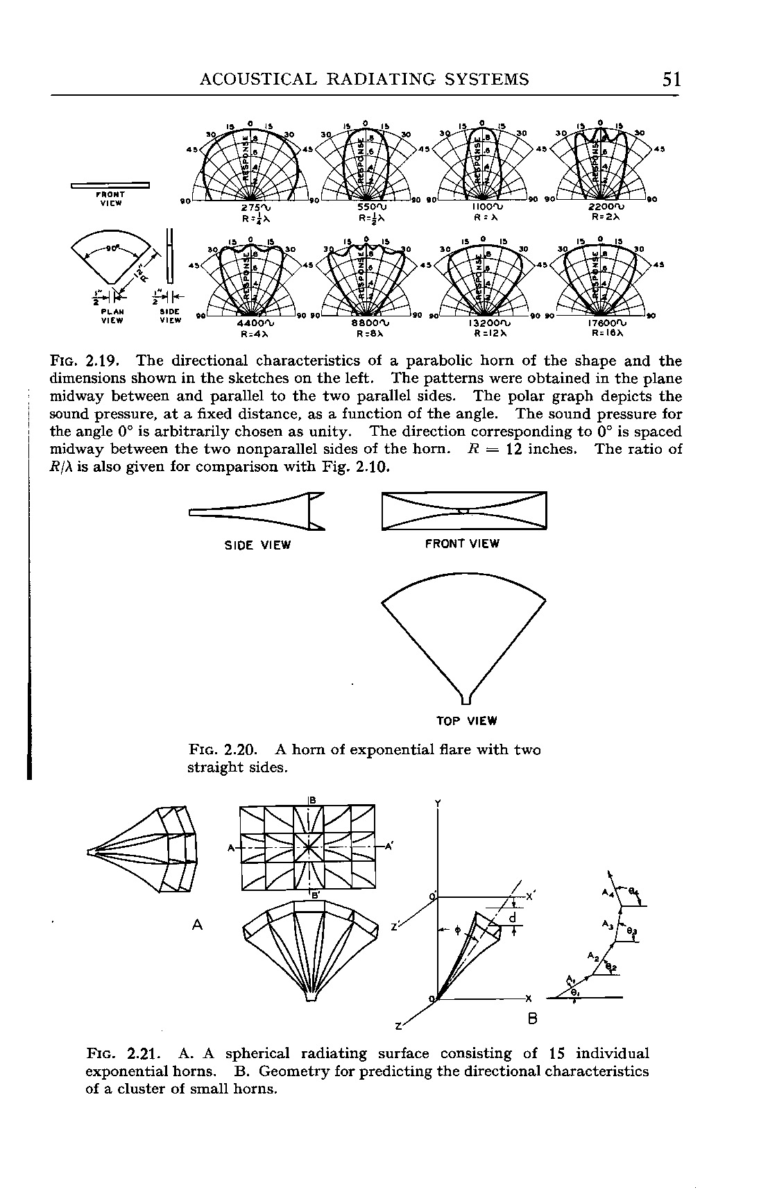

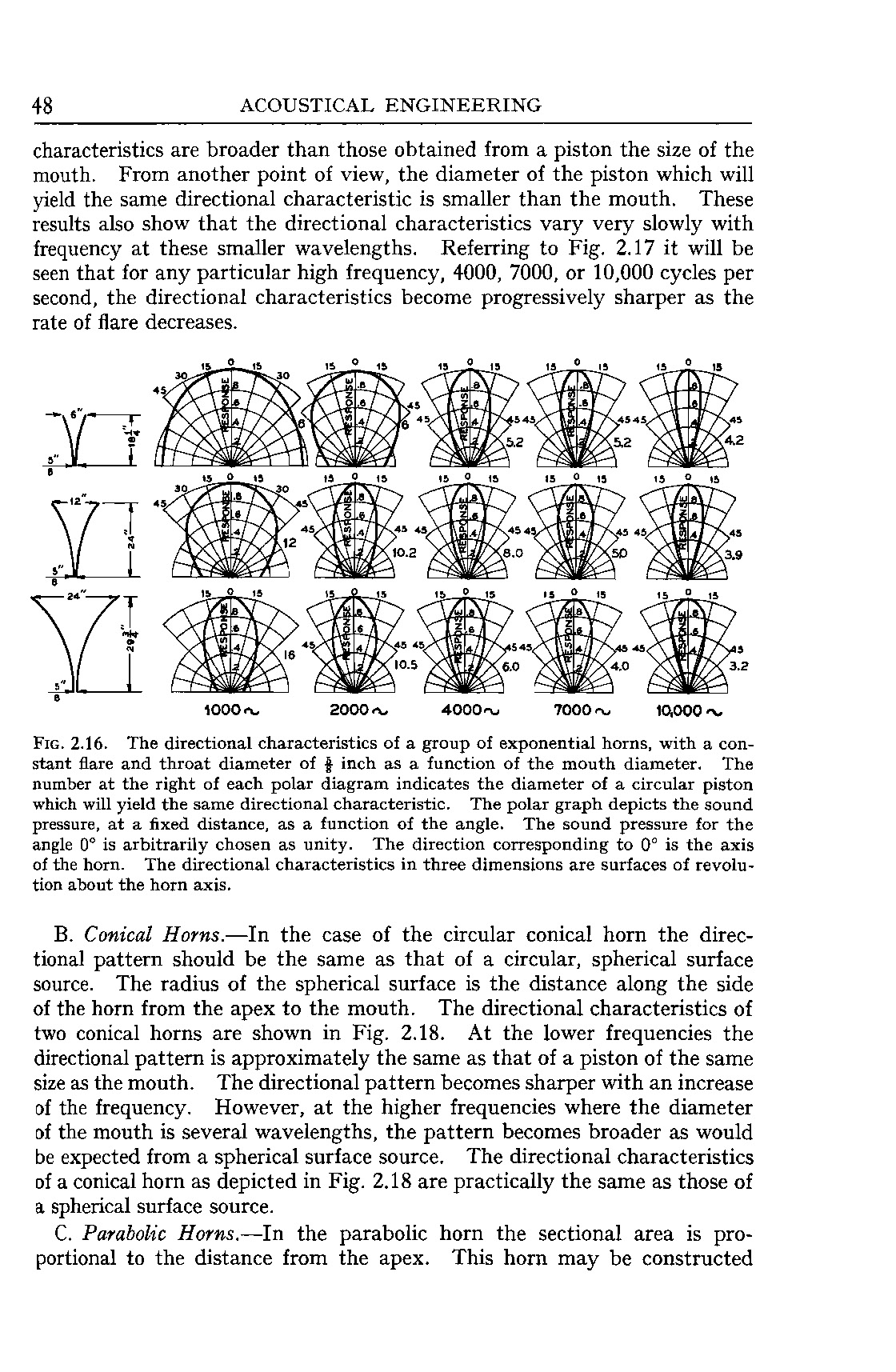

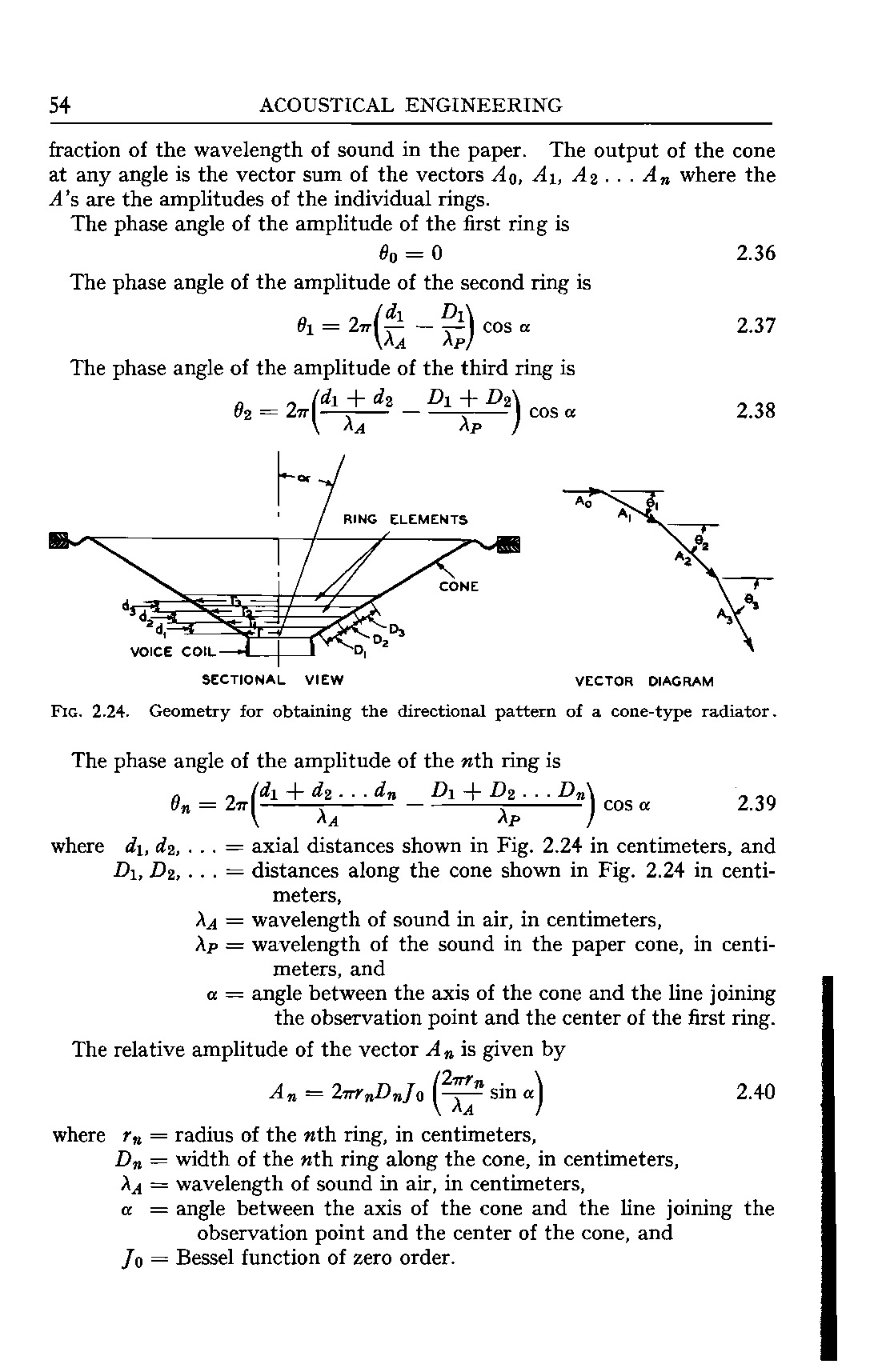

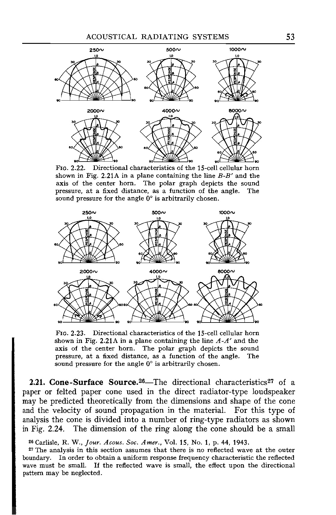

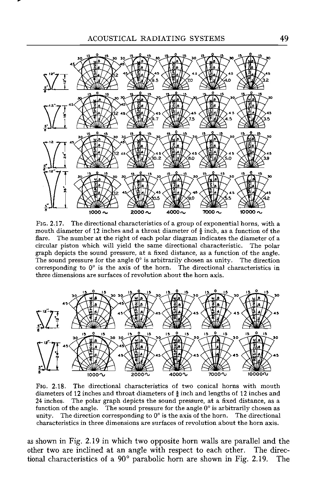

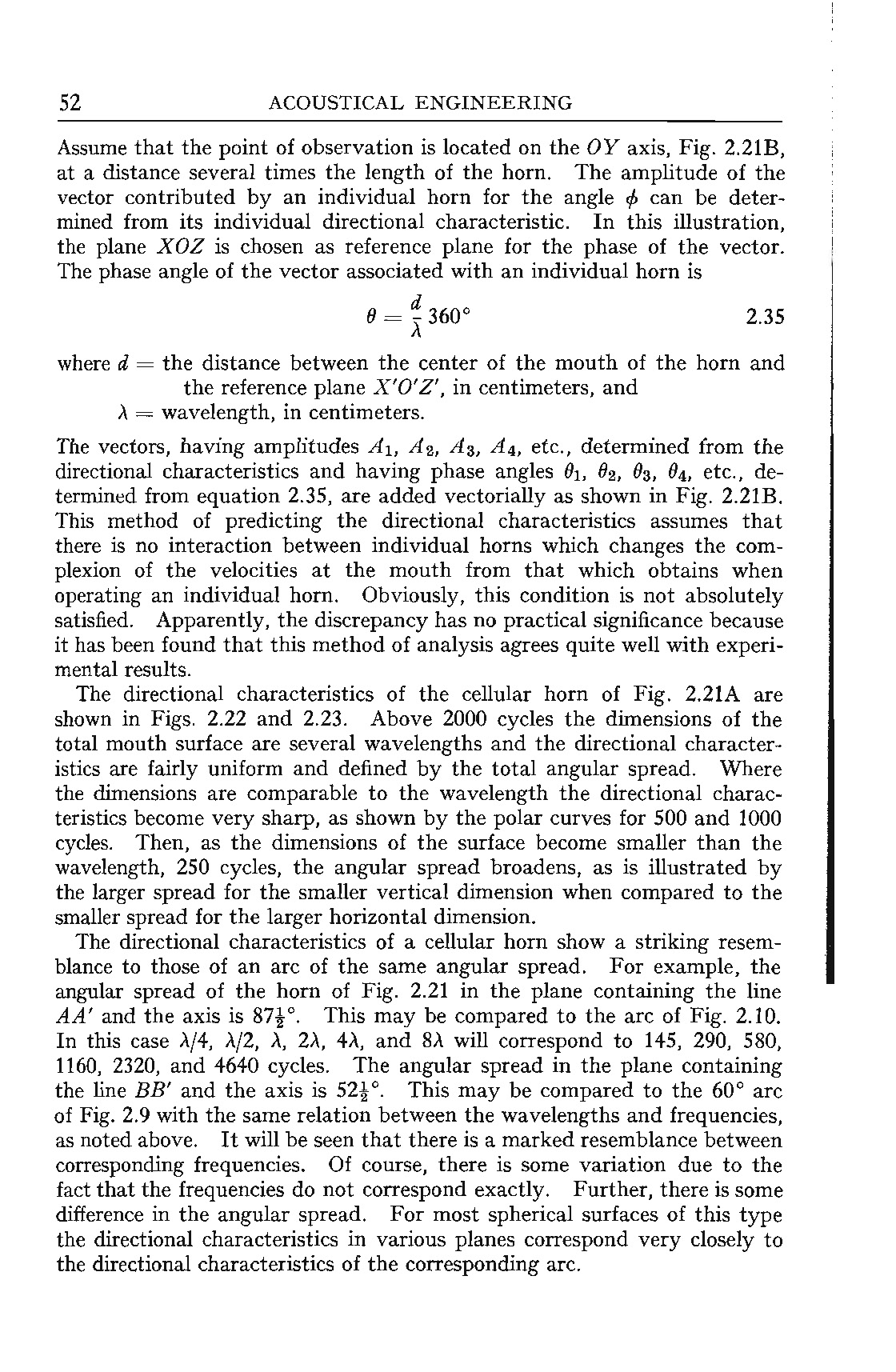

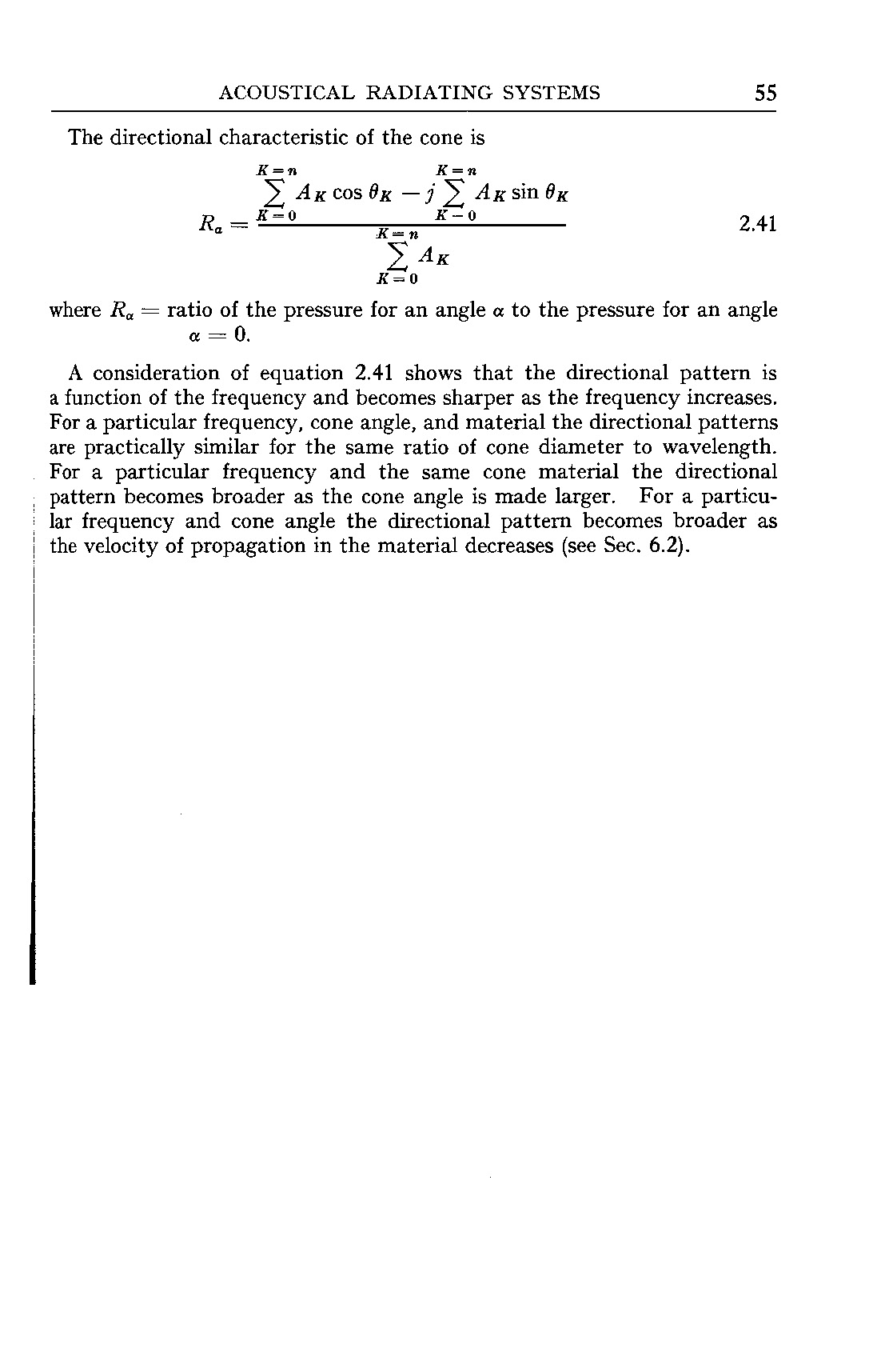

This might help.
