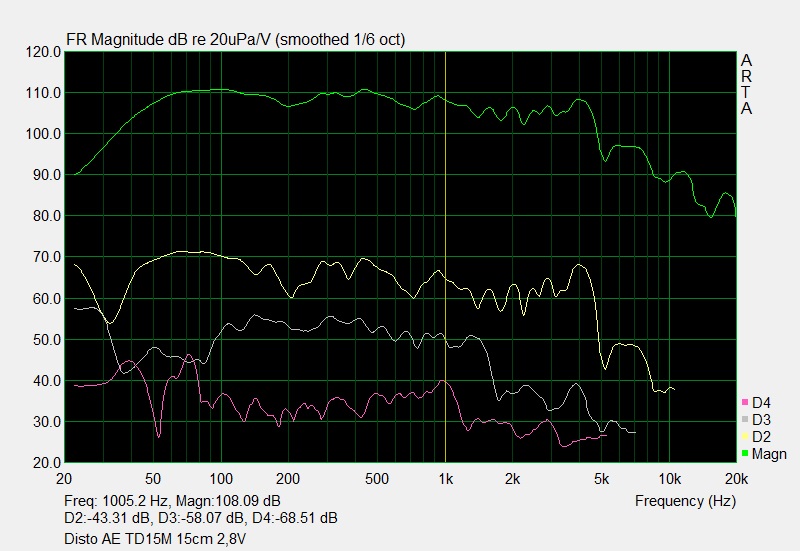

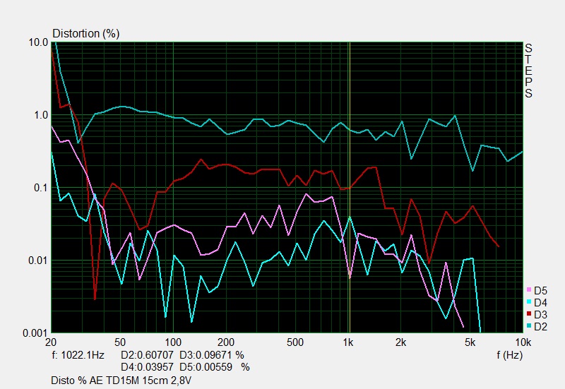

Found some measurements of the TD15M as well.
These were regarded as one of the best 15" woofers available and favorably compared to TAD drivers.

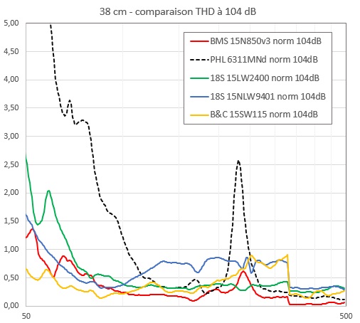

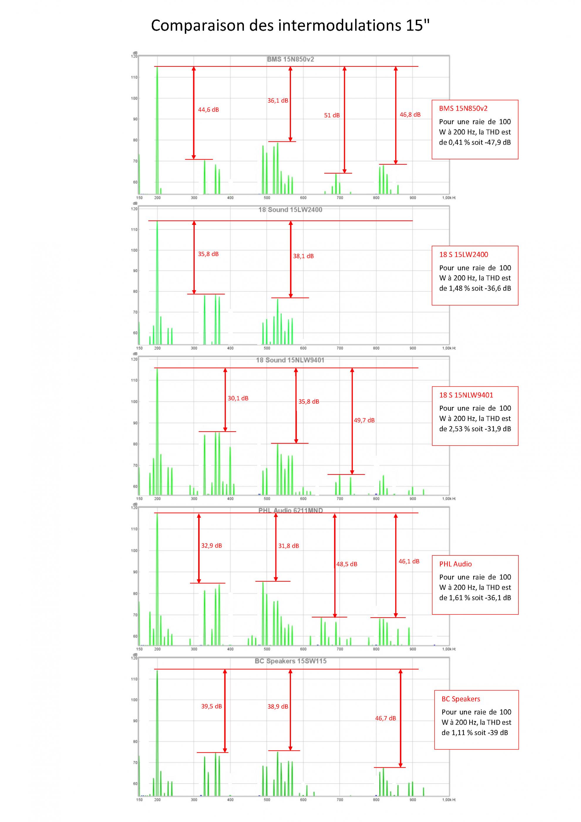

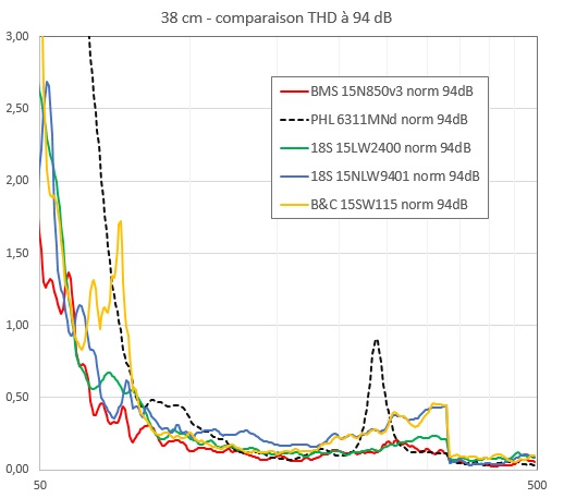

Measured THD and intermodulation distortion of five 15" woofers.
BMS triple rings shows its stuff. Nice and clean. Wonder how the differential drive motors(JBL, 18 Sound) do in IMD tests.
The 18 Sound AIC motor showed comparable or better IMD numbers than AE on the drivervault site. THD was average.
I believe the same French testers(member PVRX) chose the BMS 15N850, 18 Sound 8NM610, and Mundorf AMT for their 3-way proof of concept rig.
They also tested a whole bunch of compression drivers as well. 18 Sound came out on top but not nearly as good as the AMT's above 2k. IMD is the real downfall of compression drivers at high levels. Much less of an issue in home when using less than a watt most of the time.
The BMS woofers are generally very good, along with many drivers from 18Sound, B&C, Beyma, FaitalPro JBL (Professional) etc.
We must bear in mind, however, that most of the top performers as regards to distortion figures have been designed for extremely high SPLs. It's tempting to be guided by these excellent measurement results when selecting drivers for a project. The question is whether the attractive properties make a big difference for the specific application.
Moreover, AE drivers are a special breed. Even though the drivers are occasionally used in PA environments, I don't think these are designed to compete with BMS, B&C etc.
Even if they were, the lead time would force the company out of the market almost instantly.

That goes for these too

Merci Ro808 for the measurements. I've not seen many comparisons like that.

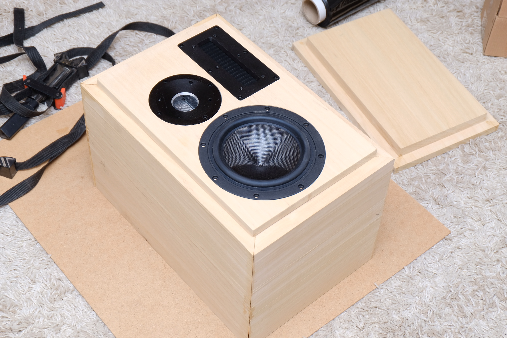

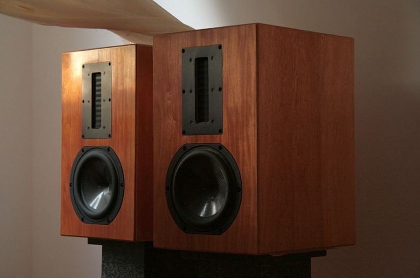

I very much like self made small mini monitors based on AMT and 6,5-7" with soft suspension, stiff membrane from: Home | Charisma Audio
The quote about compression drivers and IMD compared to what? AMT's?, Are we talking at matching spl levels? If not, How can you make such a quote? At 1 watt you might be talking 112db depending on which ever driver/horn.....I looked up the drivervault study but did not find any measurements of AMT's. Can I get you to post some measurements to illustrate your point or at least site you source of measurements. It really enriches the thread.

Are you suggesting that BMS and B&C are better drivers? I mean IMD performance is everything, not really but kinda sorta.
No
BMS and B&C are mass produced products, mostly designed to endure the rigours of PA environments, whereas AE is a small company that produces 'specialty' loudspeaker drivers.
Obviously, this doesn't imply (all) BMS and B&C drivers are less suited for domestic use, or that AE drivers are not suited for PA.
Which PA company makes an equivalent to the TD18H+ ?
In order to to avoid further misunderstanding: I think IMD and THD figures are only relevant to a certain extent.
The 18 SOUND 15W750 mentioned previously, may not show the best IMD and THD figures, but still better than "good enough".
