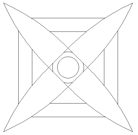

Your description reminds me of Funktion One's Axe-Head

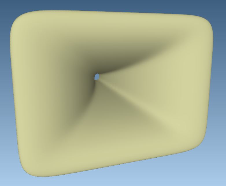

Nothing so elaborate, unfortunately :D. I find this superior to starting with a round opening, where there is no pre-existing throat, ie a cone driver without a JBL style phase plug, subject to the right circumstances.
Administrator
Joined 2004
I guess maybe better to say along the outside.
Yes, seems so according to the sims ro808 just posted. :up: I remember the aiming line.

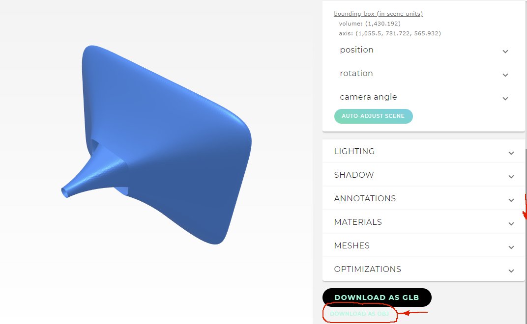

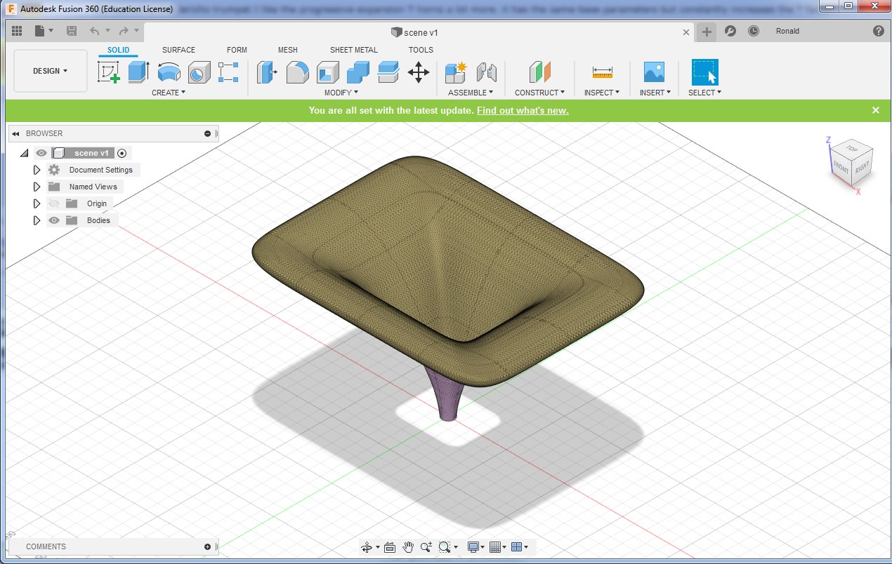

I tried loading these into fusion360 and it doesn't recognize the file type.
So I have no idea how to tell (yet) the actual size of these horns.
It seems several people prefer the squarish horns over round...Why?
My bottom line, regardless of T factor, is a horn that will be proper for 200hz production.
If you load the model into that webpage I posted earlier: Creators 3D
attachment.php
To the right of that browser screen there is a barely visible green line saying: Download as OBJ
That will save it in OBJ format and is readable with Fusion:
attachment.php
Maybe docali can save in other formats as well, but this is a quick work-around.
This still leaves you with a model build up with faces (surface model) that needs to be converted to a solid body. I see docali has made some adjustments as it is almost a full closed model already with an outer back shell present this time around. With some patch work you should be able to convert it into a full solid. Pretty sure Youtube will have Tutorials on how to do that in Fusion 360.
A question though, did we start with a good match between the Axi and this horn? Do the angles (exit/entrance) match?

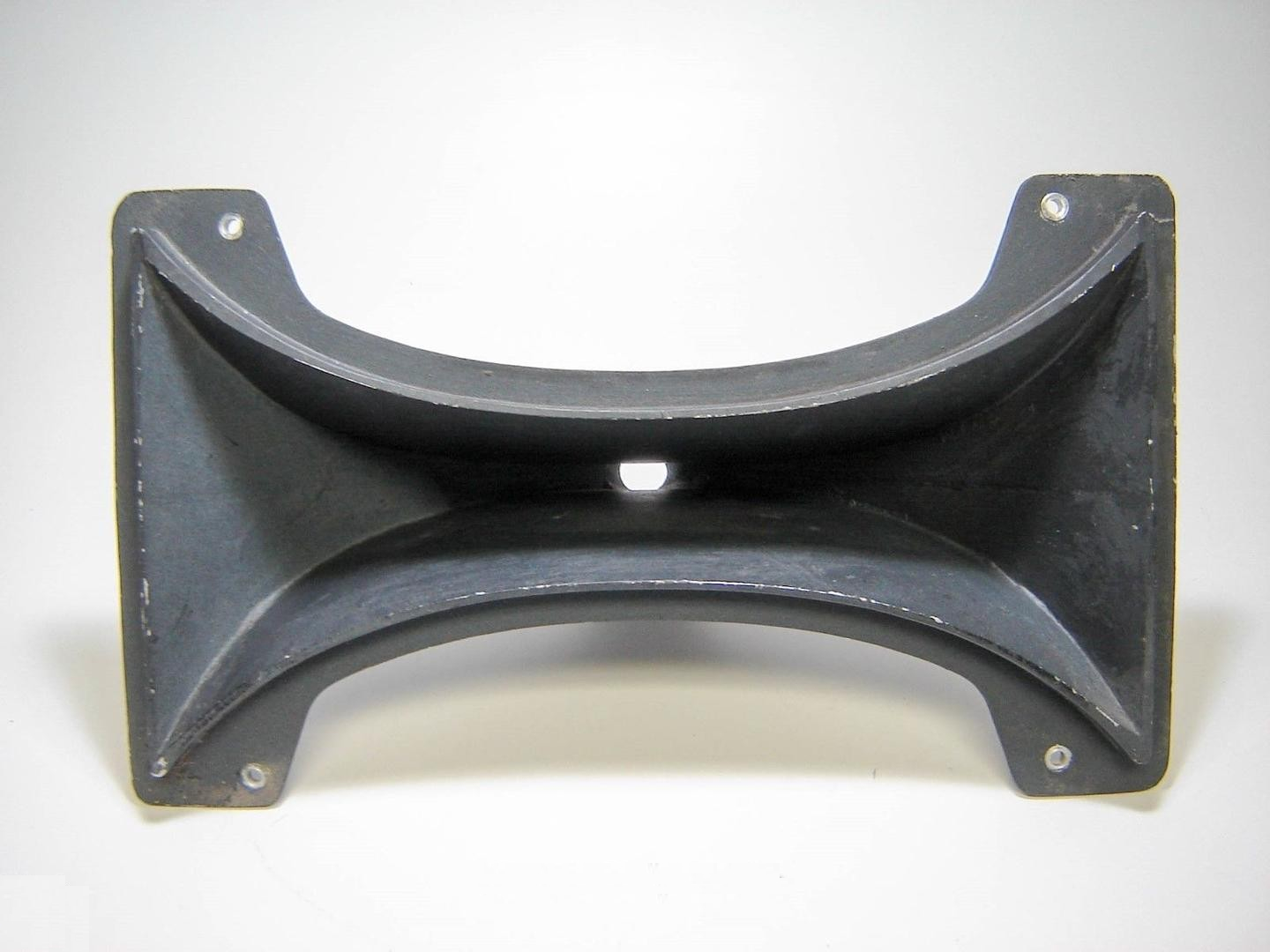

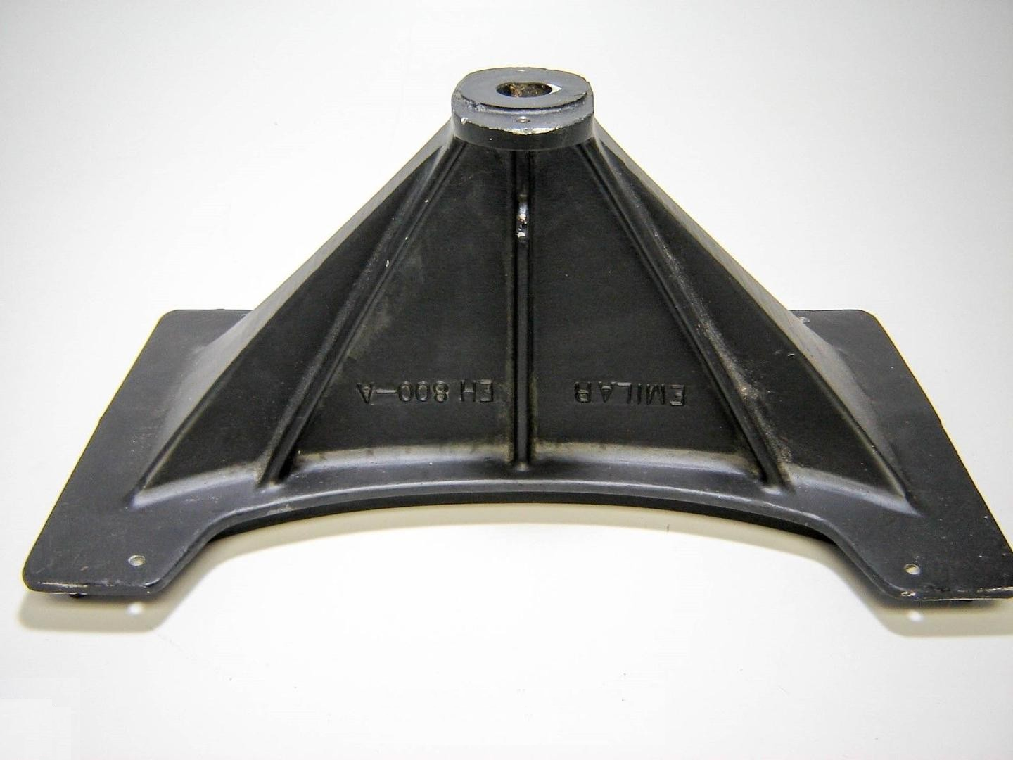

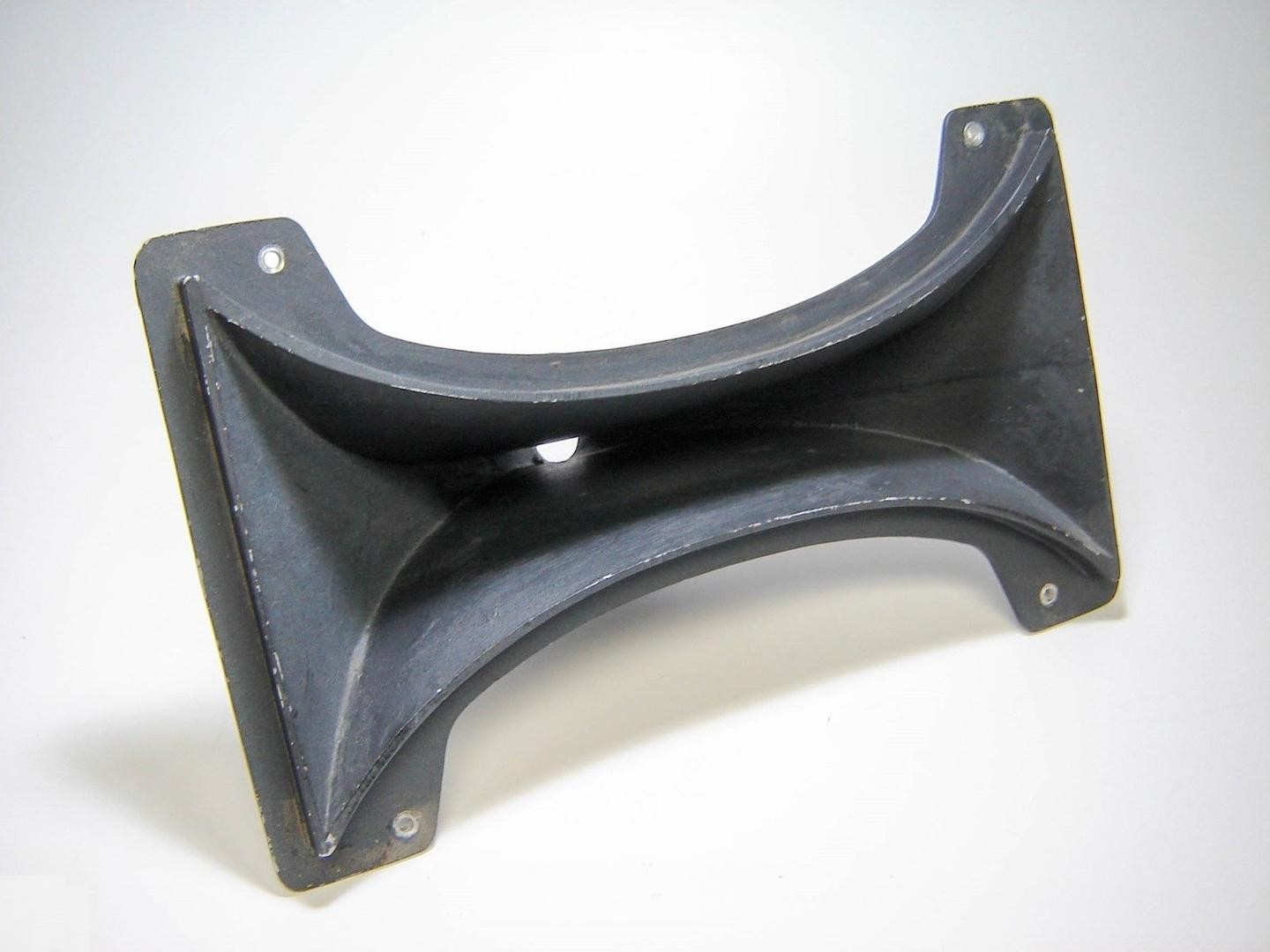

The function of the knuckles/bulges in JBL Image Control Waveguides is somewhat similar to the Klipsch mumps.
This classic horn is another (extreme) example, except for the 'cut off lips'.
Not surprisingly, this horn was nicknamed "Bowtie".

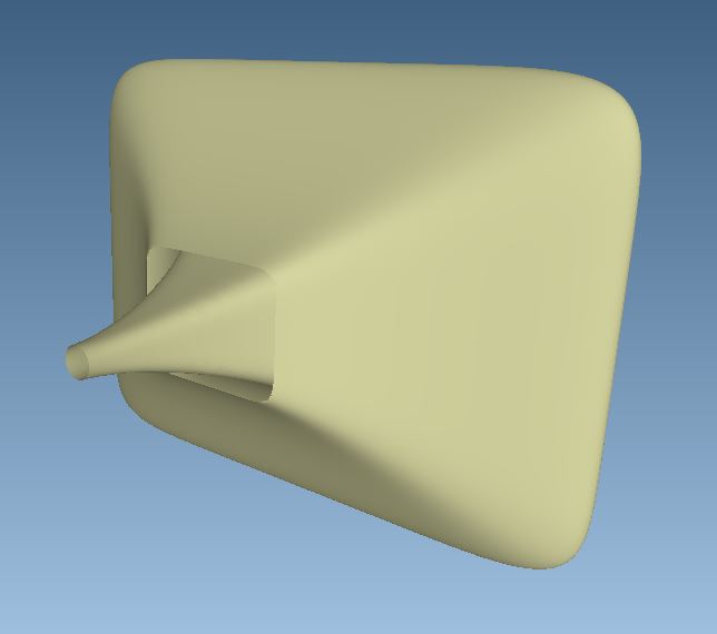

I am trying to digest what you've said. I am not really interested in the sato horns it was just kind of a side thought. The horns that you see Docali modeling are up for discussion. So the model he made called "Jericho" are of my inspiration, having longer throat length to assist in deep loading is my interest. I think Docali is being my devils advocate to make sure I'm not inducing unnecessary beaming by choosing a longer horn than is needed to accomplish 200hz production.
I'm making sure that the effort from everyone involved is actually actualized, by studying 3d printers as I prepare to purchase one with the conclusion that it is the tool needed. 3d printing is a deep solution. Meaning I may never print a horn or horn mold....I may end up printing a mechanical device that I use to make the horn some other way.
It wants to be solid as well.
Invention bred from necessity. I'm brain storming in front you, If you got ideas, I'm all ears! lol.
I could print a two part mold and fill it with concrete. Or just fill the shell with concrete instead of sand. I thought the sand was a better idea in light of the dual walled, sand filled enclosure. Maybe there is a doubt that between the adherence of the printed parts and layers of epoxy, solidarity will be achieved. Ok someone mention the fiberglass products. What about that? Maybe I can pour fiberglass resin into the shell? Maybe mix it with sand, or mix mortar sand and fiberglass resin, and do the outsides in epoxy resin.
OK never mind the fiberglass resin which is really polyester resin which the hardener is pretty dangerous stuff....I second GM's motion for concrete.
I don't want to go through all this work and end up with just another white thin horn. Not to say that they aren't acceptable I just feel like I can do better somehow.
