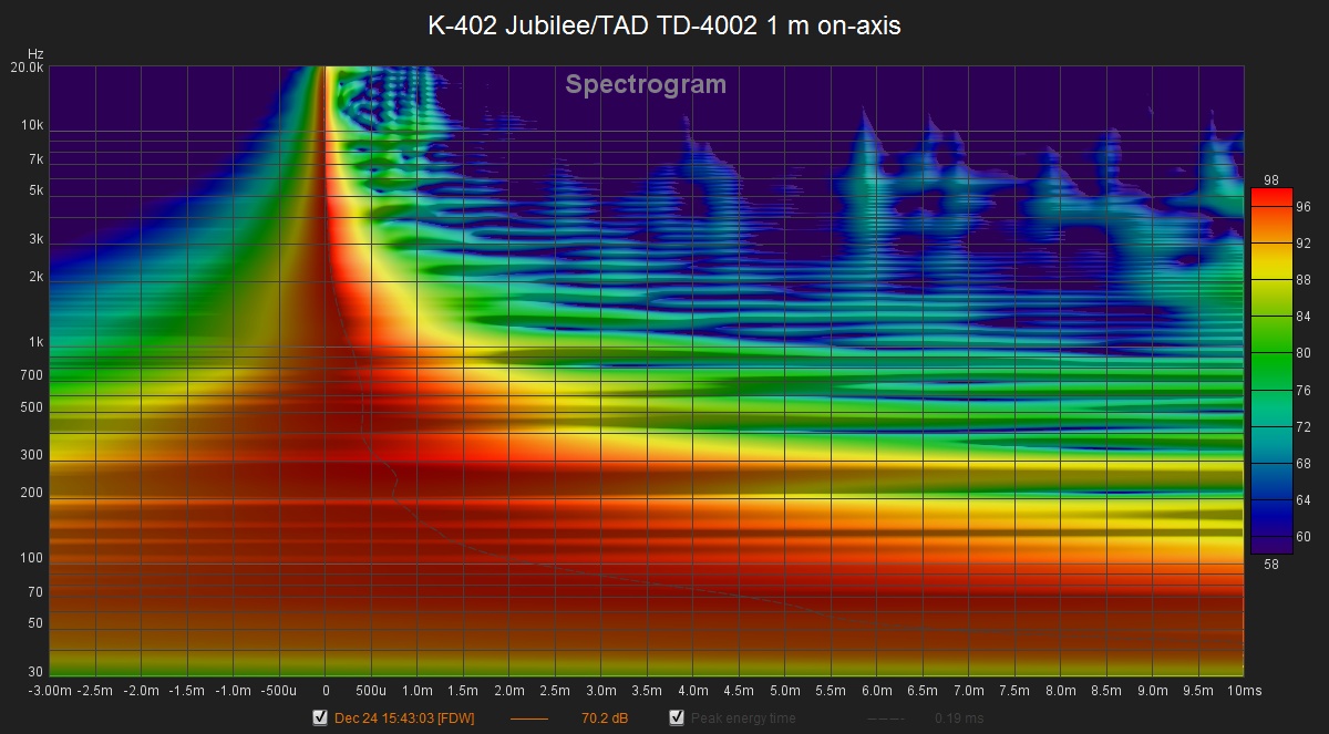

These measurements show some interesting results from these different types of horns that would seem quite valid to this discussion. If anything, you'd want to have a horn that shows one of the cleanest pulse results, or viewed in that paper as wavelets. At least I would want that if I were after a reference quality horn for studio work.
In my book that would point to a smooth driver - throat transition and a generous round-over at the mouth to get it. But there's always compromises to make, and I just wonder how far camplo is willing to go size wise to check all these boxes... At least i would think a generous roundover would make his round horn bigger than he'd like it to be?
A square, ellipse or rectangle horn would still have that energy after the pulse, but more smeared out (due to those different path lengths). So it could be one has to choose (as always) your set of compromises to get close to what you'd want.
Personally I'd pick a (slightly) higher crossover and get that generous roundover (for instance the already picked out JMLC horn), when looking for that reference quality but I can understand the quest camplo is on.
