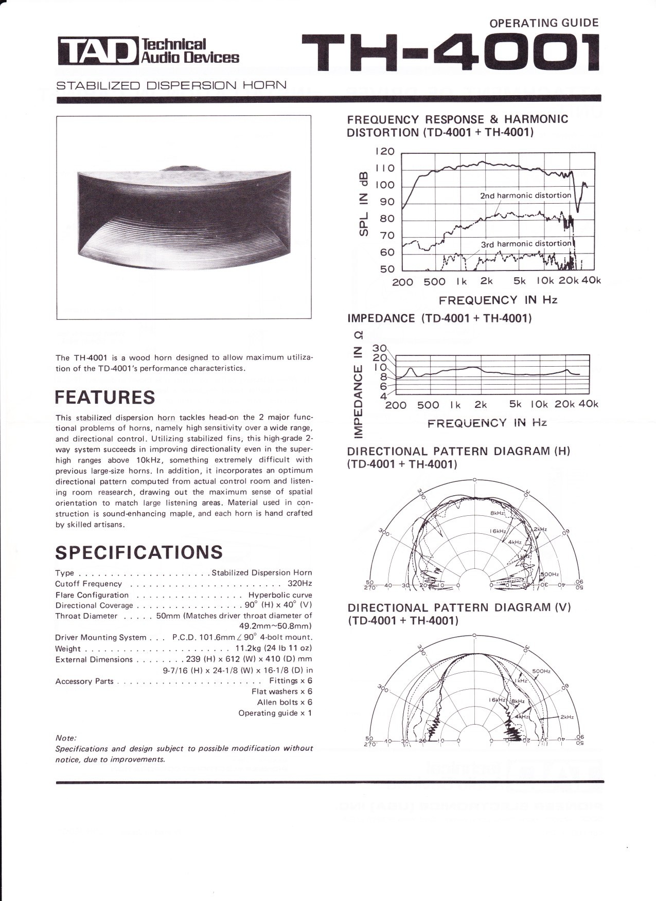

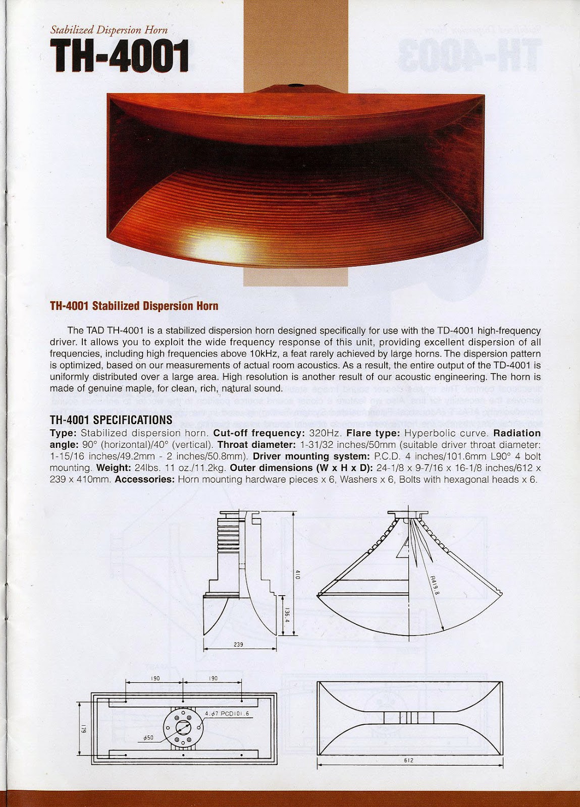

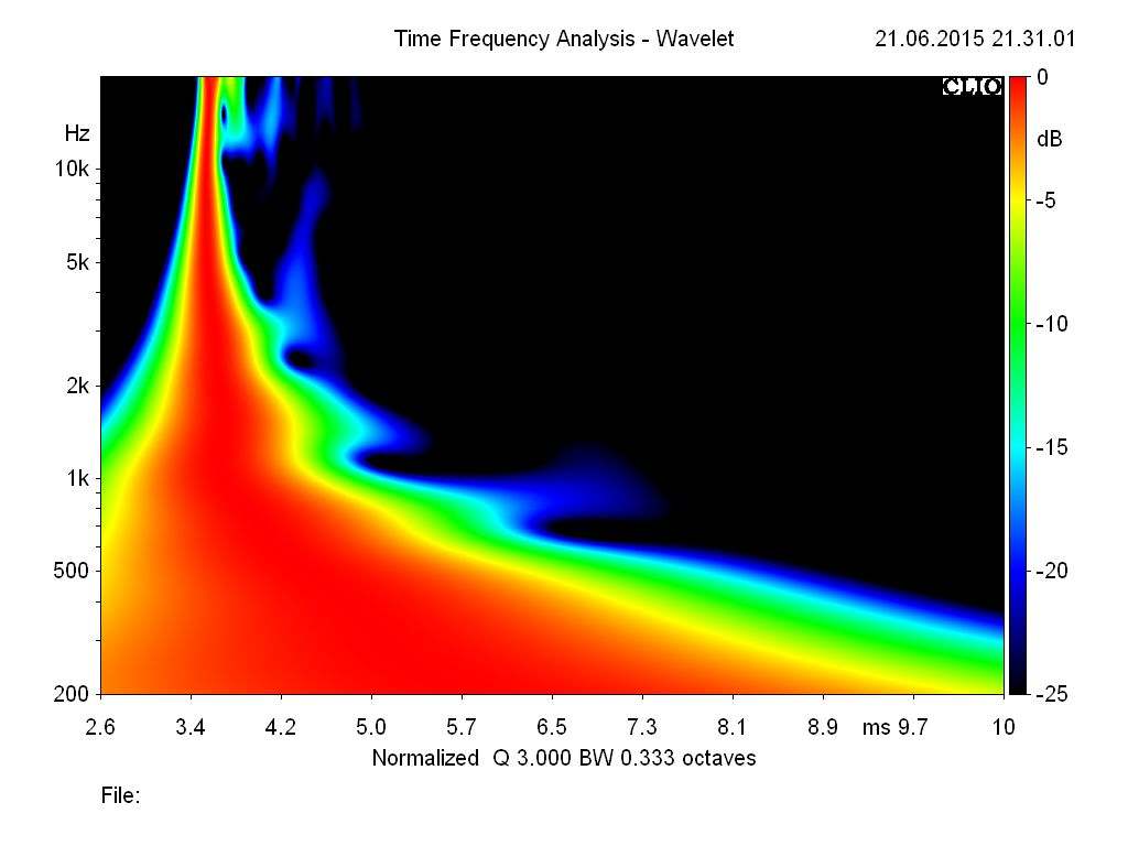

Attached: TAD TH4001 horn with 4001 driver.

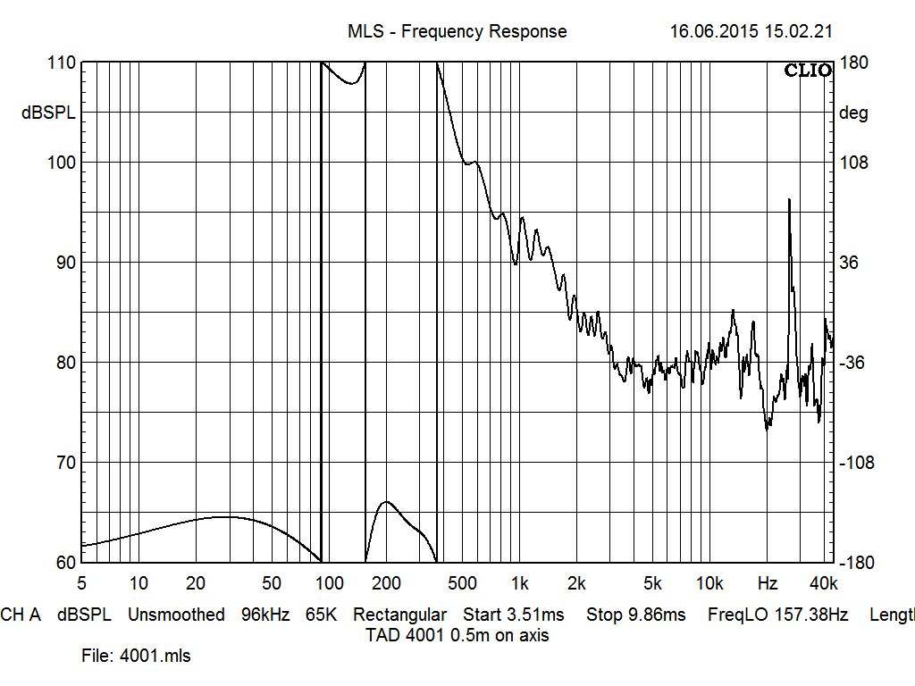

Fc is 290Hz.
The hyperbolic horn begins to "work" about 0.5 octave above Fc, i.e. 400Hz
In the frequency response plot, the frequency at which the horn loses its effectiveness is clearly visible - 3500 Hz.
400Hz plus three octaves is 3200Hz.
Fc is 290Hz.
The Fc of the TH4001 specified per TAD is 320Hz, but according to TAD afficionados the actual Fc is closer to 270Hz.
The Arai 290A is a clone of the 4001 and I think it is safe to refer to Fc=290Hz for the TAD 4001 as well.
But it is not usable @this frequency.
The 4001 has at least -3dB at that point and the horn add -XXdB

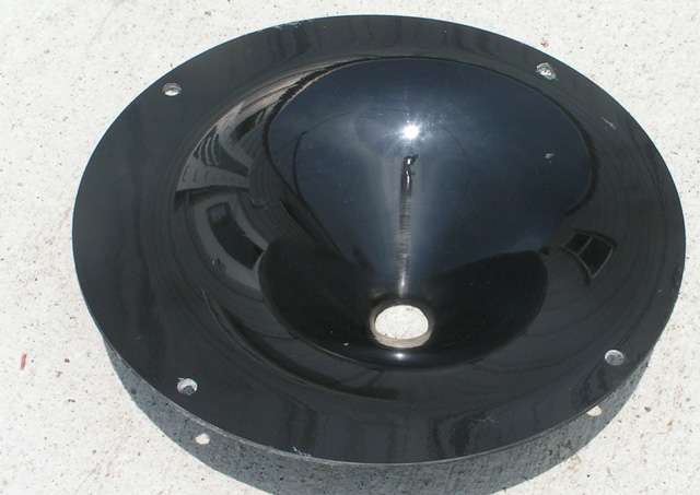

To my knowledge there are very few - if any - mass produced "true" OS horns available on the market.
EAW used OS-like round horns for the LA-series, QSC produced the SP-000106-GP, JBL appears to have produced a limited amount of round OS-horns for custom install loudspeakers.
I've also come across OS-like waveguides from China and other Asian countries.
Finally, there's the DDS ENG 1-90 Pro, a copy of a round horn that Mark Engebretson designed for RAMSA. Even though it looks similar, I am not convinced it's a "true" OSWG.
The DDS ENG 1-90 Pro was measured by Joseph Crowe and the plots were posted here.
The results are quite miserable to be honest, which I largely attribute to the mismatch between the waveguide and the TAD TD-2001's deep throat section (aka its "snout"), as well as the WG's moderate size.
The person who built this system obviously wasn't aware of these subtle, albeit important details.
Joseph, it would be interesting to see measurements of the ENG 1-90 Pro with the RCF ND350 and/or the (modified) B&C DE400Tn. At least some improvements are to be expected.
By far the best performing OSWGs are the ones in Geddes' Summa/NS-15 and those designed by mabat.
This is not what i recall about this combo, number i remember are an octave higher.
The one i've seen/ heard ( including clone) were crossed from 480hz ( Kinoshita's own evolution of the design used in MTM in wall) up to 640 hz ( in Tad/ Pionneer exclusive way).
In practice 480hz is already pushing the limit to optimum wrt this horn/cd combo and need steep filters.
Fc is 320Hz according to TAD.
TN-3 interface network for bi-amping is specified for 600-800Hz.
Fc is the cut off frequency of the horn. The recommended crossover point for the driver + horn is usually at least one octave above Fc.
