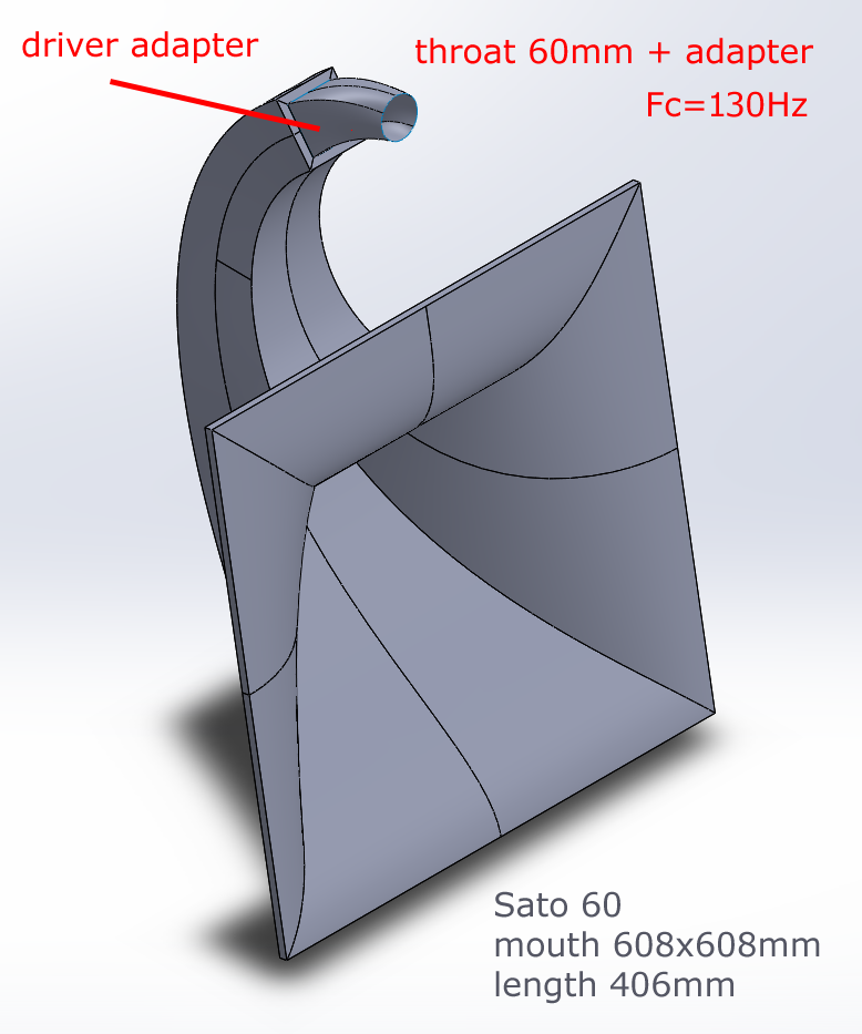

Is it possible to cover the whole spectrum, high spl, low distortion with a 2-way? -that horn has plenty of directivity control and it beams like crazy. A sacrifice I'll have to pay for what I want since there is no CD horns that exist, that plays down to 200hz first off all.
I am trying to find the best performing horn that correctly loads 200hz, has the best polar, and is within ~35" long and ~30"wide. I am quite surprised that the Jericho 45 is only 20" wide. I am interested to see an ellipse horn that has a length like the Jericho.

My main desire is to find the best horn that can allow me a 200hz xover, based off principle, so far the Jericho 45 is the first horn we've seen that can do so.
It shouldn't be too difficult to develop a Constant (Controlled, Uniform) Directivity (Coverage) horn that also provides acoustic loading <500Hz. The EV HR9040 can serve as an example.
Such a horn would be a hybrid, i.e. composed of (a smooth transition between) 2 or more sections each with a different contour.
The entire compound of these sections could approximate a spherical, hyperbolic, tractrix, or similar horn flare.
By increasing the mouth height (compared to the HR9040) the directivity in the vertical plane could be improved.
Such a horn would require 3D printing or CNC.

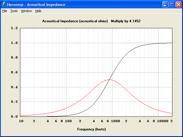

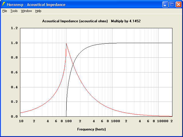

A conical (straight walled) horn won't provide much loading below 1000Hz, even if it's infinitely long.
Illustrated by David McBean:
A conical horn does not have a specific theoretical cutoff frequency.
The normalised throat acoustical impedance of an 'infinite' exponential horn having a cutoff frequency of 100 hertz. Notice how the resistance (black trace) falls abruptly to zero at 100 hertz:
The normalised throat acoustical impedance of an equivalent 'infinite' conical horn. In this case there is no sharp reduction (or cutoff) in resistance at a particular frequency:
