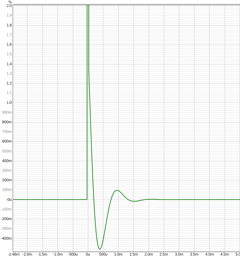

At YouTube Mr Toole says that if one eq a resonance peak in a loudspeaker, the resonance is gone. Is this really true?
If the speaker indeed "ring" (resonate) at a certain frequency and with a certain Q, lowering the input level for the particular frequency just makes the ringing level be equal to the non-ringing level. I would argue that there is still a ringing there with different Q properties and phase properties than the surrounding non-ringing frequency spectrum. Isn't so that where there is a high Q sharp peak in the FR (and seen in the impedance trace as well!!), the speaker is not minimum phase any longer in that region?
It is true. The ringing will be gone - it must be if the device is minimum phase (which is almost a rule for a transducer). The ringing is the bump you see on a frequency response plot. This is one and the same thing. You won't see any associated ringing anymore in the impulse response if you EQ the FR with a minimum phase filter (!) - just any "ordinary" IIR filter will do.
Q=1 doesn't ring very long since it's reasonably well damped, but it definitely does ring. Here's the impulse response of the filter you specified (1kHz, +1dB, Q=1):

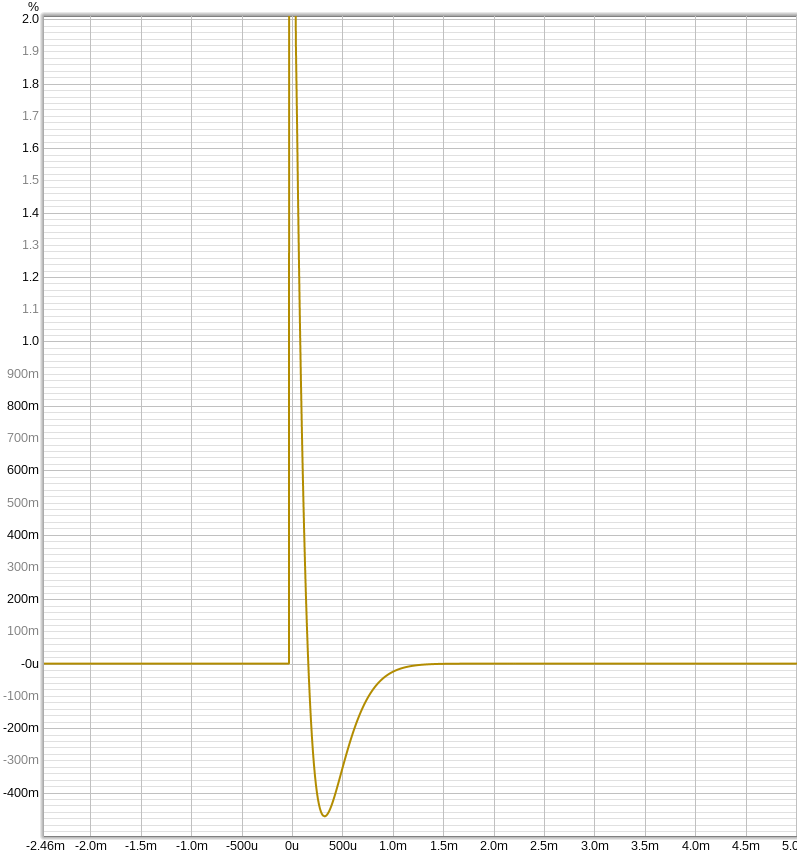

Joined 2004
OK, and if you make that bump Q=0,5?
Still ringing?
No, that wouldn't be called ringing as far as I know (it's called critically damped), but the principle is still exactly the same - you always correct for both, the frequency domain and the time domain, in minimum phase systems. Correct one and you can be sure you have corrected the other one as well.
That's why the resonances in transducers, if not extremely uncivilized, are not so huge problem - they can be corrected/equalized altogether in electronics (including crossovers, where it is done very often). A break-up of a diaphragm is a problem.
