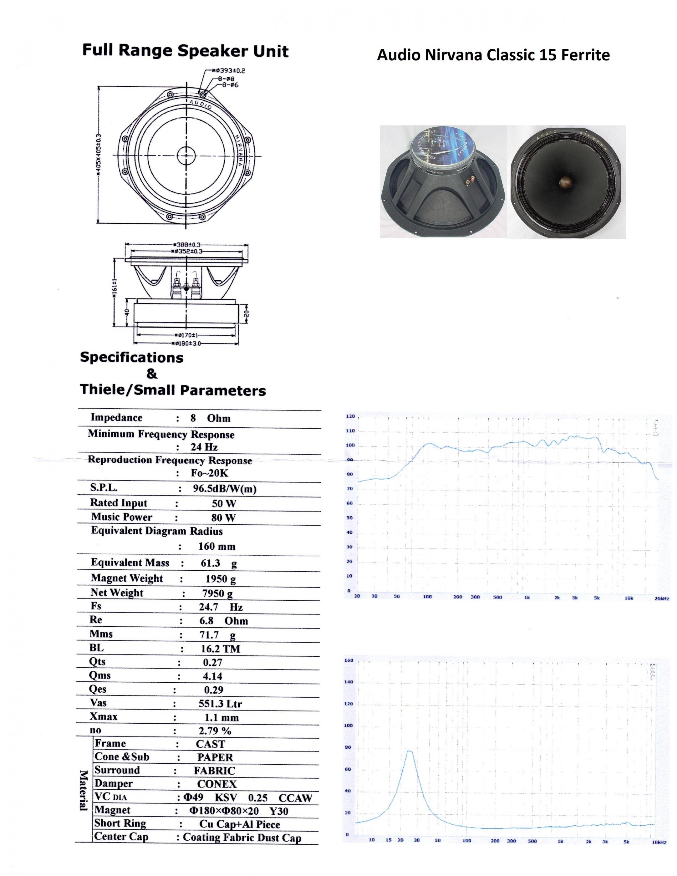

The Audio Nirvana "Classic" 15 for the bottom, an Aurum Cantus G3 for the top end.
Although the big 15 has some 5-10 Db on the big Aurum ribbon, I was thinking of running the AN full-range & the ribbon cut-off at 2500, the summation of the two SPL curves just might work...& the phase I'm guessing would "like" just being off 90 degrees just for the ribbon.
