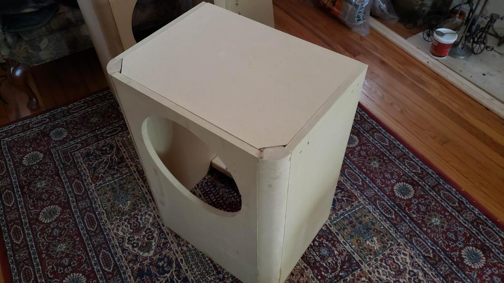

My driver baffle for the 15" is ~1.5" in depth and the wal's are 3/4"....whats the biggest radius I should use? I planned on purchasing a 1" radius tool for the router.
There are 2" 1/4 rounds that nest 3/4 panels. They work very well.

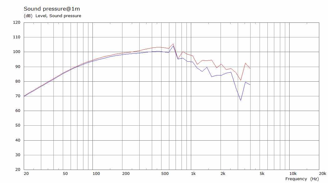

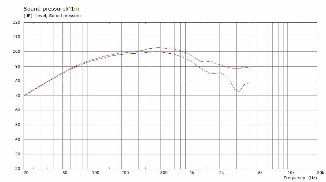

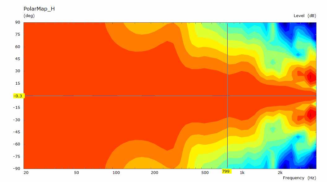

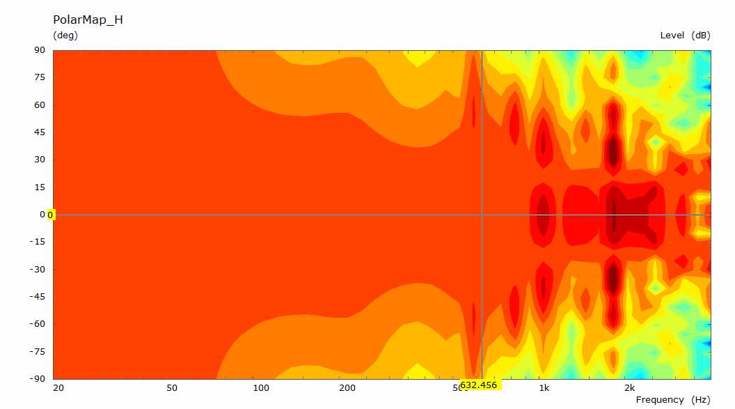

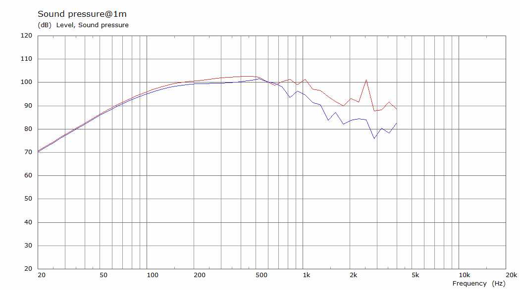

If you are trying to work out whether a roundover will affect diffraction lower in frequency then these simulations might help. They are of a 15" woofer in a baffle with a sharp edge vs one with a 36mm roundover.
As you see at around 500Hz the roundover starts to make a difference, below that no real difference.

fluid, I understand the ragged response around 700hz ... also upsetting the response a bit below due to the baffle width ... but I'm confused by the ragged response that continues above 1.1khz when the 15" should be beaming. Seems to me the ragged response should be confined in the range of baffle width (in wavelength) upward to piston diameter (in wavelength). Beyond that frequency, the wavelength shouldn't even "see" the baffle as much as that sim shows.
Is the sim not taking into account the pistonic nature of the source?

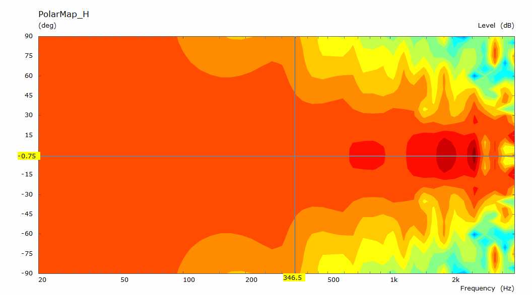

Yes it is, the polars are attached below, you can see the narrowing of directivity as frequency rises. Certainly as frequency rises the absolute accuracy of the model gets lower (due to the depth of the cone in this example). The only thing different between the two simulations if the baffle edge treatment.
I didn't make observation fields for these simulations but they would probably be useful for visualising what is happening at different frequencies.

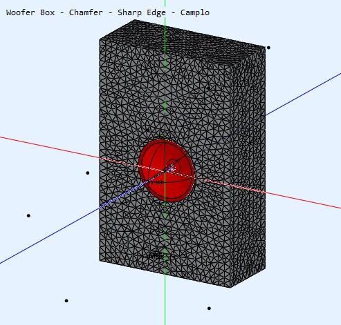

looks like an advanced software, how about simulation for a beveled edge vs the round over?
I would have to make a new CAD drawing for that, which I can do. The issue becomes making sure there is enough resolution in the mesh to accurately define the differences between a straight chamfer or a roundover or they end up looking quite similar when meshed.

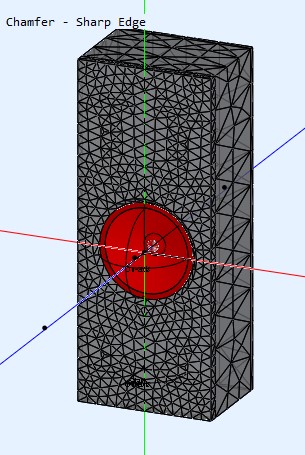

I ran some simulations on the mounting of the woofer in the baffle of the difference between flush, stepped, chamfer and roundover. There is a gif in the attachments which helps to see the difference. There is also an explanation of why the cone simulation accuracy drops off over 1K or so.
2 way waveguide speaker build ABEC modelling
Mounting the driver flush takes away from edge diffraction that potently?
It is practically impossible to mount a conventional large driver flush in the way that the simulation shows, so you would have to treat that as an idealised example. I have not seen a driver of that size where there isn't a lip on the outside. I was trying to simulate that lip with the step which is why it is 13mm, as it matches the driver I was trying to model. You can see the step wreaks havoc on the response so rear mounting the woofer with either a chamfer or roundover in front is a good way to get around it.

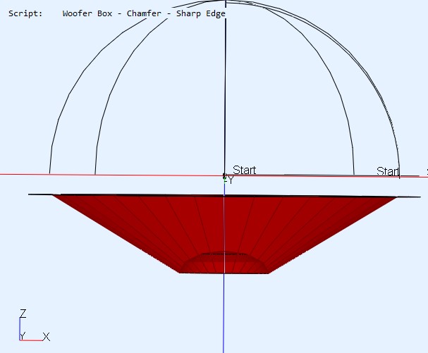

This is the side view of the Diaphragm as modelled, any sudden discontinuity at the surround junction creates quite a lot of diffraction.

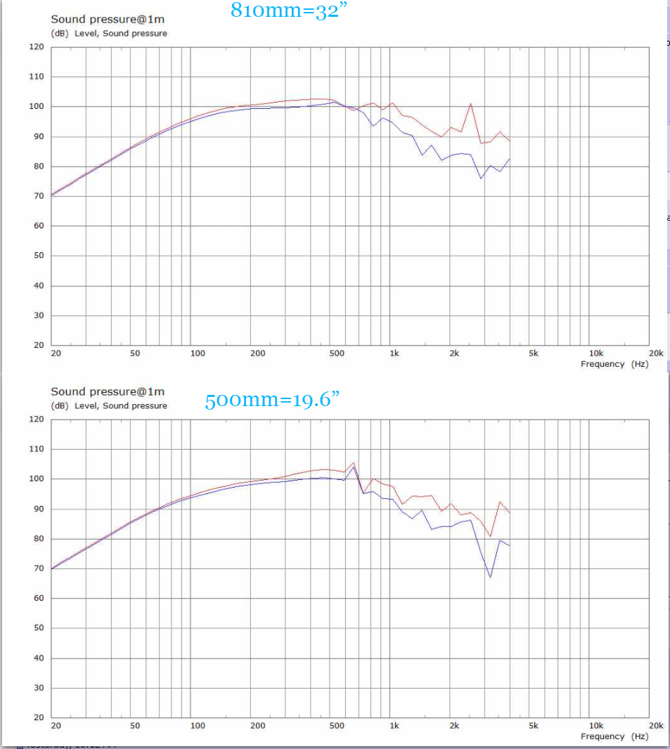

Here is a simulation for a sharp edged 810mm baffle close enough to your 32 inches. Took ten times longer to solve than the 500mm one 🙄
