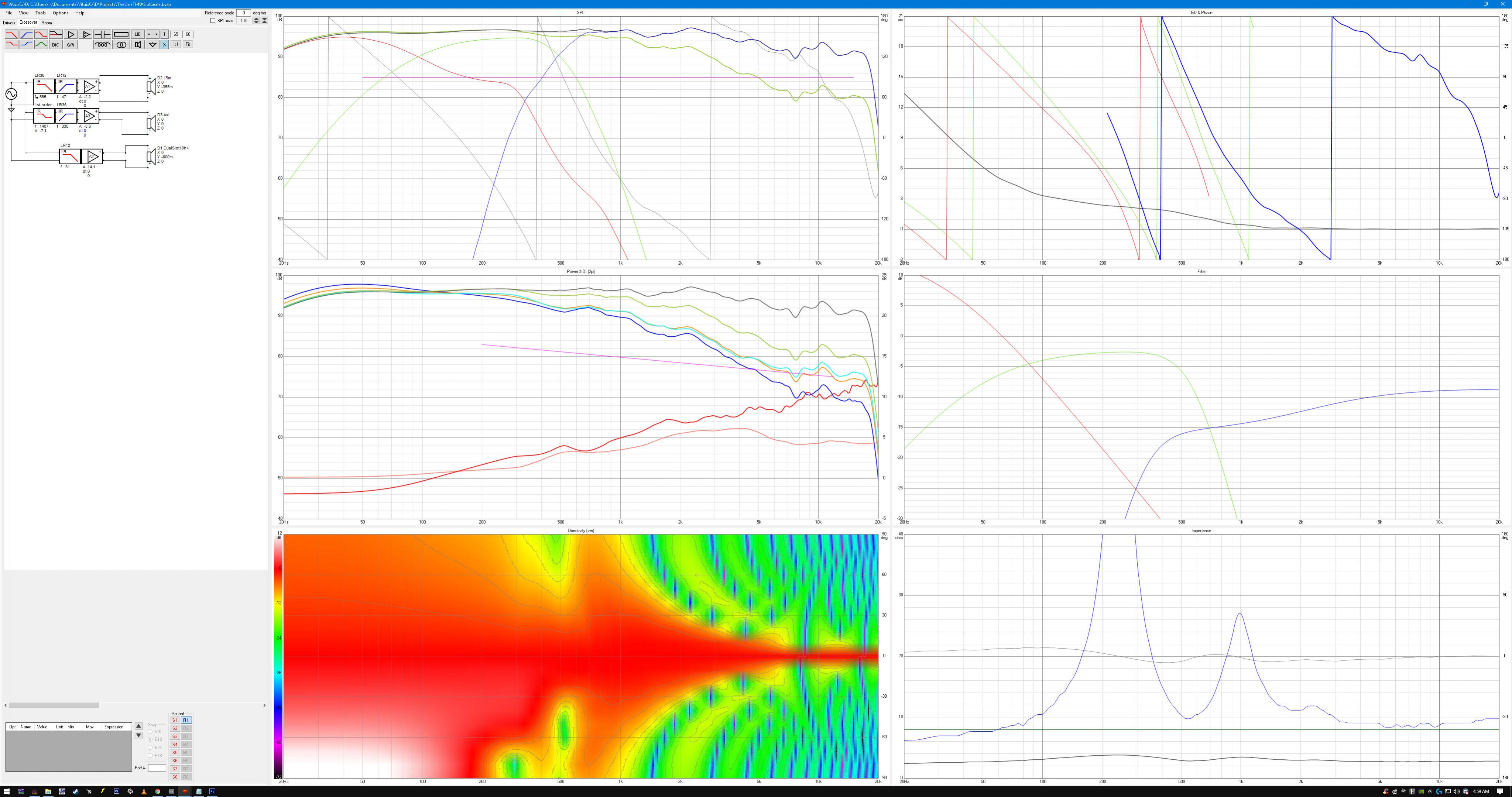

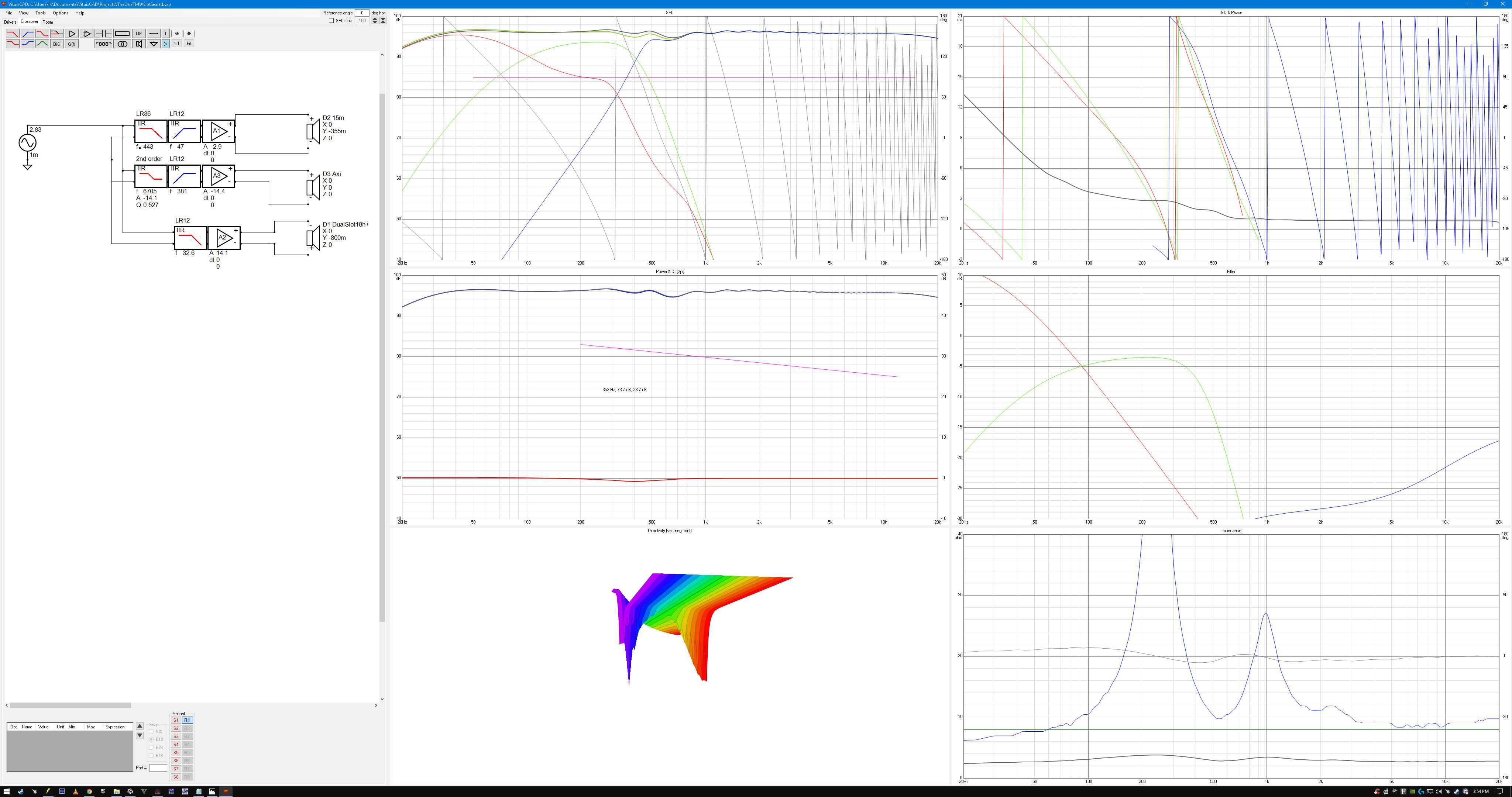

I really wanted to make two redundant large woofers work, under the tops...in order to keep the polar wide I seem to have landed in a position like Geddes describes. I also had a similar thought about ear sensitivity and where xovers are placed...It made sense to not break up the vocal range if possible and it made sense to have the compromises be below the Schroeder freq.....originally my xover goal was as low , like 200hz, if anyone remembers. 350hz is not bad tuning I have support from other wise hears that 350hz is the biggest I should entertain for a "top".... Larger horns, in my opinion, have to share some type of likening to a large transmission line, where as the resonate tail becomes longer and louder....I predict that with larger horns it becomes even more important to stay away from Fc.If you are going to compromise something do it here as it will have the least noticable effect.
I do have some with that data in it but its still inaccurate uptop...I didn't know how to exactly model a horn in the VCab
This is some horn I tried to model in Vcab combined with the response shown in the Celestion specs on a Seos 30....the 15m is crossed higher in this iteration.
That certainly looks more realistic but not ideal. Vituix can do a pretty good job of simulating directivity based on piston size and diffraction from the size and shape of the baffle. That should work well enough for the woofers.
Creating off-axis responses with VituixCAD Diffraction tool - YouTube
For the horn you would need a real measurement or a fairly detailed BEM simulation.
autotech publishes directivity for at least some of the SEOS family.
I was able to use Vituix SPL trace to tool to import SEOS 18 directivity into Vituix. Its difficult to trace perfectly near the axis where the adjacent angles sometimes overlay but persistence pays off and the result is still better than not having any directivity information in the sim
I don't follow that procedure exactly. Instead of using the response produced by the enclosure tool, I trace the on axis response from the data sheet using the trace too. This is closer to using a measurement. The differences between the data sheet SPL and enclosure tool SPL are either due to box size and easily equalized away or due to the real driver's characteristics - like cone breakup effects beyond cutoff, which do have a 2nd order effect on the system response.

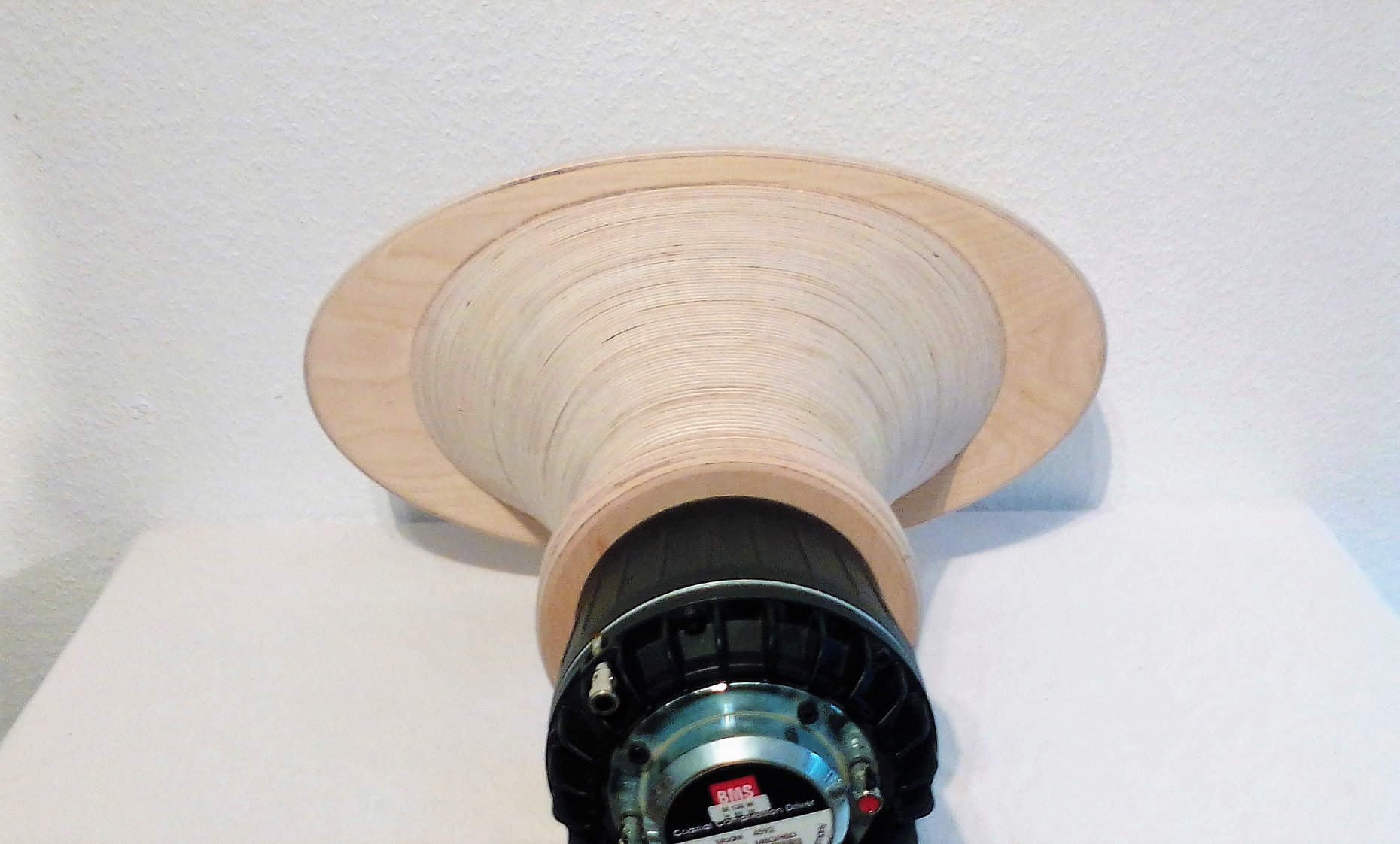

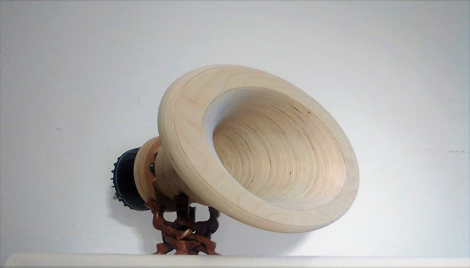

BMS and my Horn

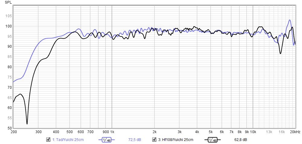

Measurements from the "Shadow of The Colossus" build thread

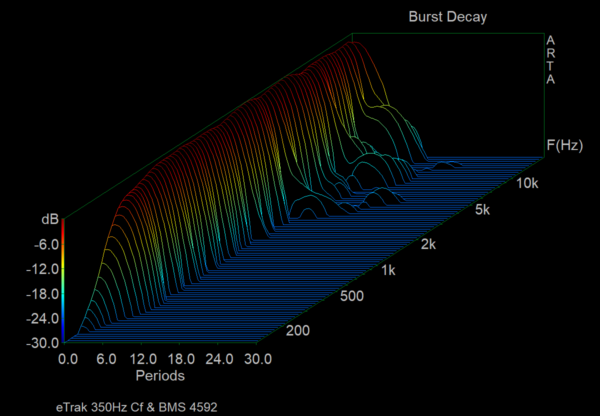

Spectral of my horn and BMS

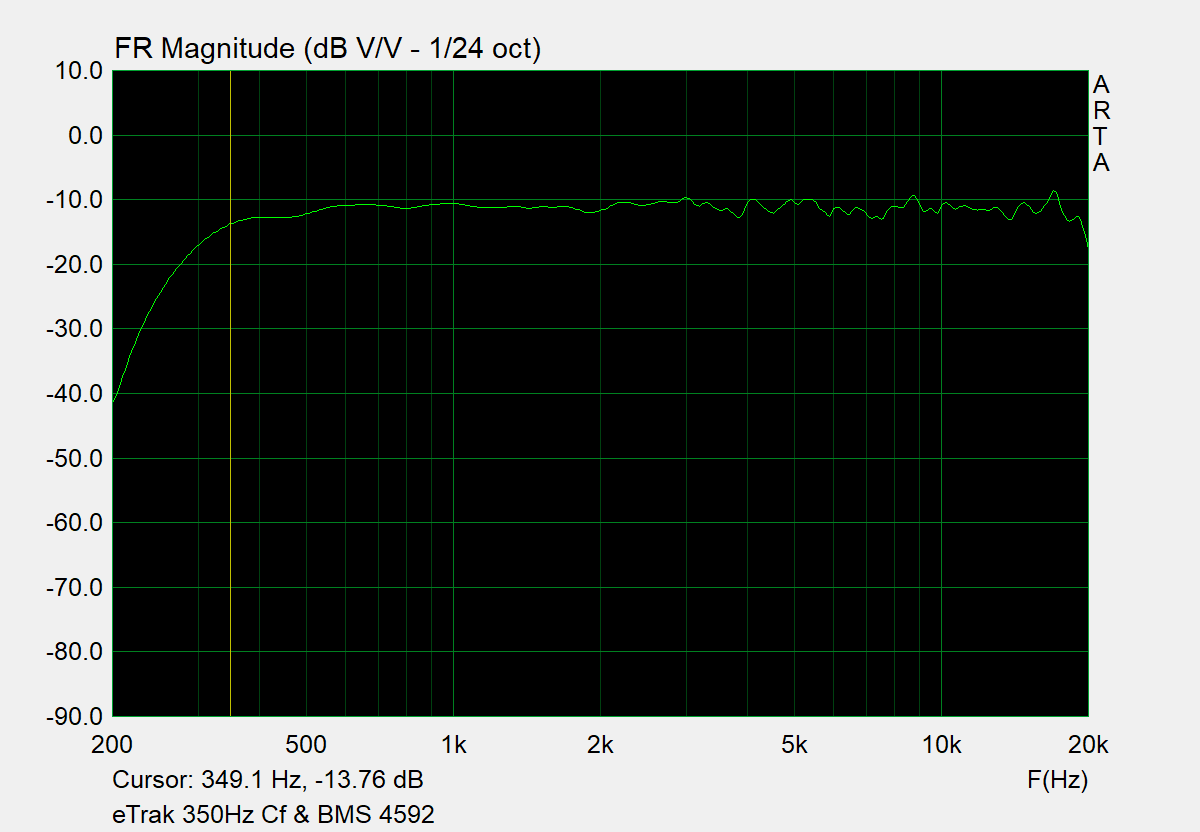

This spectral and Fr I received from the horn maker, I'm not certain all the details but the spectral confuses me, there is no resonate tail...what type measurement is that?
Because I am not smart enough to model it myself nor does the horn maker have a chart for me...I stare at this and imagine......
I've shared some these charts before...
on axis with just the hf of the BMS
25 degrees Horizontal
