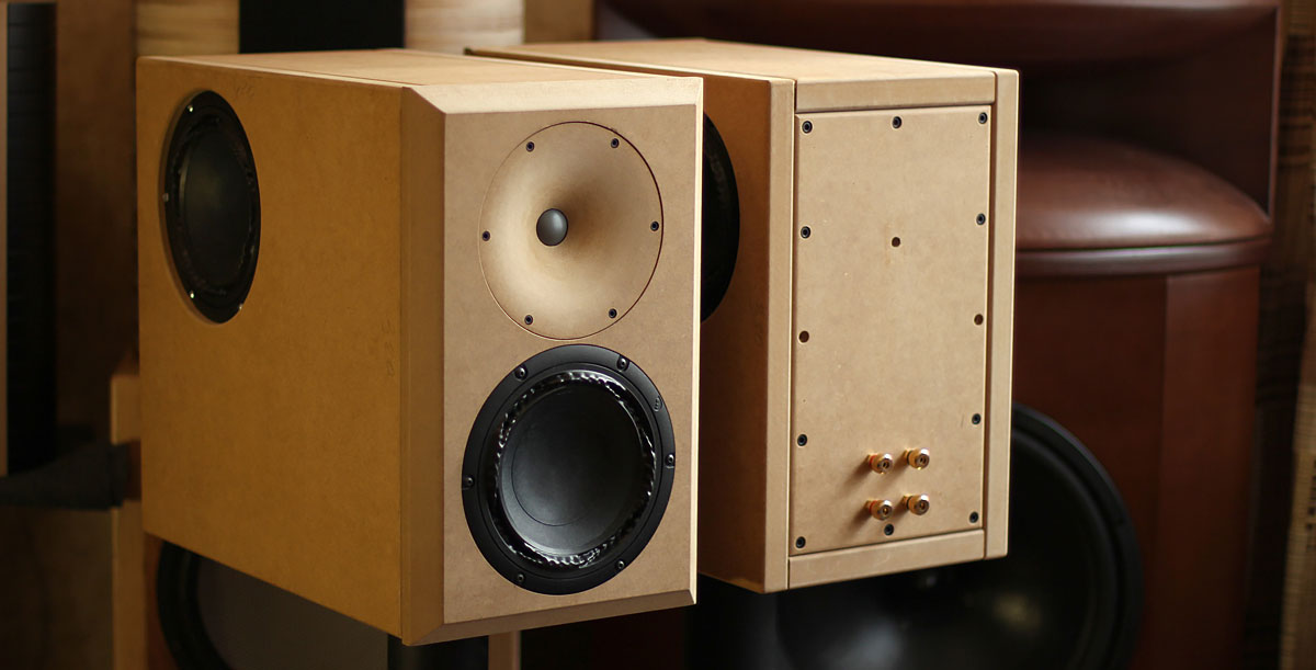

For this I would use the socket head cap screws shown above by mark100, (I wouldn't use stainless though) with insert nuts. You can torque these down pretty tight and remove them as many times as you like. How many will depend on the thickness of material and if you have braced the panels. The stiffer and flatter the panels the less screws will be needed to hold them in place with an airtight seal.So I'm going to have to make several panels, re-accessible, for the long term... I'm trying to hypothesize a good screw per inch for these panels....any ideas?
This from Hificompass seems like a reasonable amount for a small speaker
Yes I have 100 of those screws and matching inserts.. . looks to be approximately 2.5" per screw...

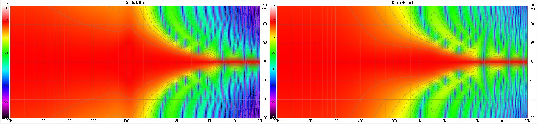

No, not "terribly dissimilar", they both describe incredibly "beamy" horns, reducing from around 90 degree at 1000Hz to less than around 5 degree at 5000Hz and above.(15m left, Axi right) - This is what Vituix shows me... The polars aren't terribly dissimilar are they?
That bad of a horn would be hard to build even if you tried to
![whazzat :whazzat: :whazzat:](https://files.diyaudio.com/forums/images/smilies/whazzat.gif)
They both can't describe beamy horns because one is a 15" woofer lol....A rectangle source is the best I could do for the Vituix dispersion Tool.....surely the real polar isn't so beamy.... the dispersion around where the source width looses directivity is more important to look at here....the beaming of the upper register is exaggerated, surely, by the bad modelling representation.

The rectangle isn't going to help you at all, the 15" woofer will beam like a laser high enough in frequency. You can see that in the simulation I posted before.They both can't describe beamy horns because one is a 15" woofer lol....A rectangle source is the best I could do for the Vituix dispersion Tool.....surely the real polar isn't so beamy.... the dispersion around where the source width looses directivity is more important to look at here....the beaming of the upper register is exaggerated, surely, by the bad modelling representation.
If you are using MDF or particle board, I would highly recommend Confirmat-style screws. I really like them as they are quite strong and the same hole can be used at least a few times without falling apart. I got mine from Lee Valley.Yes I have 100 of those screws and matching inserts.. . looks to be approximately 2.5" per screw...
