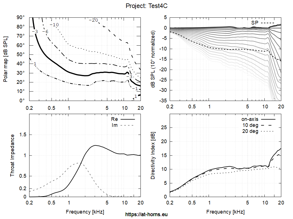

Just to make sure I'm smoking what is being put down....Are we trying to say here that I can cross that Axi at 400hz with an OSWG without it loading to 400hz? I thought we had this conversation before and the verdict was a no? Am I mistaken?
Of course you can if the driver is happy doing it and you don't expect the SPL to be maximised.
Here is an example, not necessarily the best but it was on my desktop.
The waveguide is down 5dB at 400Hz from where is is through the majority of the range and it keeps letting go gracefully below that. This one is not small because I didn't want it to be narrow but it could have been much less wide if narrowing the pattern was acceptable.
This is all waveguide because there is no lumped element model of the CD being used. If you looked at the radiation impedance you might say no because it's virtually zero, but the polar and the SPL produced say yes 🙂
