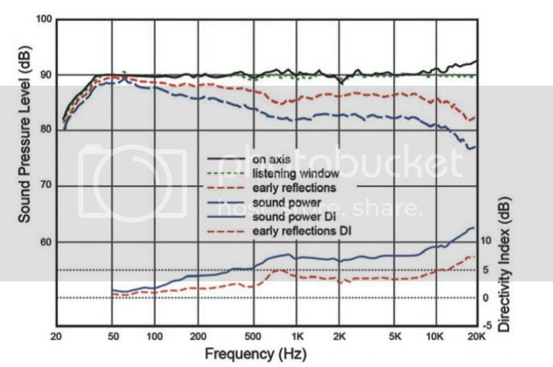

This is a spinorama for the JBL M2 that I'm sure you are familiar with. It's DI does not looks flat, it rises but is relatively smooth. Is it a bad speaker ??
That's a respectable DI when compared to many other speakers. Is it perfect or ideal, no, but it's not bad. I'd look to fix the beaming at the high end with a better waveguide.
To me, in the spinorma data the vertical is given too much weight, i.e. equal. I do not consider the vertical DI to be as important as the horizontal because we live in the horizontal, not the vertical.
In my room designs the vertical is dealt with in the room differently than the horizontal minimizing the vertical DI and maximizing the horizontal. Spatial aspects of sound are stickily horizontal (our ears) and vertical only acts to interfere.

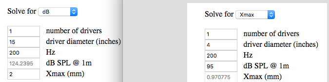

The annular ring Axi diaphragm has a larger voice coil than a 4" diaphragm, but about the same Sd.
Assuming 1mm Xlim (generous, it's probably less) your Axi driver with no horn could produce around 95dB at 200Hz at one meter, while a 4" fullrange driver (at only 2mm excursion) could do another clean 6 dB more, an easy 101 dB.
The full-range driver would not sound "broken" hitting peaks of 106+dB, while the Axi would have you cringing every time 95 dB at 200 Hz is reached.
A 15" driver at 2mm excursion can produce around 124dB at one meter, "sounding" about 5 times as loud as the Axi with no horn.
At that level, most listeners would find a 200Hz sine wave tone "uncomfortably loud" 😉

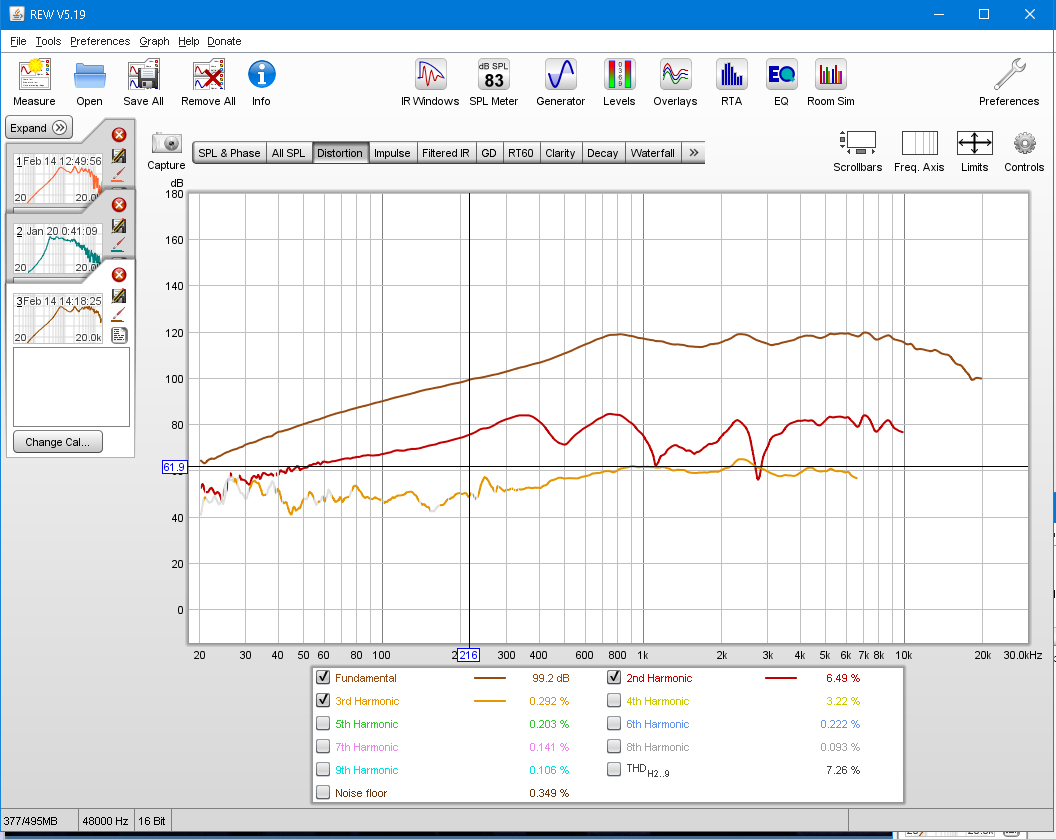

I don't think I found xmax yet and I can't play any louder at the moment...this is still measured about 1.5" from exit

the very last measurement is at 1.5, the previous 2 at the exit...
Its a minidsp usb umik-1....how do you calibrate it?

this is at the mouth with no XO...
That chunky stuff on the 2nd harmonic by 60hz...2nd harmonic starts peaking there...maybe thats xlim? Maybe thats xmax in the peaks around 350hz?
Even at low volume? at 20hz? I don't mean to question you but I have no idea....
I'm not seeing your picture, but hammering the diaphragm will result in non-harmonically related distortion/noise.
At 20 Hz, the Axi probably can do around 55 dB at 1 meter, about 20 dB less than you are likely to hear, you would hear the hammering noise more than the fundamental tone.
At 40Hz, it should do around 67 dB at 1 meter, in a quiet room you may just hear the tone before the noise. There will be a level where you hear the 40Hz tone, (likely with high levels of HD), then a rapid change to a "buzzy" or "clacky" sound.

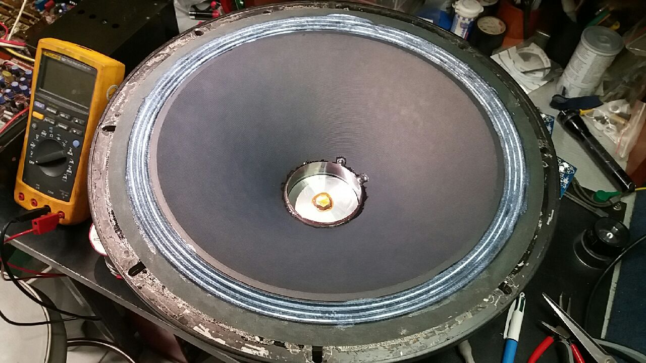

There are at least 3 reasons why many folks cherish the midrange of the Altec 416-8B, as well as the adequate low freq. capabilities in an appropriate sized (very large) cab.:
1. Low Xmax, less than 4 mm
2. Low Mms, 51.6 Grams
3. Curvilinear cone and a small VC diameter (see attachment).
I think the M2 has a 1.5" throat, if it does the rise from 10 to 20K is hard to avoid without using a 1" throat, which you have spoken about before. Given camplo is using a 2" exit driver the top end will beam on most waveguides.
