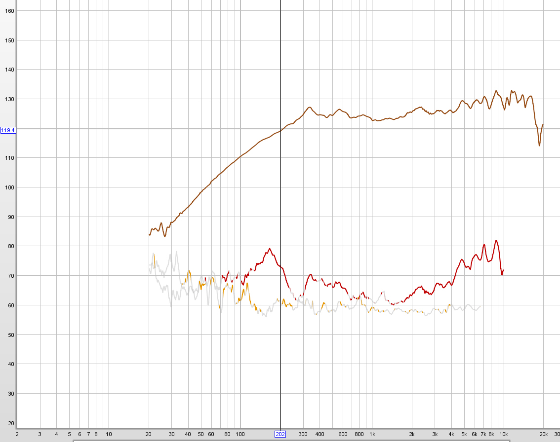

what happens when you play 30hz and 700hz tones at the same time at volume? Can you try to find some type of breaking point? What type of bass load...can you be our guinea pig for a hot second lol!
I've always thought the pioneers put it rather distinctly regardless of size/BW, 'if you can see it move, it's distorting' and since the distance wasn't ever stated TTBOMK, I used the then Altec [USA?] published 4 ft on axis measurement standard.
obviously this has something to do with 4ft lol.....can you elaborate. How do I apply this? aim for desired spl at 4ft? if its moving/distorting add sd/raise hp/etc etc?
Can we see 1mm movement? lol!
Does my Dats output 1 watt How does a person give 1 watt? lol!
FWIW I have 10Hz to 20KHz through the same drivers and it is the best speaker I have heard or built and there is no breaking point due to IMD. I am sure if I measured IMD it would look terrible. If IMD was a significant factor this speaker would sound broken and it does not.

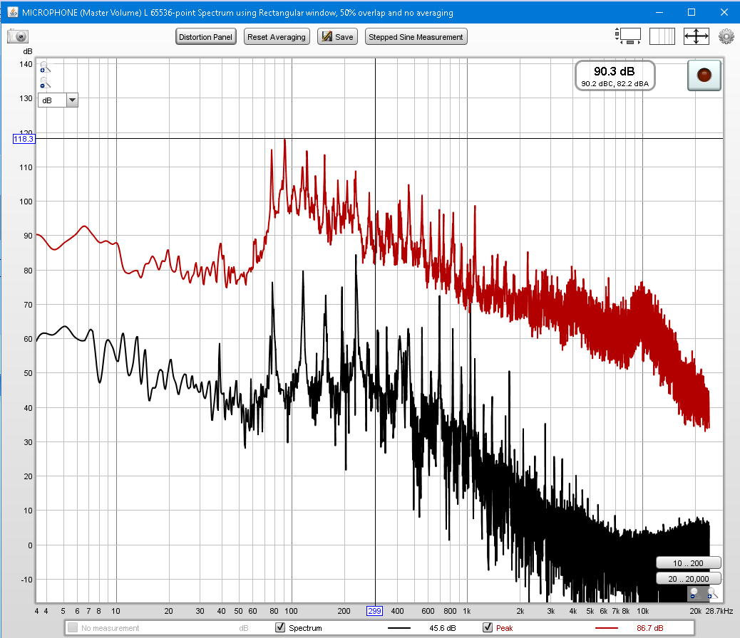

An interesting story: Trying to track down what I thought was a flaw in my speakers, I found that it was in fact clipping on the source signal. It was very limited, only a few times on the entire selection, but I heard it every time. Being only a few clipped samples, I wrote a simple program to interpolate back the clipped data. This resolved the issue that I heard. Thinking this was a nice trick that may have merit I sent out two selections to friends, one repaired and the other not and asked for their opinions of the differences. Most, if not the majority, preferred the clipped selection, sending my idea down the drain.
If it were a general all purpose tool I'd let you have it, but it was a custom code in MathCAD that only works with intensive user input.
That said, it would not be hard for some code to detect clipping and eliminate it using the same technique. The technique works best when there are only a few clipped samples. I have seen situations where there are a dozen or more clipped samples. This might get problematic for interpolation across such a long gap.
Note: This could not be done in real time because you have to rescale the entire song to allow for a larger signal swing.

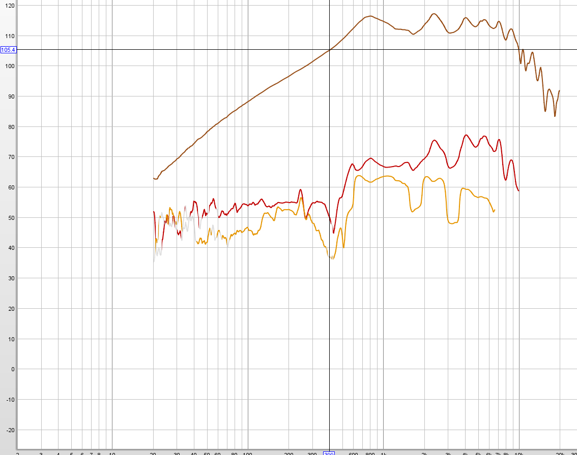

So the more I figure out about spl the more possibilities I see....
especially If I copy this current max volume at driver, profile...(1" Tweet N 4" Mid)
looking at one of my test runs without horn
I assume waveguides provide no loading...I can run one from 400hz since I can also meet max loudness from 400hz on up with no waveguide lol....I could also probably use the the 350hz horn to cross at 200hz...breaking the horn rules of course...
How do you guys feel about a group delay bump at 332hz?
