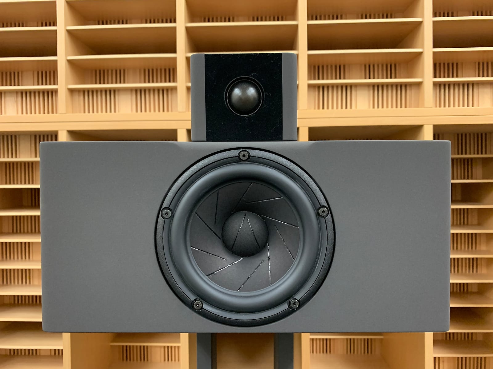

I highly respect the manufacturer, but the 5" ScanSpeak used in his near-field monitor belongs to the latter "tiny air-pump" category.
I had a pair of those, a special OEM version that cost € 549 each.
As a tiny subwoofer driver they were pretty impressive, but the midrange was plain laughable.

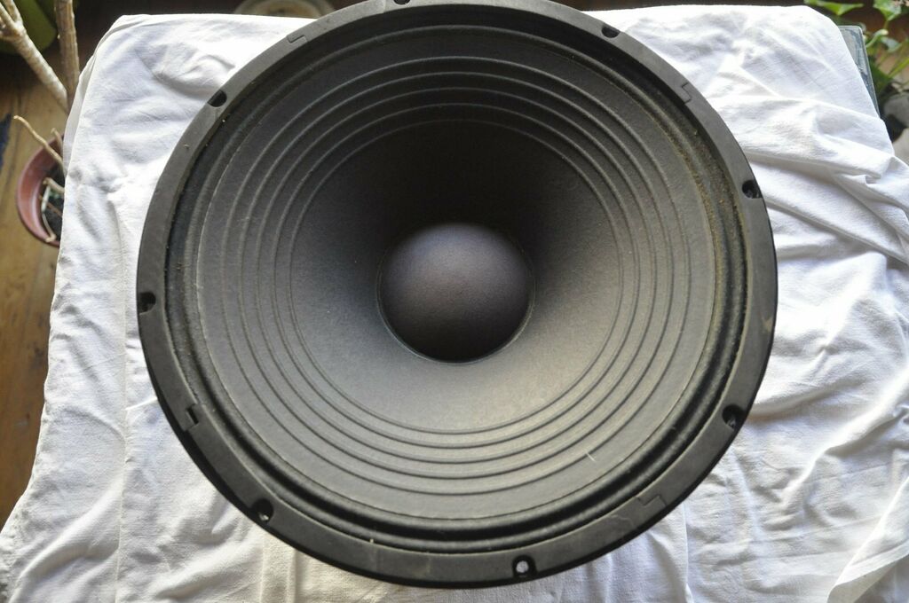

A 15" driver at 2mm excursion can produce around 124dB at one meter, "sounding" about 5 times as loud as the Axi with no horn.
At that level, most listeners would find a 200Hz sine wave tone "uncomfortably loud" 😉
Art
This (vintage) woofer can produce a 200 Hz sine wave tone at 121.7 dB / 1 m with 0.9 mm excursion.

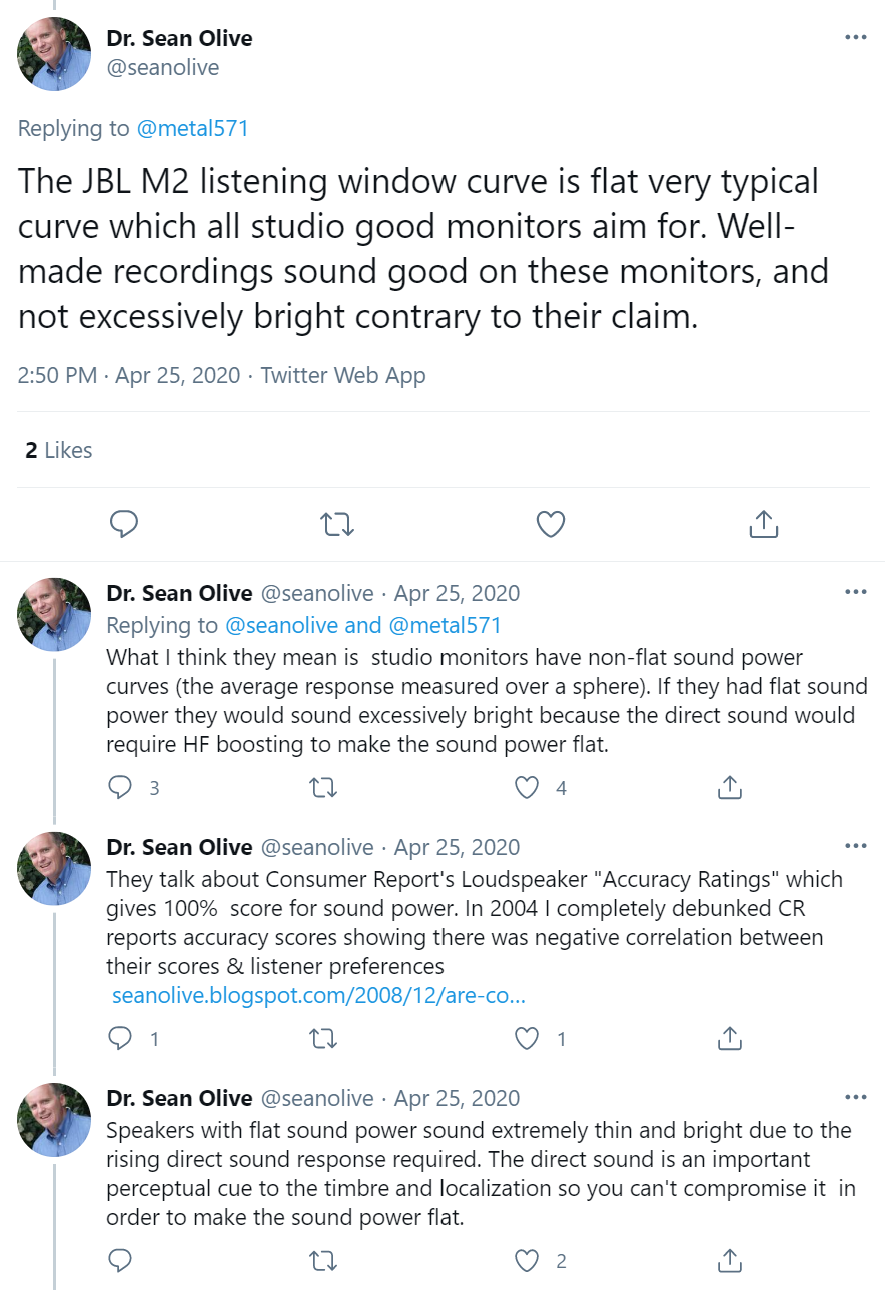

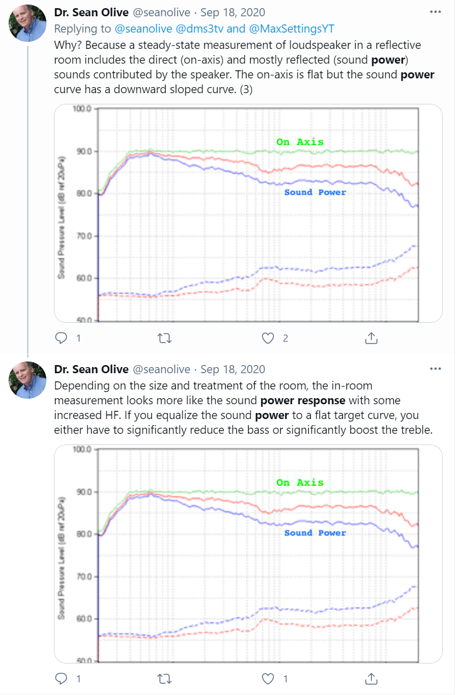

I would think that since a flat on axis response is desired, and a falling in room response is desired it would also require a rising DI to accomplish this.
This reminded me of Sean Olive's comments on the M2 measurements on Twitter, here and here.
The direct sound is an important perceptual cue to the timbre and localization so you can't compromise it in order to make the sound power flat.

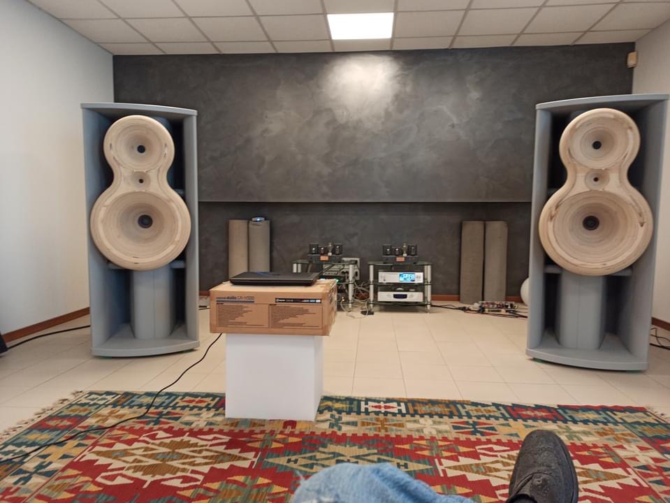

I guess this is not a meager three-way system but four ways ! Fun aside: I used to listen to old Peavey biradial horns for many years during the eighties. They served double duty back then - for home listening with a corner horn and for a small four-way horn PA used for disco.

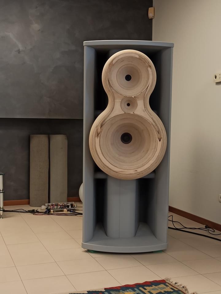

So my buddy just bought a 3d printer, I could realistically entertain any available OWSG models at this point but I would need to design one for this particular situation is what it sounds like.... I could also fabricate one of Docalis horns if he ever gives in and produces a 350hz model lol. Then we could have our OWSG vs Loading Horns shootout probably by the fall? Not sure how long it could take, seem like printing 3d can be slow but maybe we could get it in before my work starts? My work starts back in May so....I'm not sure how long it would take to 3d print a 350hz horn, which is not small per say.... I'd do it in sections...and line the outside of the profile with Mortar...simple enough. He basically beat me to buying...I figured there'd be some better products soon, and there are...and continue to come out.
So I could literally start working towards printing one of Docalis horns but 350hz is big enough for me and I have non of his horn profiles tuned to this....if I simply scale it smaller, that seems too easy....its 150hz smaller than the last horn he gave me...Docali let me know...
Any suggesting on the waveguide...fluid I know you know things...you guys might be tired of spoon feeding but I didn't hit the lotto either...basically if I have to teach myself to make this waveguide....I will... and it won't be no time soon.
If you think you can produce a waveguide that will entertain some XO points described in this this thread, by me, of recent....here's your shot lol!!
My buddy with the 3d printer is an mechanical engineer with a background in 3d design so he'll be able to help facilitate the process.
Dear Forum Gods...( mabat XD) please produce an OSWG for the Axi, to showcase the abilities of this approach (400hz XO) so we can compare them to Docalis Horns of grandeur
If not, No love Lost =)! You are all really awesome for helping me make it this far!
