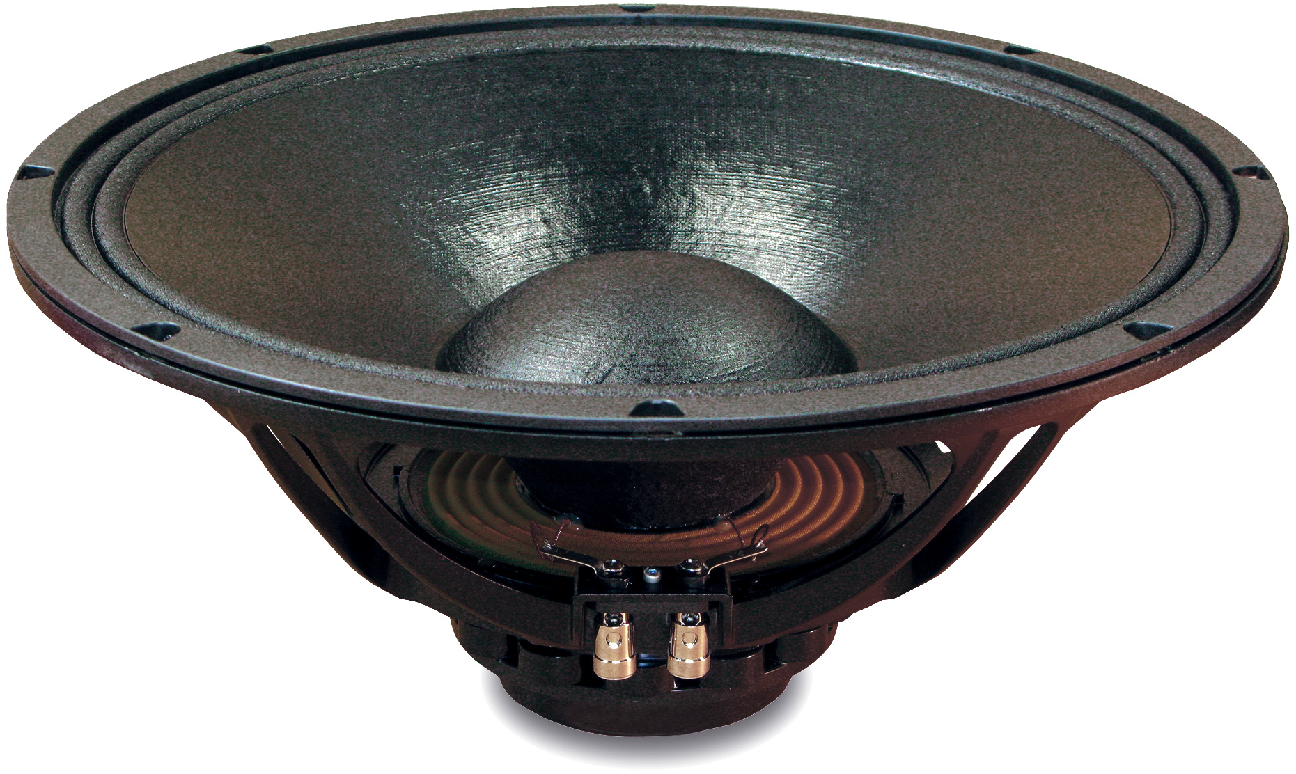

Perhaps the round overs of the XT1464 were sanded down ;-)
15NLW9500s... Nice!
For a low crossover point, these should work fine.

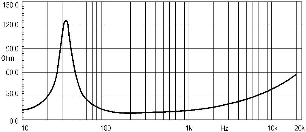

Personally, I like the light, curvilinear cones of the (N)MB drivers, which are suitable for higher XO-points to match a ND1085/NSD1095/ND1TP.
15NLW9500s... Nice!

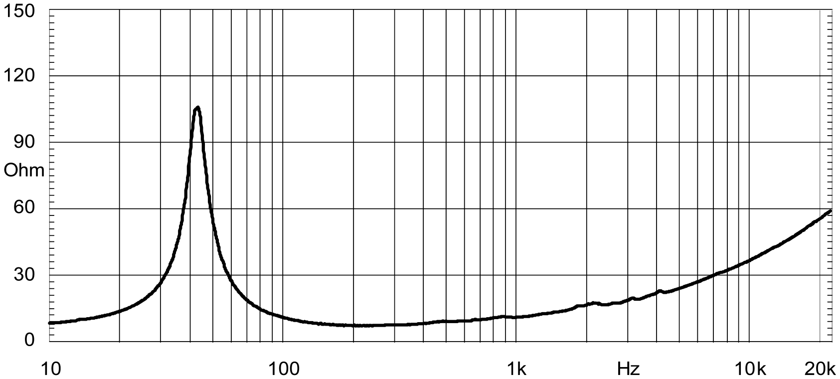

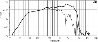

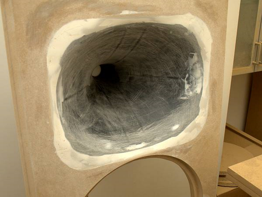

IIRC they used filler to hide the roundovers of the XT1464 on the one from the link that I posted. There were once "making of" pictures on the web but I couldn't find them anymore unfortunately.
Agreed - I would definitely not use the 15nlw9500 up to 1 kHz or more. Mine are intended for three way usage. But since it is not a lot of work I may just exchange the Beymas in my MTMs with these for a try. Some changes in the crossover will be needed.

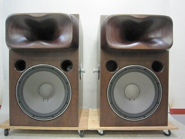

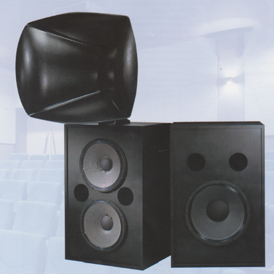

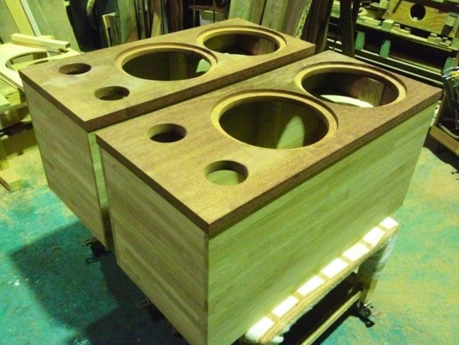

In the light of this thread, a few 2 way loudspeaker systems that I came across in the last few weeks.

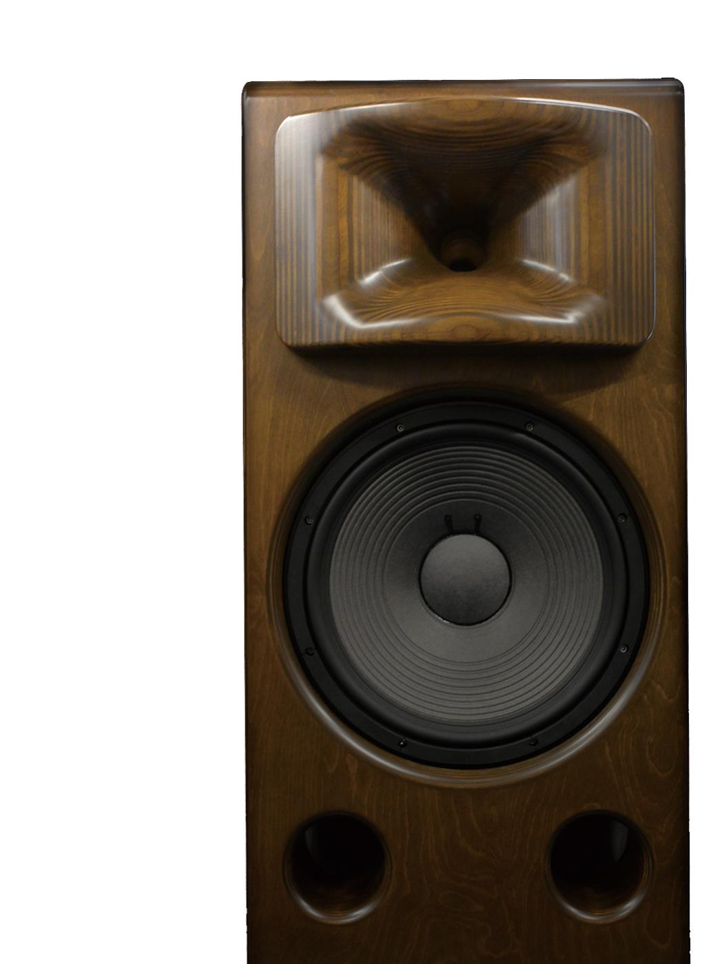

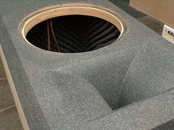

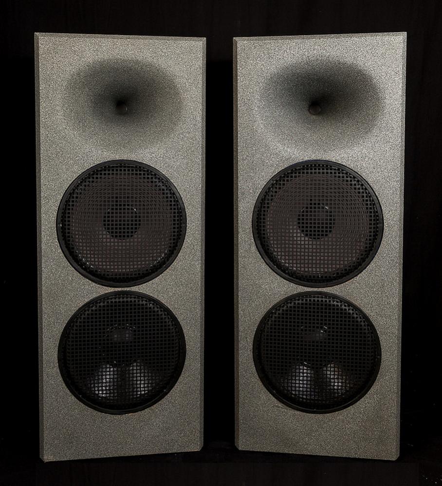

The first one is made in Taiwan, for which a clone of the Sony SUP-H11 horn is used. Drivers are 15 + 1.4" of unknown (probably Asian) origin.
The second system is manufactured in Tasmania and consists of a bronze waveguide + 1" driver and a FaitalPro 15PR400. XO at 900Hz.
The last one is a Finnish DIY project for which 1" + 15" 18Sound drivers were used. The horn appears to be a modified FaitalPro LTH142 and the woofer looks like a 15MB606.

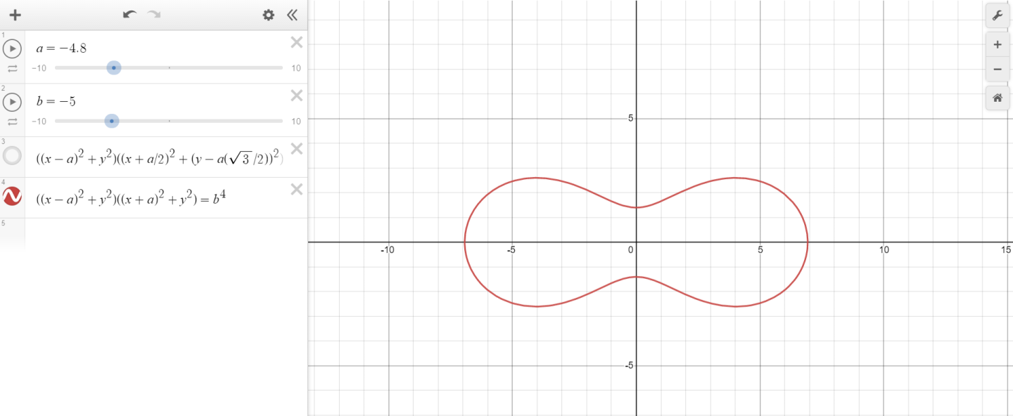

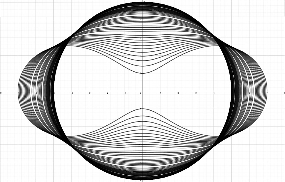

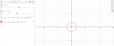

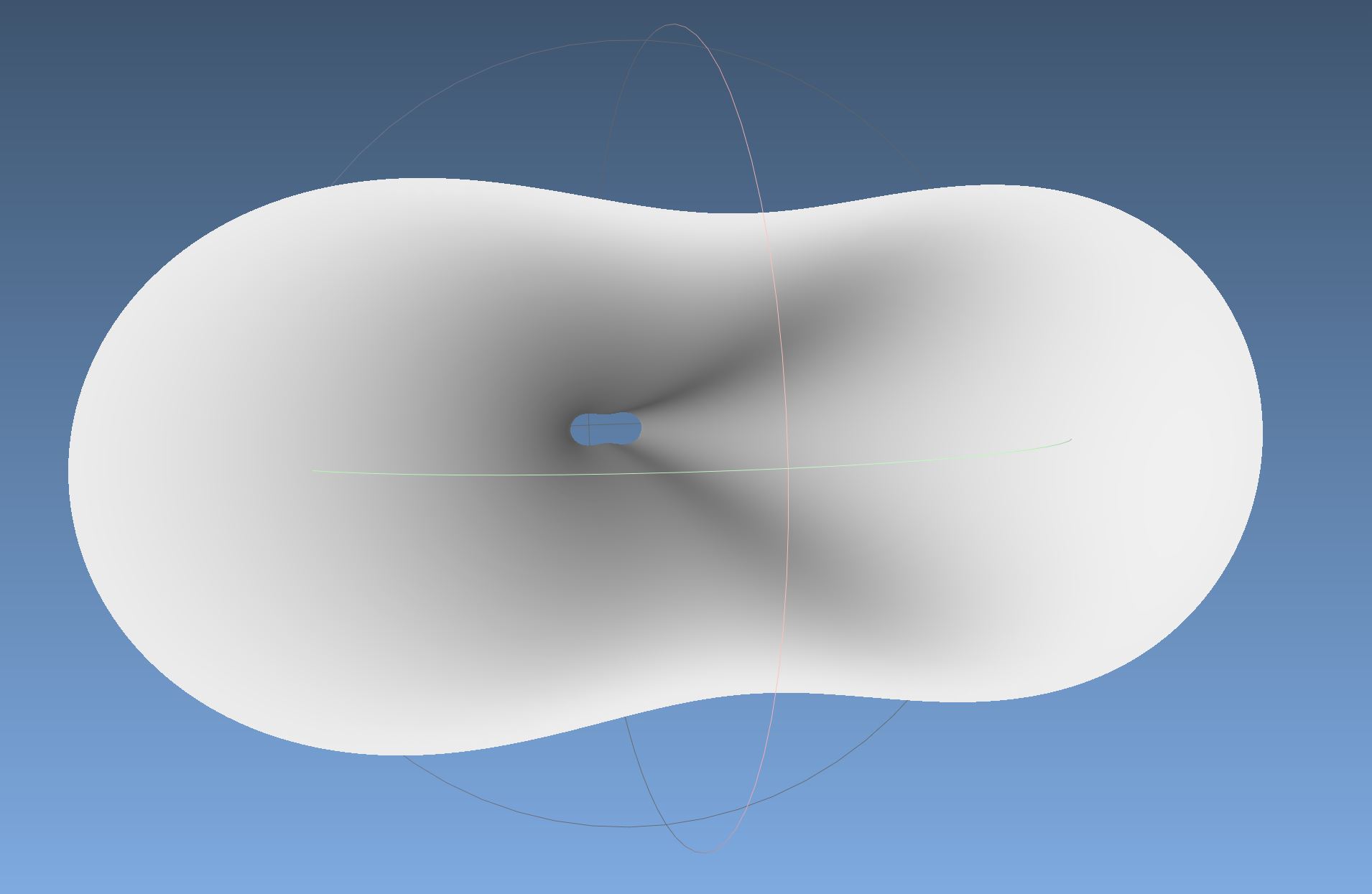

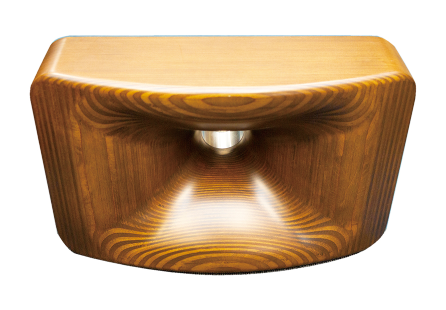

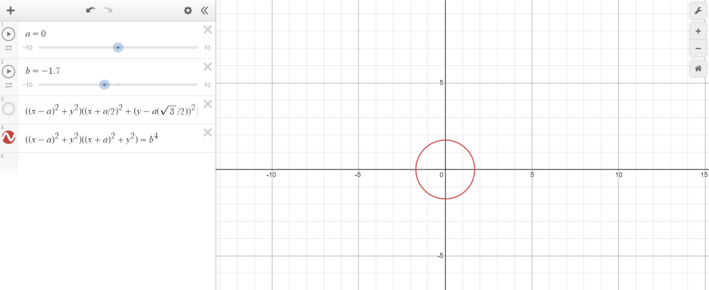

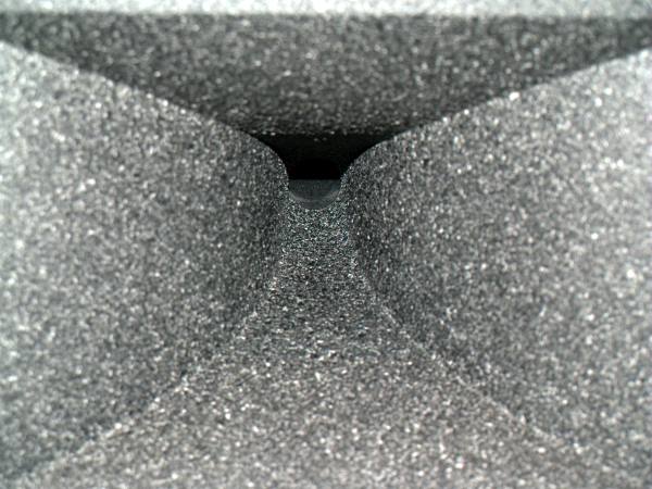

The first horn can be created by a function originated by Giovanni Domenico Cassini. One of my very first attempts to play with horns. Does someone have actual measurements for this type of horn?
Interesting!
Sony made different horn variants with a similar profile.
One only needs to find an appropriate transition function to make the throat round...

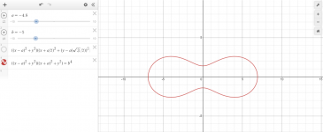

Something like this?
Calculator for Bipolar (and Tripolar) Cassini Circles.

The cabinets were finished with granite effect spray, which was also used for the smaller brother (12" + 1").

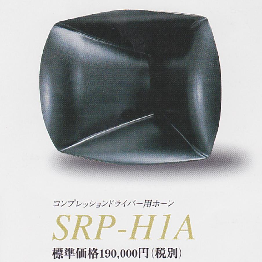

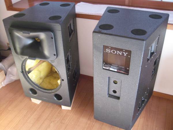

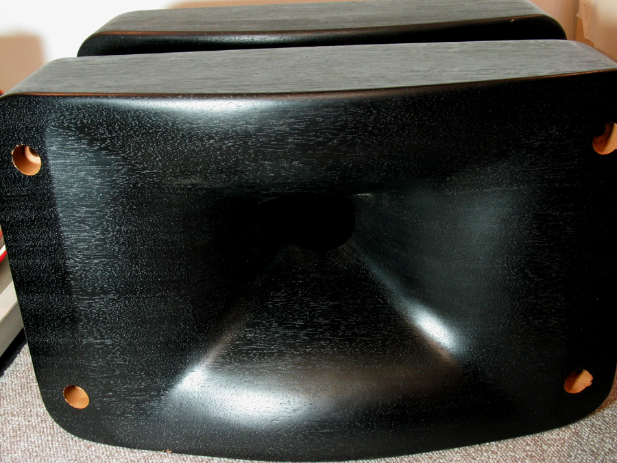

Measurements of the Sony "Cassini" horns are very hard to find.

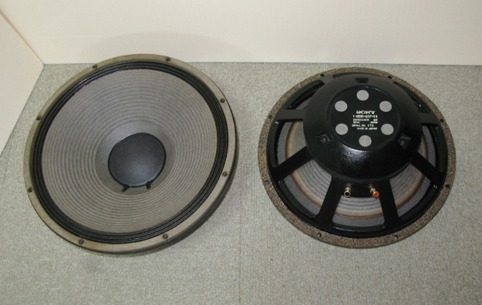

G.T. Sound, that continued development and production of the Sony SEM legacy, only reproduces the small SUP-WH3 horn, which was originally developed for a PA loudspeaker (SRP-S5000). The drivers were Sony-branded MCCauley units.
The same drivers were also used for Sony's extremely rare Cinema speakers.

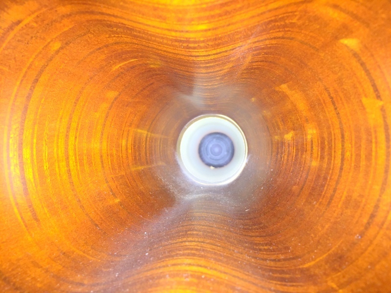

Those horns have less in common with the Cassini style horns and look like having a diffraction slot.
I suppose that the intention of reducing the central region of the horn works like a nozzle. A simulation could bring more light into this. This should be quite similar to the biradial idea.

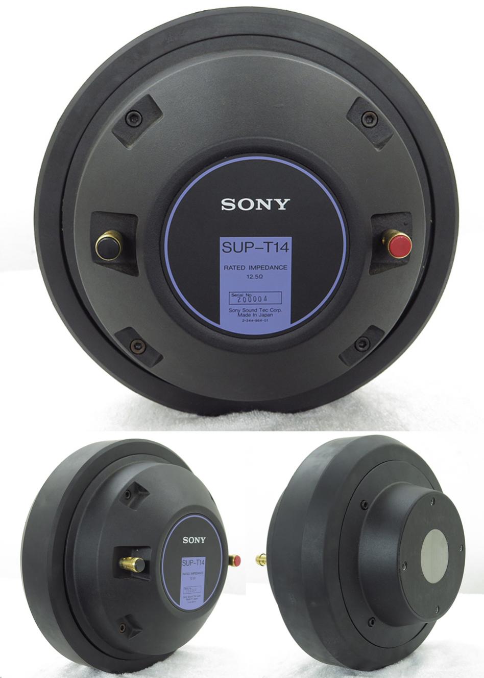

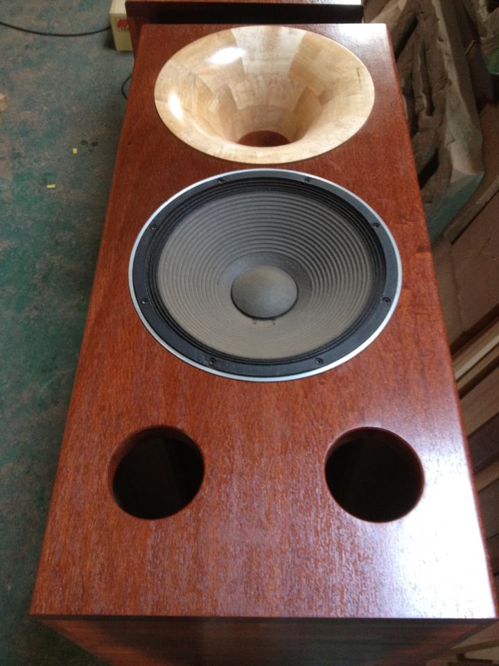

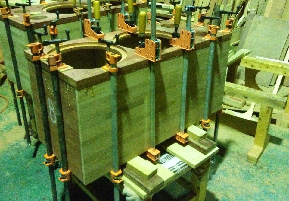

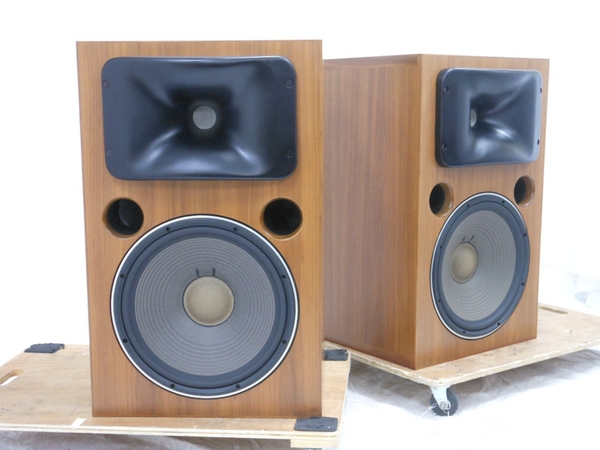

As mentioned previously in this thread, Sony Professional drivers have acquired an almost mythical status in Asia.
The compression drivers are mostly used with Arai-type or axisymmetrical horns.

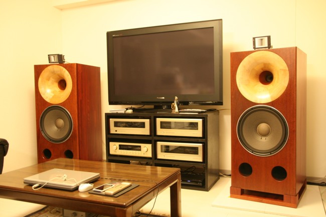

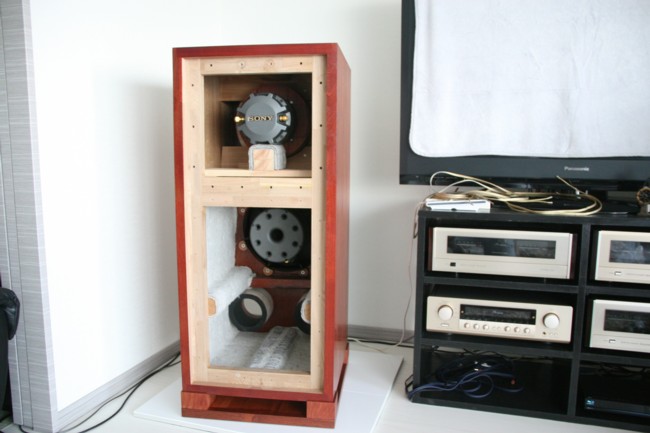

A Japanse guy made custom horns and enclosures for his Sony SUP-T11 and SUP-L11/TAD 1601A.
