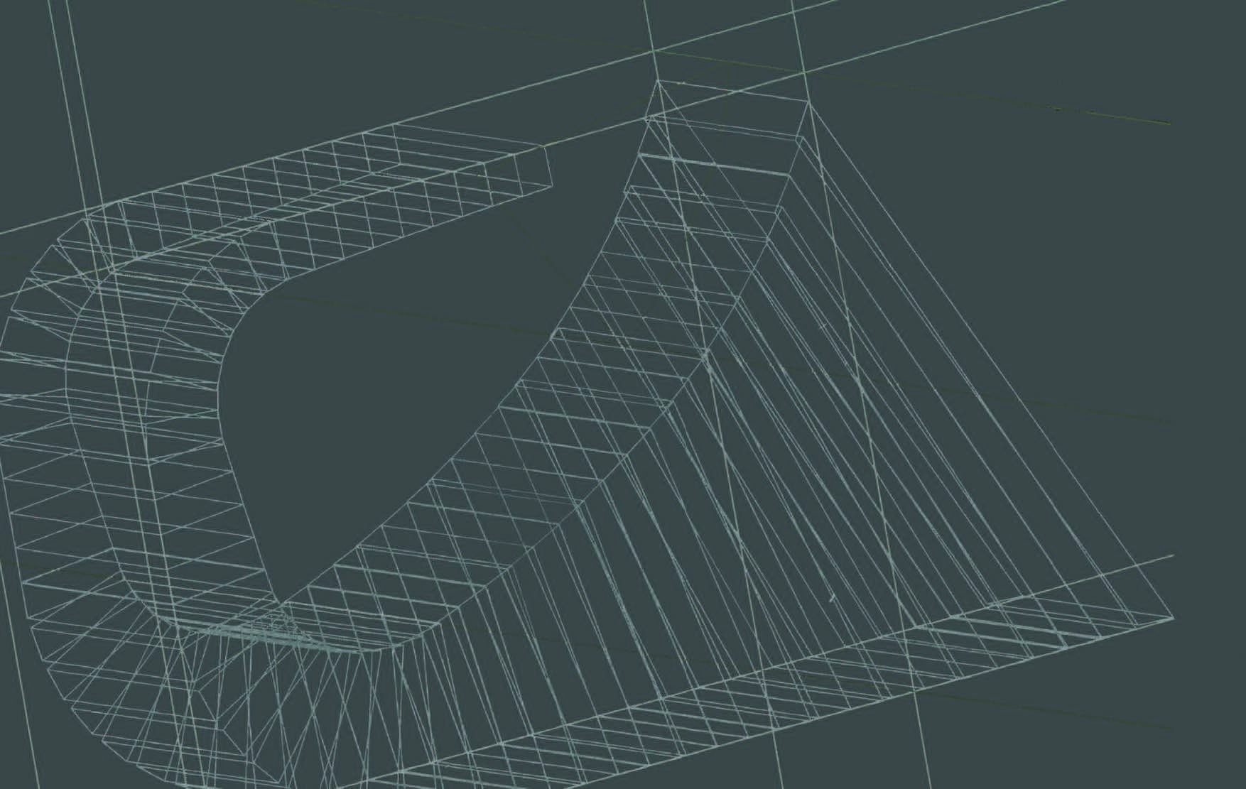

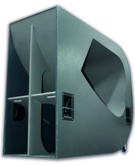

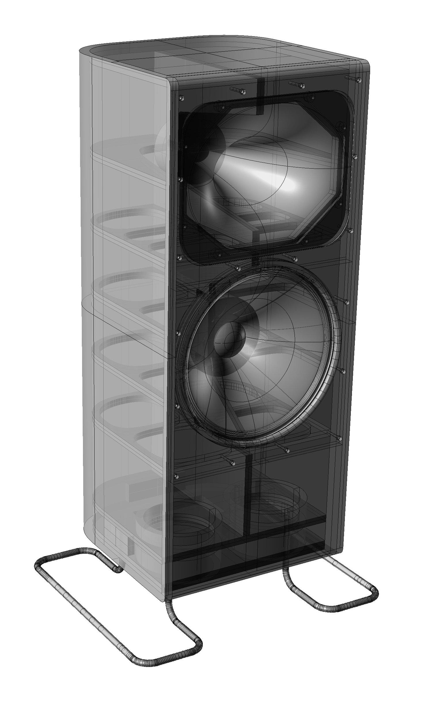

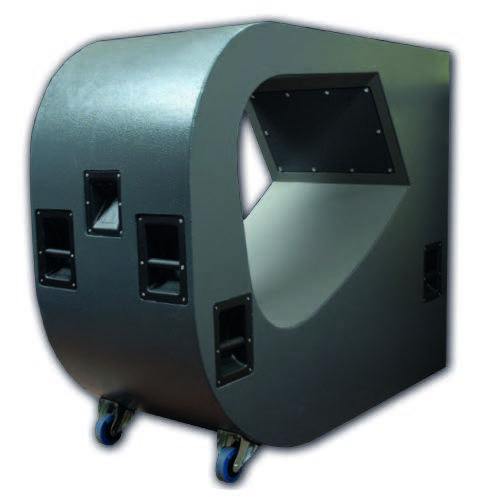

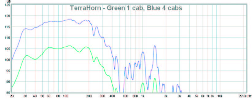

Outdoor bass.

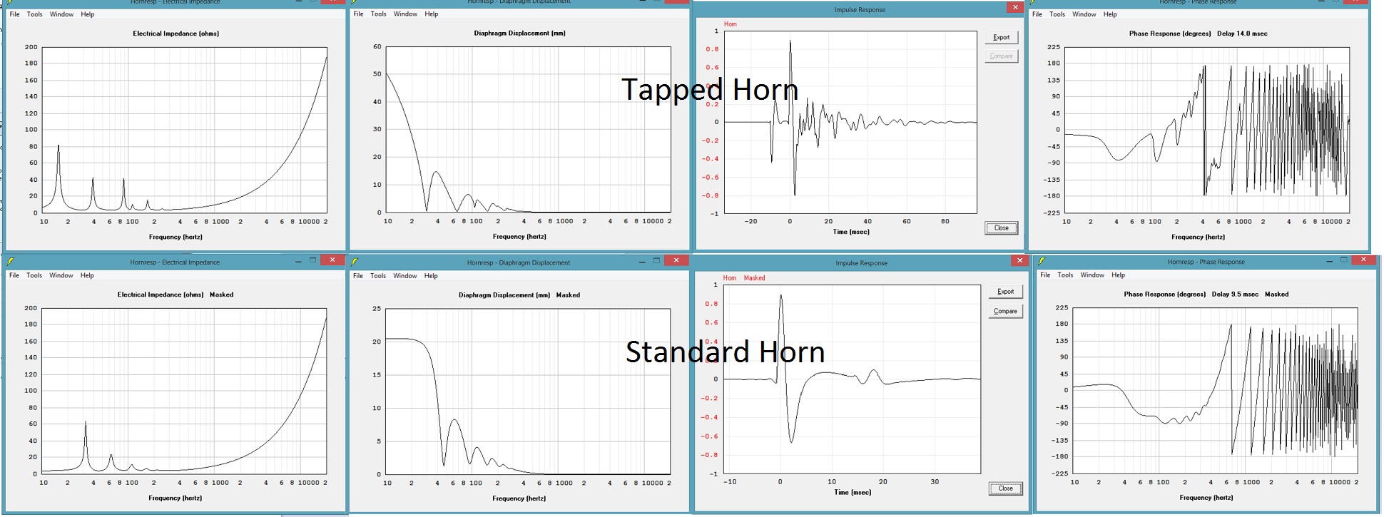

Peter Morris:
"FWIW a normal horn’s behaviour is better than a tapped horn in all respects. The tapped horn is a useful compromise when the size of the standard horn is an issue. You can get good bass extension and efficiency out of a relatively small box."

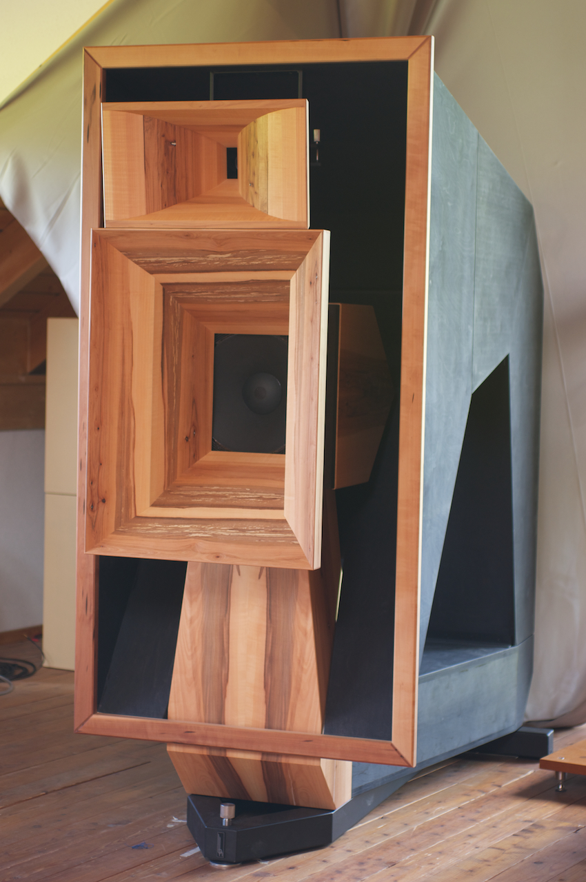

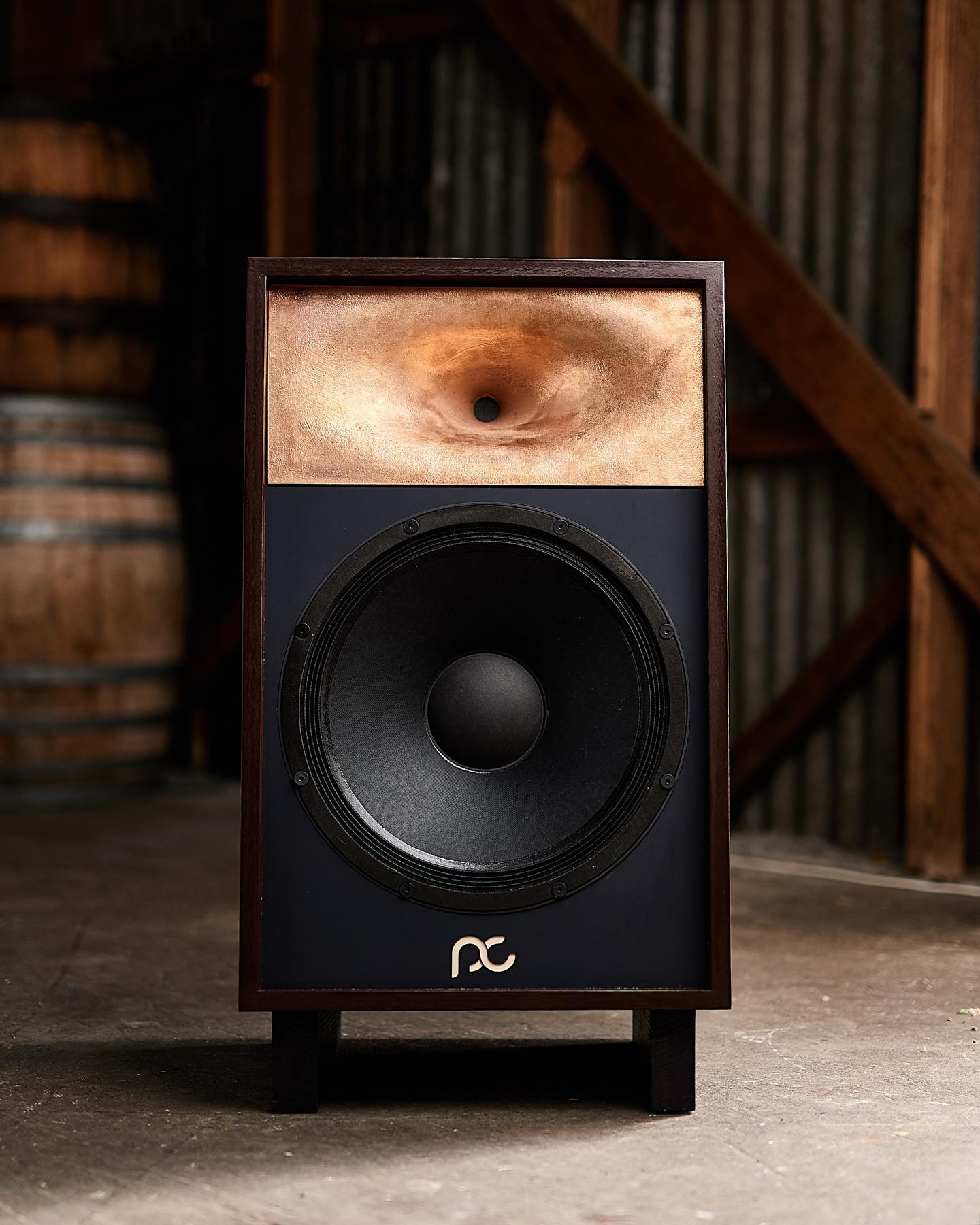

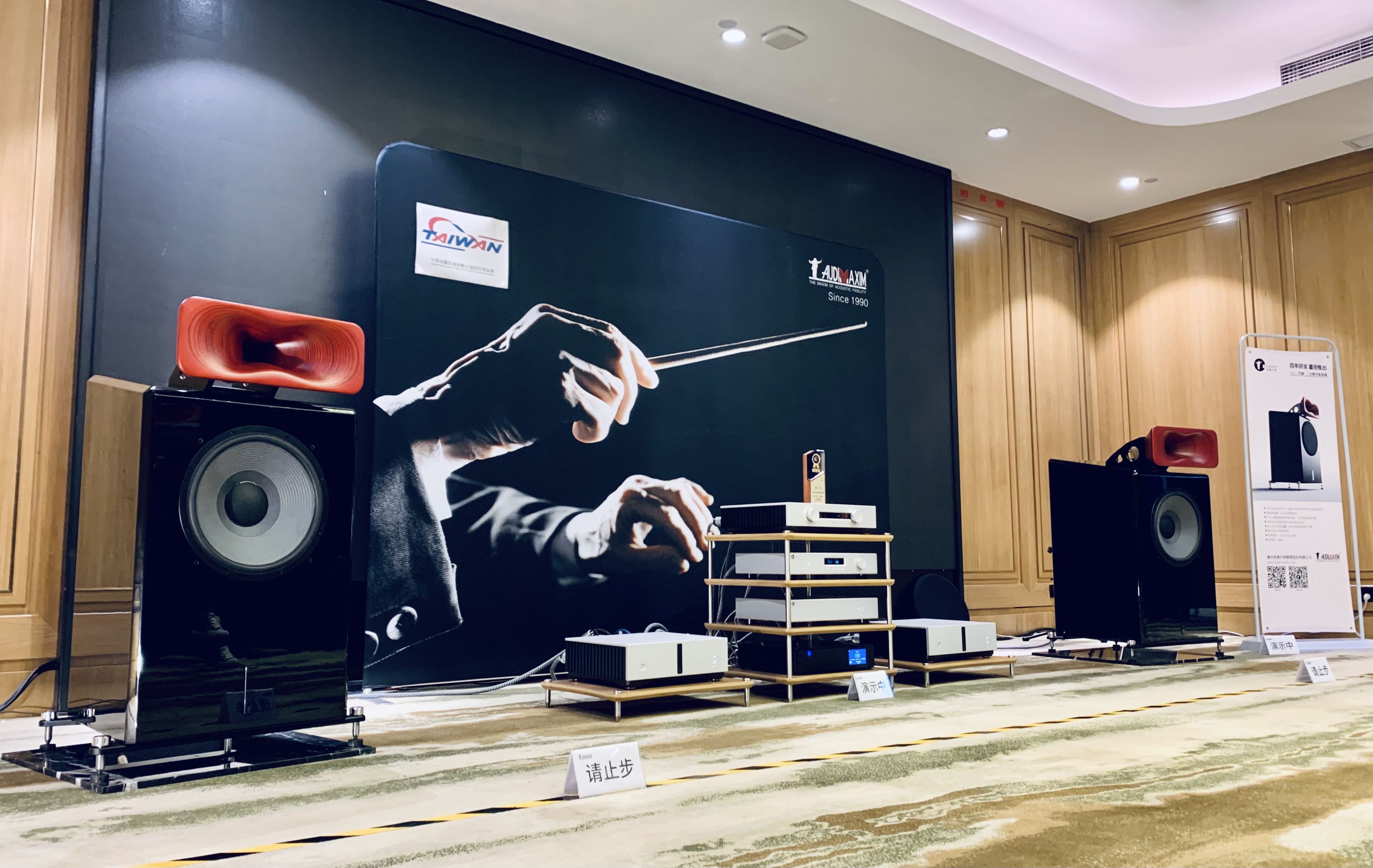

In the light of this thread, a few 2 way loudspeaker systems that I came across in the last few weeks.
The first one is made in Taiwan, for which a clone of the Sony SUP-H11 horn is used. Drivers are 15 + 1.4" of unknown (probably Asian) origin.
The second system is manufactured in Tasmania and consists of a bronze waveguide + 1" driver and a FaitalPro 15PR400. XO at 900Hz.
The last one is a Finnish DIY project for which 1" + 15" 18Sound drivers were used. The horn appears to be a modified FaitalPro LTH142 and the woofer looks like a 15MB606.
