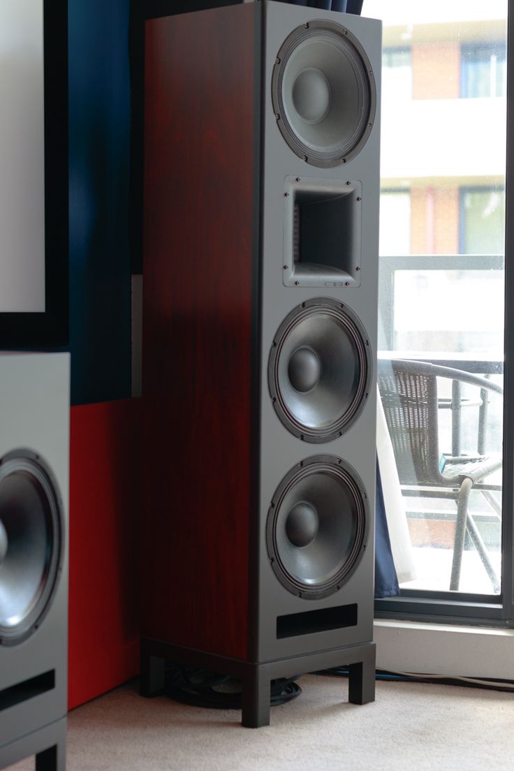

I've been second guess this PPSL thing
LIke I said...even though I argue...I try to take what you guys tell me seriously... So allow me to go through the motions for the sake of my sanity....
Is this PPSL even worth it for me? The 18H+ has all that useable upper range that gets high passed due to slot resonance/cancellation...
I was thinking I could configure like the pic up top.... with the 15m on top and the 2 18h+ on the bottom..... MTMW...yes I know its not traditional but I think it would work fine I actually like the idea of the 15m and 18h+ working in tandem...I end up with a little lower group delay around 100hz in sim..... The efficiency through most of the bass increased greatly as the bottom woofer can help out much higher being out of the slot.....
The bottom woofer, low passed at 35 with a lr12, at xmax, in half space, 30hz is at 112db with 2db (114db potential total) of help from the other woofers (no other filters but highpasses on the top 2 woofers).....vs the 117db at Xmax in PPSL....
On the other side of the fence....I can create some nice wide polars on the vertical with the 3 way config....excursion is much less in the lower bass....
The more I look at the two sims the less differences I see. The two major differences are the major efficiency in the subbass vs the major efficiency in the rest of the bass....whether helped by another woofer in mtm or highpassed in a 3 way, the 15m never sees much excursion in either setups....
I don't know what to think about that....How much efficiency do I need in the midrange?....the 15m never sees more than 2mm in the 3 way setup....would I even notice the increased 6db of efficiency with the mtm? Seems like a waste...but I also understand that midrange is everything...so maybe you guys know something that I don't regarding this>?
For some reason the 3 way setup retains directivity down lower to somehow...I took that as a plus for the 3 way.

Basically
Trying to weigh
My drivers in a 3 vs mtmw
1 - 15m
2 - 18h+
The three way has more surface area dedicated to sub bass (18H+ ppsl slot loaded, 15mid)
The mtmw was more surface dedicated to midbass (15mid on top of horn, 2 18H below... bottom woofer low passed, top two woofers lowpassed to horn)

I agree but the 15m never reaches past 2mm in the 3 way set up...does that mean anything?
Thats the tricky part for me right now...where to I want to put the displacement as both configurations have the same drivers.....Bass takes more displacement period....the mid only hits 2mm at max volume...so think about how low the excursion is elsewise.... Does that even make sense what I am saying?As always, 'there's no replacement for displacement' when it's time to go live

Interesting..,...the PPSL is down 20db at 200hz.....how do you analyze this, as far as its ability to "slam" - Its coupling with the 15m at this points
At 150hz its down 10db from the 15m... What do you think?
- lol guess that answers that.Crossing over 80-200hz seems to mess with the slam.
ONe thing I think about is that in the MTMW configuration...the woofer under tweeter (18H+), I could take that and eq some bass help for the W portion. How that would sound not sure...

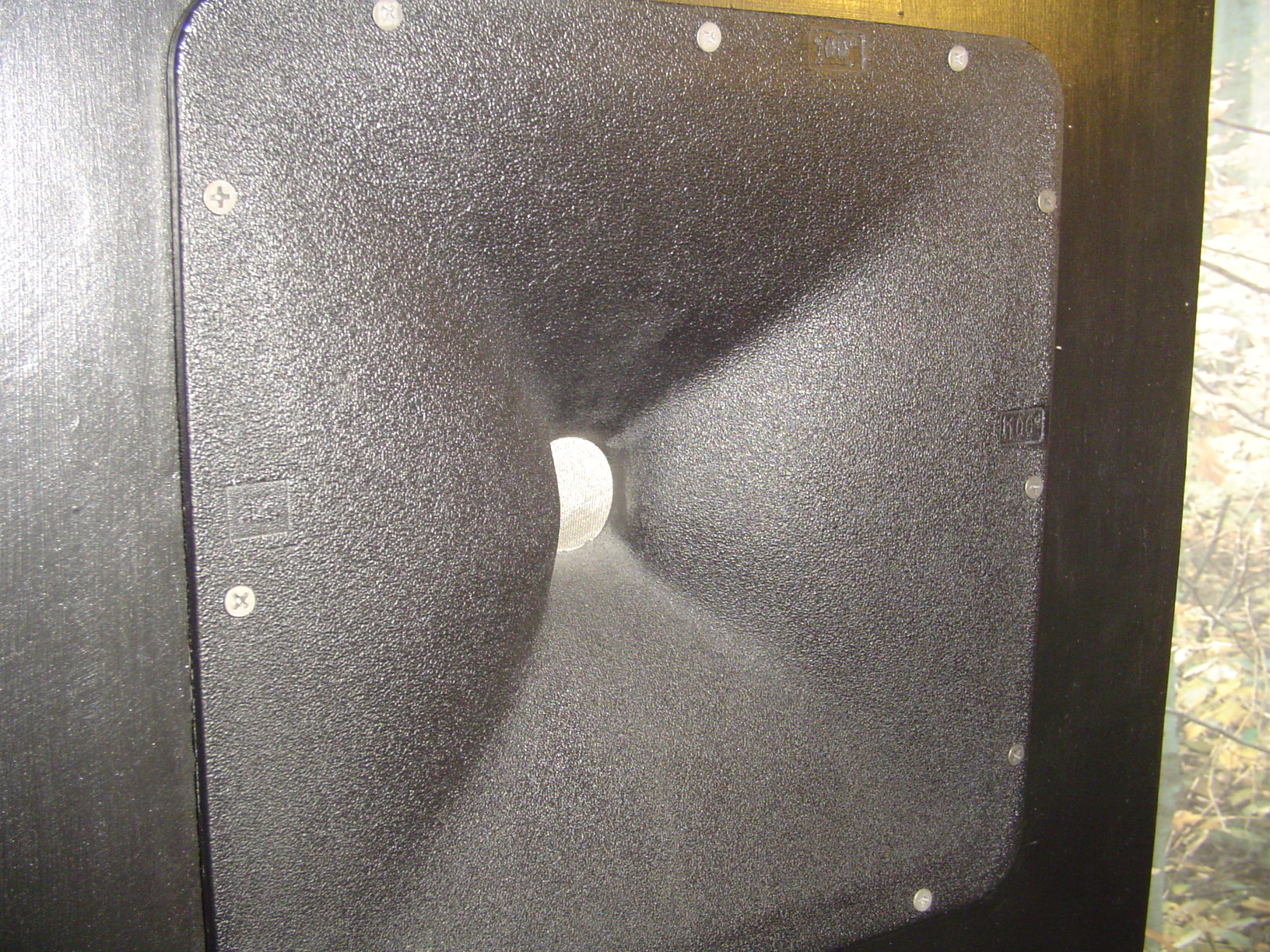

Jbl 12" 2-way using 2206 and 2431 with older pt 100 x 100 waveguide, 3" deep and 12" x 12", minimal reflections in my opinion. Even cross at 1.2khz, where a 12 should. Foam around mouth, added some acustuf also.
