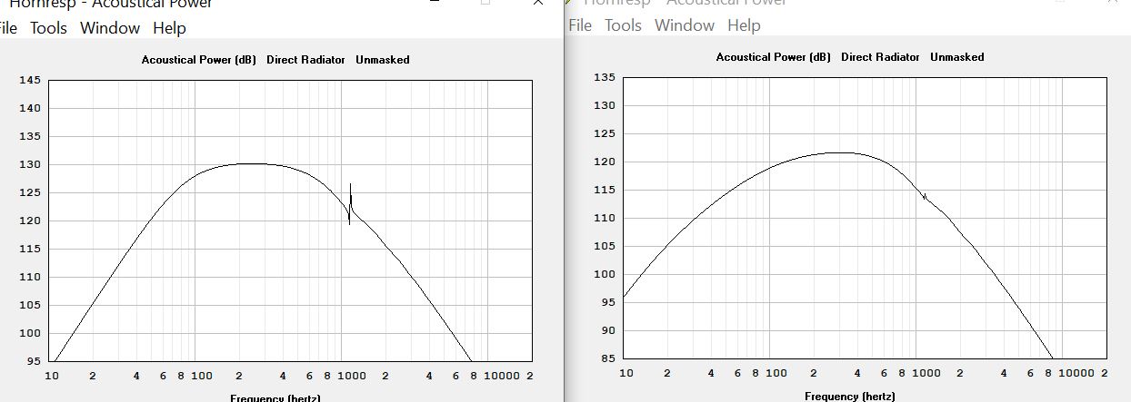

When looking at the the first graph where the box has been made a mute point....the true victor stands out....lower Q, lower inductance, lower mass driver, and higher efficiency win. The win for the Ultimax is Higher Xmax....for mycase....something that will never be encroached upon
Who ever designed the 18h+ is a genius in short.

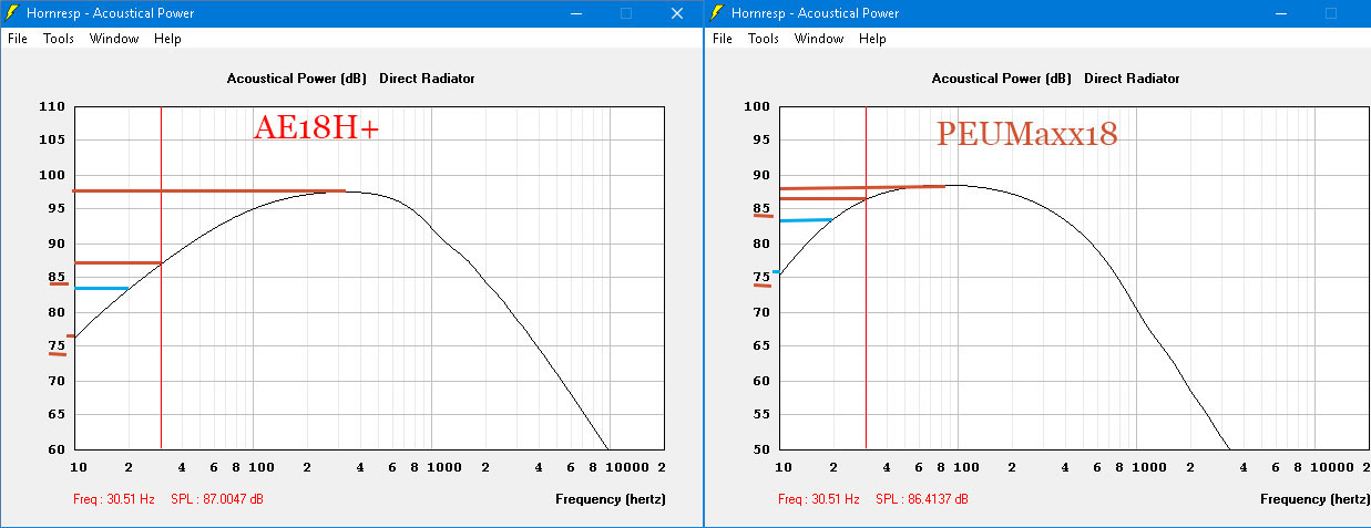

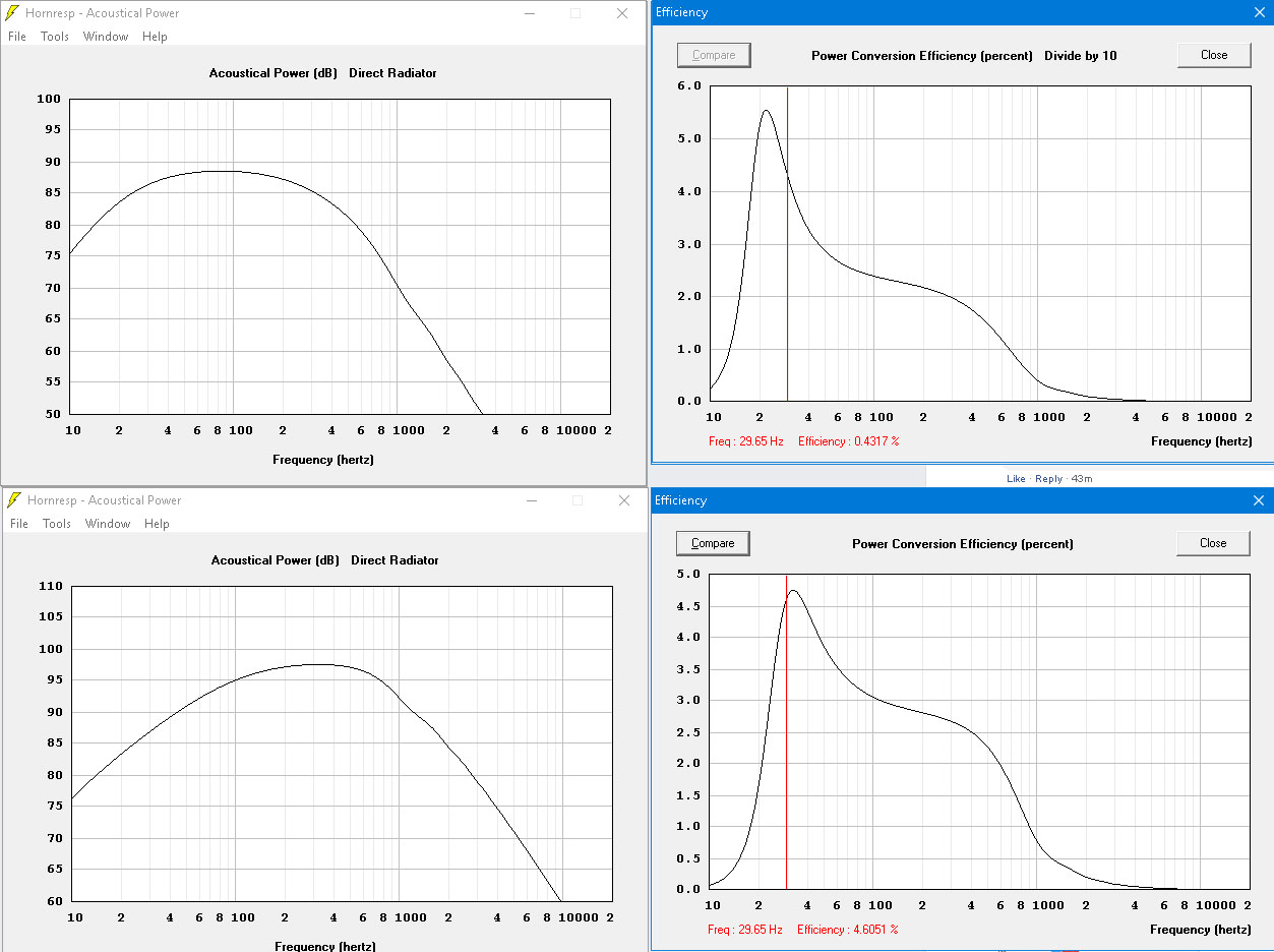

I can't see your 300+L graph of the 18+ either, so here's a comparison I made.
On left is 49L, qtc 0.7, 102v, 14mm excursion at 20Hz.
On right is 315L, qtc 0,35, 40v, 14mm excursion at 20Hz.
![18+ 49L vs 300+L.JPG 18+ 49L vs 300+L.JPG](https://www.diyaudio.com/community/data/attachments/837/837158-a42f8464fa8563d6c6ff0562b8eef78e.jpg)
All that happens with the box volume increase is a reduction in the 18+'s ability to make the huge SPL it's capable of in the middle of its range.
The low corner, again choosing 20Hz, stays unchanged. The driver has been "dumbed down" like GM said.
There is no box size or EQ that can take the 18+ above 105dB at 20Hz, without exceeding xmax.
The Ultimax is good for 110dB at 20Hz at xmax. The 18+ can not do that period. 5dB at 20Hz is a huge difference.
In my book, you are taking a very fine woofer, and sub-optimizing it into a subwoofer.

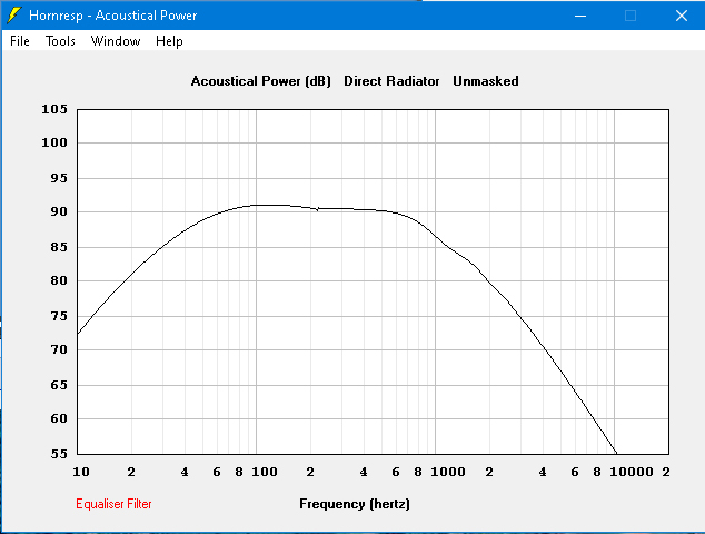

Like in this 18FH500 vented.
![hr snip.JPG hr snip.JPG](https://www.diyaudio.com/community/data/attachments/837/837197-2dcff240967437d602c327cd14dd342b.jpg)
little bit of eq....

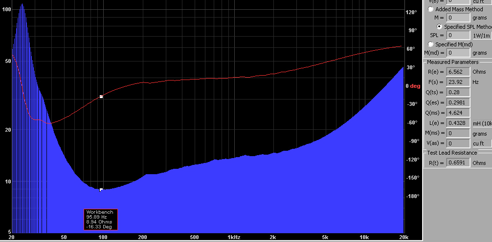

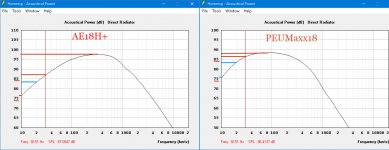

Ps- free air resonance of my 18H+ is 23.5hz
Fs is 24 (not 23.5)still lower than the Ultimax (27),.....ok so the ultimax plays 20hz louder than the 18h+....what use is that? Is this a matter of max spl @20hz? My sub is going to play to ~70-100hz what about 30hz on up...where the 18H+ does everything better.... how is that not win?the AE TD18H+-4 Apollo version actually has a lower peak than the Ultimax. Might call that one a true sub?

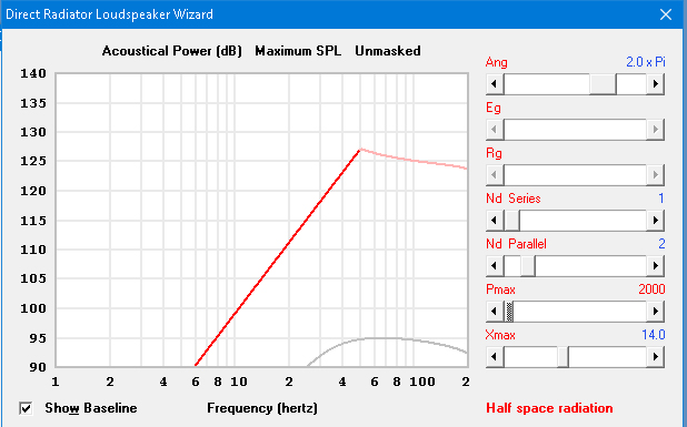

implementing active radiator technology to increase output....this is what I ended up with
is it improper to go past Xmax at 20hz? within Xlim was 115db at 20hz

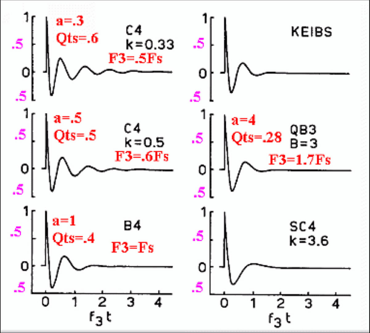

Compliance and the Spectral Decay are related are they not?
The room has a spectral decay character no less than the loudspeaker system...same goes for compliance
What I think is that compliance starts at the woofer...then is augmented by the box....and the finally by the room...the same may be true for spectral decay...
Each is a derivative of the Q or Spectral Decay upstream in the system....
The better the the compliance of the driver....the better the potential of good compliance of the loudspeaker plus box....the better the potential of the room compliance
And then the same pattern for Spectral Decay..... Compliance and spectral decay seem to go together sort of like Sensitivity and Efficiency.

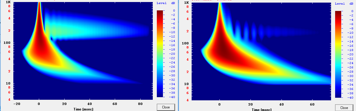

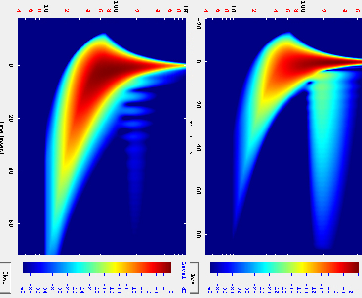

I was the one to talk about Q and Spectral Decay....Sounds like I was right to me.
The room responds to the spectral decay character of the loudspeaker and the Q. Making the the 18H+ the better subwoofer within XMAX lol!
I added more drivers to lower excursion to keep the Higher SQ (lower Compliance and better spectral decay) of the 18H+ and relieve linear excursion
The 18H+ is cleaner than the Ultimax...lets even say the Ultimax wins at the bottom....18h+ wins anywhere else...a subwoofers duty is not just below 30hz...For THX it starts 120hz even....
I didnt fully stuff the boxes so there's some resonance left on each that dampening could of killed.
The more I look at this graph....IF I am right about the last statement...its only barely and I wonder if anyone would notice in the room...probably not lol!!! In my defense (someone help me lol!) the efficiency of the 18H+ is higher from 40hz on up so that IS a win =P... and and the power conversion efficiency has to be a good thing!

I dunno...I look at the power conversion efficiency chart and I think...yep, you made the right choice. I've kept everything linear....Q is overly tight in the right area...helping out where Q is loose (the room)....I made the right choice for me at least. Plus I got this weird extra directivity thing going on with 100hz cause of polarity and probably the shape of the slot vs dispersion from the 15m....
I agree that the room matters....but what about what you feed the room...it made sense to me that if one had a lower Qtc that the final Q at the ear would be tighter as well.
The room more than "matters" it is dominate. And and a lower Qtc will have no perceptual effect at all in a well setup LF room layout.
