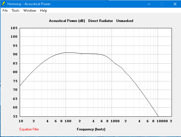

Once again here is the ultimax vs the 18h+ with the Box performance nuetralized/equalized
Comparing 2 different woofers in 2 different boxes is the equivalent to measuring two different compression drivers in 2 different horns (Hornresp has been updated since this 1-2 year old graph...I just cheacked it out to make sure these graphs were what I thought...the responses are within 1db of each other the Ultimax 1db higher than the 18h+ until AE drivers midrange ability takes flight)
Long story short....the 18H+ as an awesome subwoofer...and an awesome midwoofer. The qts difference is going to make a diff...the mass is going to make a diff...the inductance is going to make a diff...In the terms of accuracy...unless the 18h+ woofer is not rigid enough (it is) The 18h+ is going to be more accurate....
The point missed...some people don't like the sound of technically accurate deep bass.

This is what happens when you put them both in an equal size box that is slightly over 315l....might of been 326l IIRCThe 18+ example i posted used 49L, the Ultimax had a whopping 310L !
Make sense of that when just about every variable we are talking about has an affect on ultimate performance....Looking at the above ~326l boxes....using eq to smooth out mid sensitivity. is going to be detrimental to what? Or is it going to actually boost SQ due to lowered excursion.....Eliminating variables in comparisons is good scientific practice but when that variable affects the ultimate performance
Yet the two drivers with Ultimax with a ~Q 0.7 and the 18h+ with a ~Q 0.35 (looking at my 315 box in HR) and the roll off is the same... The sensitivity is almost identical so both drivers are "trying" the same but one is much more accurate in play.......why isn't your theory playing out?In a low frequency sealed box two parameters are very important Frequency of F3 (F10) and Q which sets the slope of the roll off below or how flat the alignment will be. The lower the Q the more demands are placed on the woofer to get it.
Two simple non detrimental filters.....do tell (these boxes are smaller than in the graph above hence the lower efficiency...the lower roll off is unchanged by eq...group delay went up ~0.3ms lol) A good change took place as the attenuating filters lowered excursion even further.You can most likely beat all of them into shape with enough EQ and power but that is hardly the best way to do it.
When looking at the the first graph where the box has been made a mute point....the true victor stands out....lower Q, lower inductance, lower mass driver, and higher efficiency win. The win for the Ultimax is Higher Xmax....for mycase....something that will never be encroached upon
Who ever designed the 18h+ is a genius in short.
