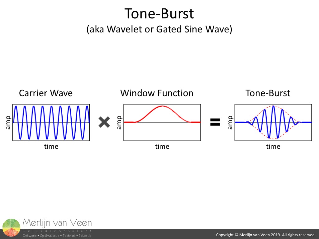

I read that all ready I see errors " Because a sine wave with an amplitude envelope applied to it, stops being a pure tone and becomes a group of frequencies " - a group of frequencies implies multiple frequencies...amplitude does no modulate frequency let alone create, multiples....
It is a group of frequency....minor error if understood I guess
attachment.php
So he says the picture to the right is a picture of frequencies ( a group of frequencies to be exact)....how many frequencies do you see?
Frequencies is the plural of frequency...
wiki-The human ear can recognize single sine waves as sounding clear because sine waves are representations of a single frequency
vs
Maybe he's talking about a tone burst in repetition? Or hes just messing up the terminology

The answer is in the article that you have probably misread.
"A perfect impulse in the frequency domain (figure 2.1), i.e., a single, infinitely narrow spectral line, requires a pure tone (sine wave) of infinite duration (figure 2.2), i.e., from Big Bang till the end of time."
The tone burst you are hung up on is short and therefore broad in spectrum. It is frequencieS and not pure.
Come again? a sine wave is a pure tone....His quote says that a gated sine wave is now frequencies...thats not true
so you are saying that a short (gated) sine wave cannot contain a single frequency?
I mean its a misuse of words, I can read through it lol!!!

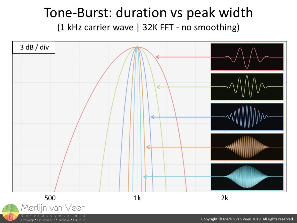

wait I found some more confusion...
attachment.php
Each of these on the right are supposed to be 1khz.....at first I thought the width had been expanded since the durations (width of each example) on the right side is identical....but some how the representation of the largest duration has the least amount of cycles in it....
I just don't know what is happening here....here does the longest duration tone burst have the lowest frequency when
Figure 4 shows several amplitude-modulated carrier waves. In all instances, the carrier wave's frequency (1 kHz) is identical
Guess I'll just keep reading lol!!!
Short bursts result in broad frequency groups whereas long bursts result in narrow frequency groups
Looks like he labelled the above graph backwards, by what he says here....and in that case...the short burst are only broad because he (or the program displaying the results) stretched them out....there needs to be a time anvelope attached to the examples x axis, then this will be clear
Notice that the width of the spectral peak which is no longer a pure tone but a now a group of frequencies
Correction, it is now a group of cycles, or even a group of amplitudes...
So in the video, the sound does appear to change frequency, perceptually...I'm not sure if that has anything to do with anything though. Maybe thats where this comes in?

Alright, now I see, I don't get it....but I see it.
Reading on....I feel like this is due to the distortion caused by group delay of the driver....when the cycle become too quick they (drivers group delay) distort the signal ie the distortion is revealed....otherwise it would not change...If we were to monitor the input signal it would likely reflect what I thought should have happened in the first place vs what the output actually was
I count 12 repetitions of the carrier wave modified by the time window function in the group of frequencies in the tone burst (aka wavelet or gated sine wave) in the picture to the right.
Merlijn Van Veen wrote:
"Because a sine wave with an amplitude envelope applied to it, stops being a pure tone and becomes a group of frequencies which is where the group in group delay comes into play. From here on, I will refer to that sine wave as carrier wave."
"Where the group in group delay comes into play", the group of frequencies to be measured or compared is conceptually important in his article titled "Group Delay 101".
exactly the carrier wave only has one frequency- 1khz
But why does the sine wave stop becoming a pure a tone??? I suggested above that it is distortion from the speaker but I don't know for sure
Frequency is the amount of cycles/time.....how does amplitude duration manipulate that? In particular, from a single into multiple frequency? My suggestion is that the driver can't perform correctly in the small amount of time...maybe someone can explain? I bet the input doesn't match the output.

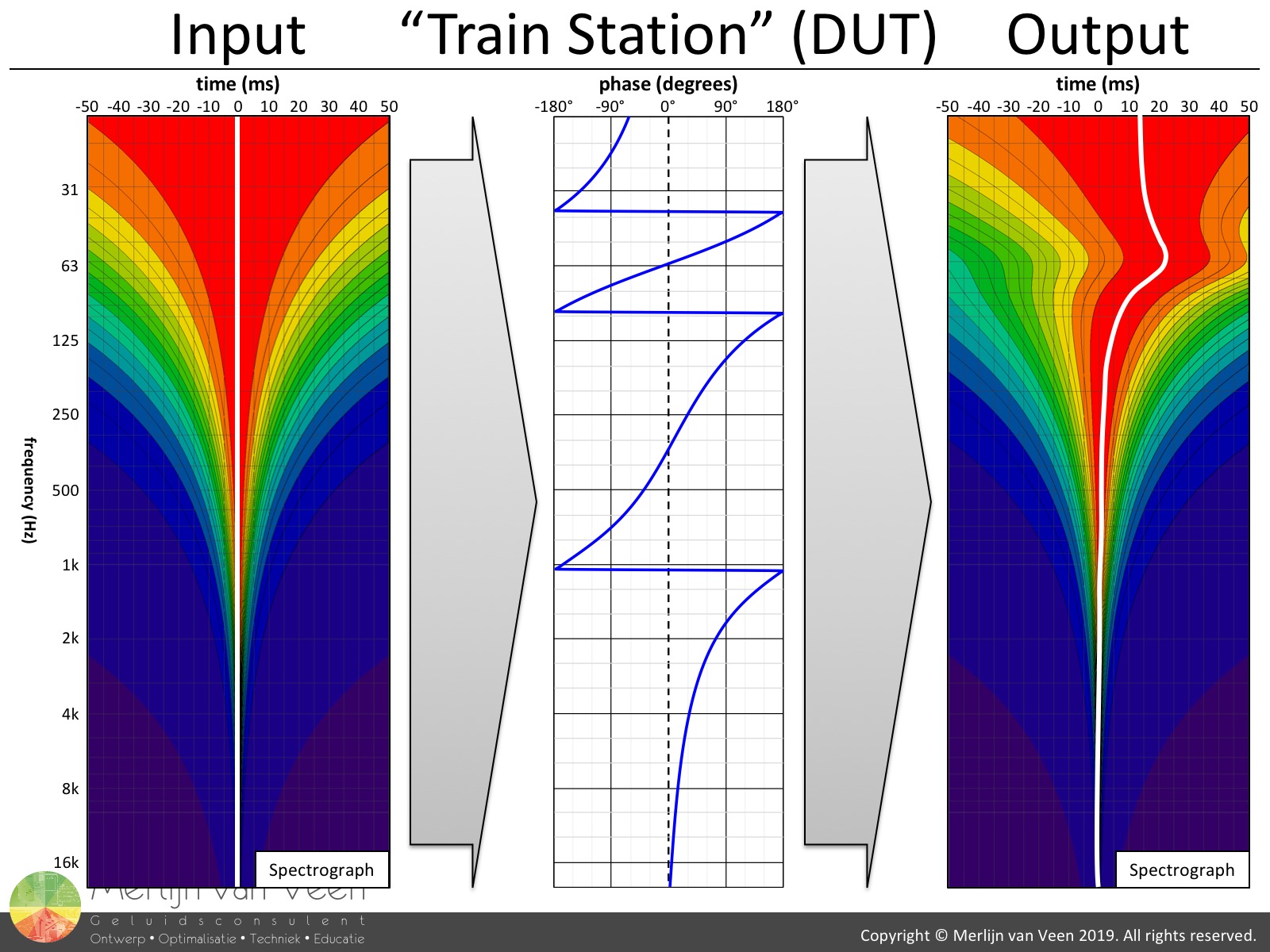

I said earlier that the electric signal does things the diaphragm cannot do. I said the input likely does not look like the output.
attachment.php
what the hell is a DUT....I know its meant to represent a driver here but whats a DUT
Oh its the "device under test"
So I really do know something? And I should have been saying phase delay this whole time...thats the best I've got so far......As well...the reason why a driver cannot play a tone burst that is too short is because of phase distortion as well....Unless someone disagrees....I have just leveled up.

Camplo, no offense but you are not right about anything, phase delay as you see it, etc, and more etc, ... the fundamentals are still beyond your grasp.
