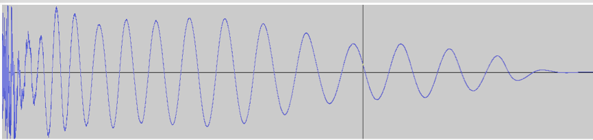

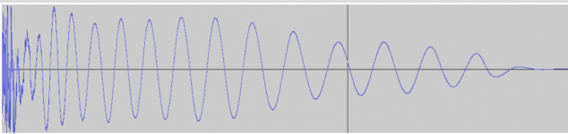

Post 6872 with the increasing period looks like the downward pitch swoop I hear on tight bass drum hits in some speakers. I use ZZ Top "Woke up with Wood" as a test track to sort out which speakers I don't want to buy for pitch swooping impulses.
While large enough group-delay distortion could inded make a downward swoop out of a short wideband signal (like turning a click into something like "peeeuuuu" *) I have a hard time to believe that speakers have that extreme group-delay distortion. But I will try it out with that song. I could even leave the speakers out and use a DSP to generate group delay until it is perceived easily on headphones.
Edit: I forgot to mention that natural instruments and our hearing do also have some intrinsic group-delay distortion. This may probably also cause a base drum being perceived as swoopier on a really wideband system without group-delay distortion than on a LF restricted one ( "defrauding" the lower parts of the spectrum) with group-delay.

40ms delay is slapback echo length, if your sub is trailing by that much, you definitely should be delaying the mains to match.
The noisy high frequency transient attack of a kick drum (real or 808 generated) leads the "melodic boom". In the example below, the time between the initial transient and the first of the smaller amplitude "boom" is about 15ms, with a 60Hz fundamental dropping to 30 Hz at the trailing end.
As far as keyboard delay, 20ms will mess with your timing, put you a 64th note behind at 180BPM ;^).

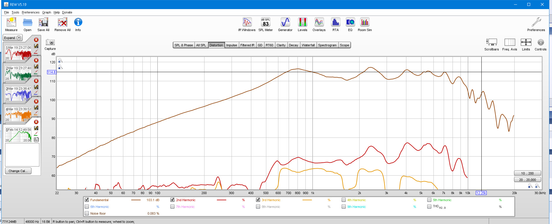

2435HPL is really nice from 850hz and up, but I can't get it sound right no matter what crossover or WG I used.- isn't this a nice driver already? Do you think the drivers you suggested are an upgrade??
