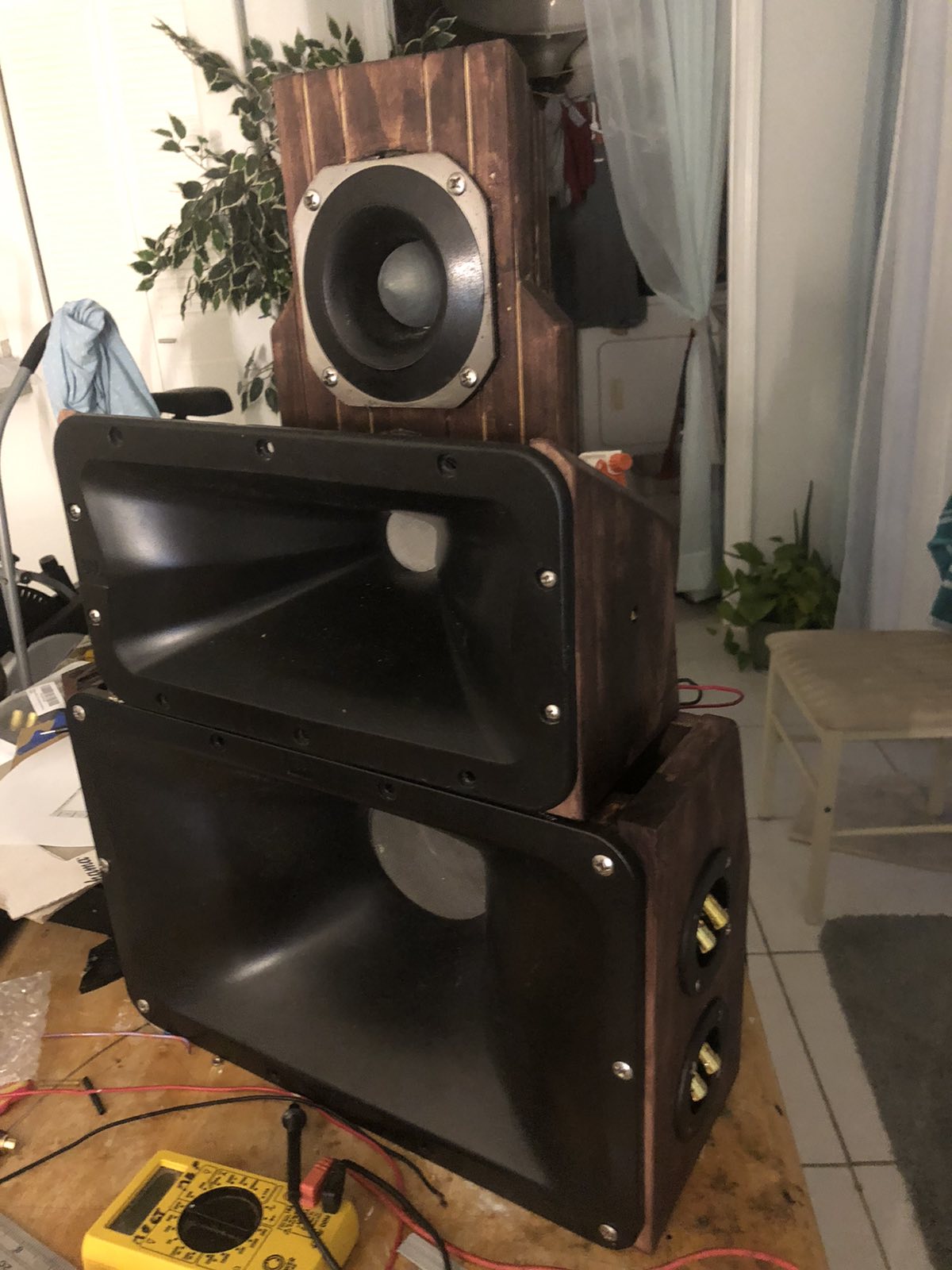

2435HPL sound fantastic in 2384WG but it require supertweeter and the size of that WG is huge. After one of the JBLs got damaged I delete all measurements and don't want to go there anymore. Now I'm looking for more compact solution. 800-900hz and up will be nice. 3 way. This was my last mid-high setup. Obviously not a 2 way))), sorry for OT.
Yes, I will use a subs below 120-140hz. I have 2 JBL 2241 and 2 AE TD18H for it.

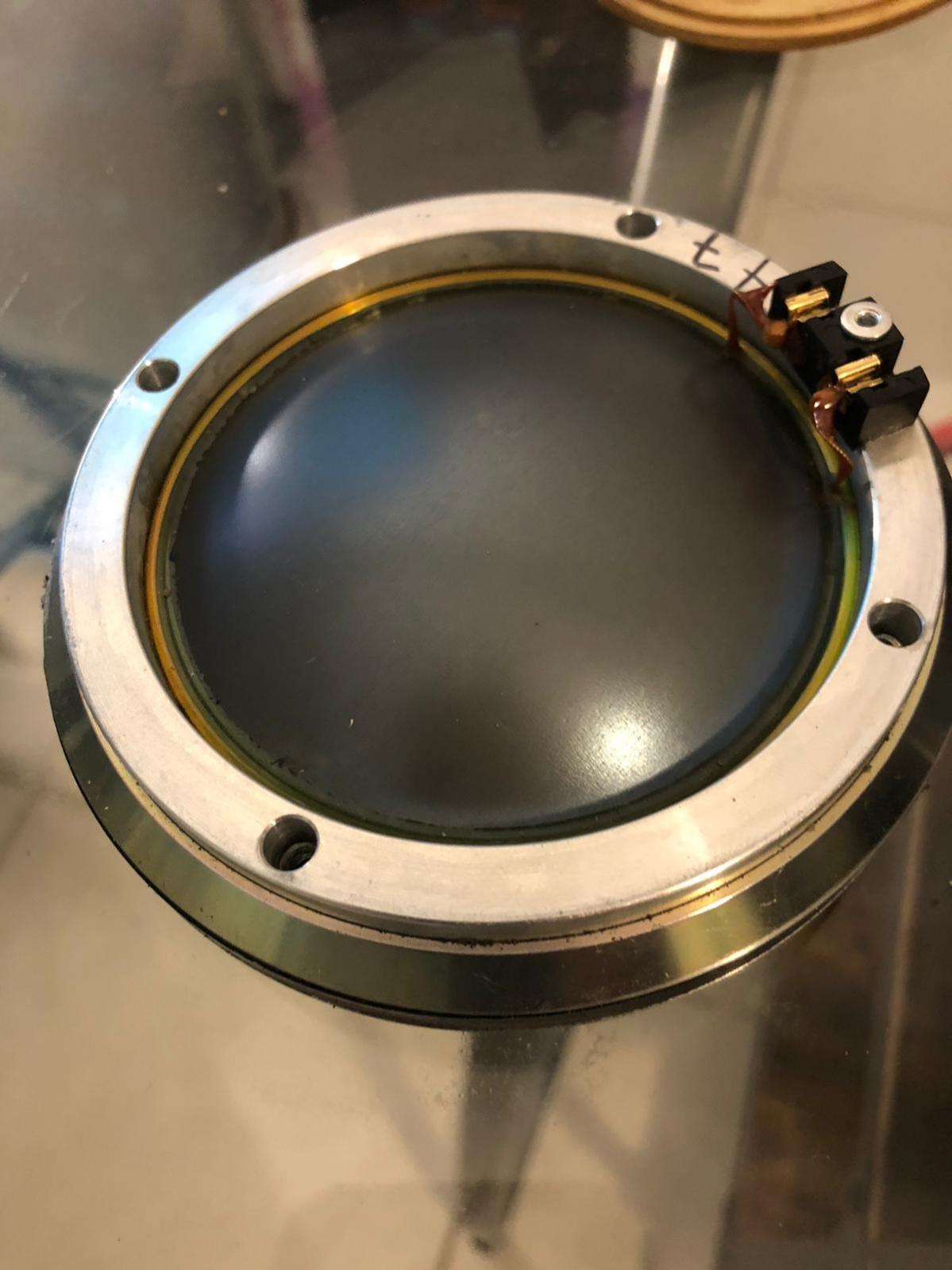

The driver was damaged when some truck hit our transformer and create Big Boom. I can't figure out how the diaphragm should be replaced and don't want too - spent too mach time on them. They are fantastic drivers in 850-7000hz, but hey never produce decent highs above that no matter what I tried. Cheep 1" drivers like DE250, Celestion, or Renkus Heintz are better in this region.
Maybe I did something wrong, but for now I'm just tired of them.

The thing is the diaphragms are NOT the culprit of your HF issues....the compression driver they are in....ARE....if you find the right home for those Diaphragms (and buy a new one to replace the broken one) they are going to perform better than the replacements you choose...
The guys on this forum will know if those diaphragms can fit into another CD and which one to choose...

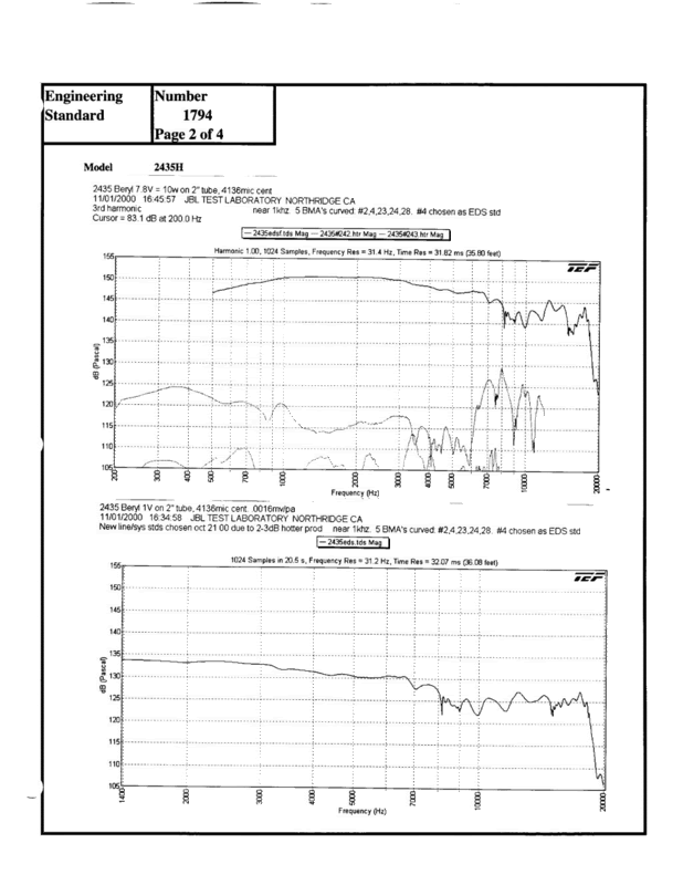

The top end of the 2435HPL is its weak spot, notwithstanding (or due to) the Be diaphragm.
Yes and the phase plug is so short and with no throat it is very finicky about the horn/waveguide used. Some have added a 1/2 spacer between the horn and the driver kind of like a 2432 to form a short throat that has helped in some cases.
When used in the Vertec cabinets it's 3 per and they get a DSP boost upper octaves.
You can get decent last octave response but it's not easy without loosing too much overall SPL @ crossover.

The 2435HPL has been analysed thoroughly on audioheritage.
The driver was indeed specifically designed for the Vertec line arrays.
In 2002 Doug Button published an AES paper highlighting the development of the 2435HPL and its application.
