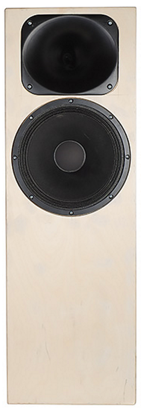

For those interested in building a 2 way system with 18Sound drivers:
- 15NMB420 + NSD1095N + XT1086
- 12W500 + HD1050 + XT1086.

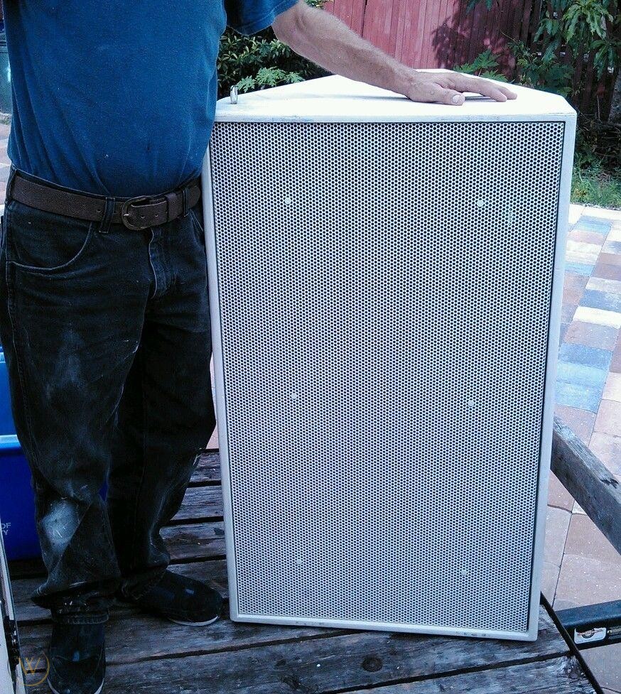

I'm currently at KLIA airport and spotted these. Bass driver is 15-18", the horn is quite a bit bigger. Anyone know what they are?
It took 1.7 years to solve this mystery.

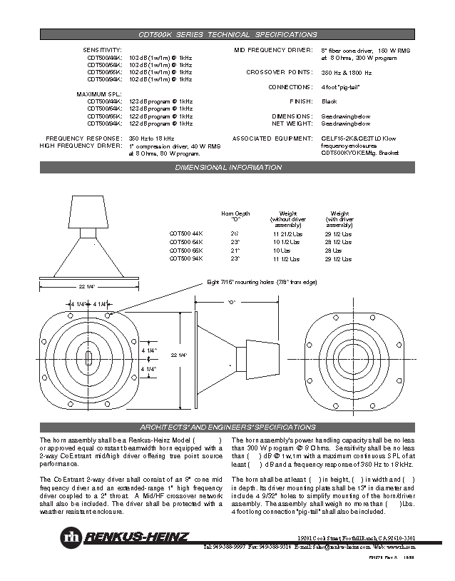

No wonder because these large full range cabinets are Renkus-Heinz Special Order CT-Series > 1st pic.
These were also available in asymmetrical trapezium shaped cabinets.

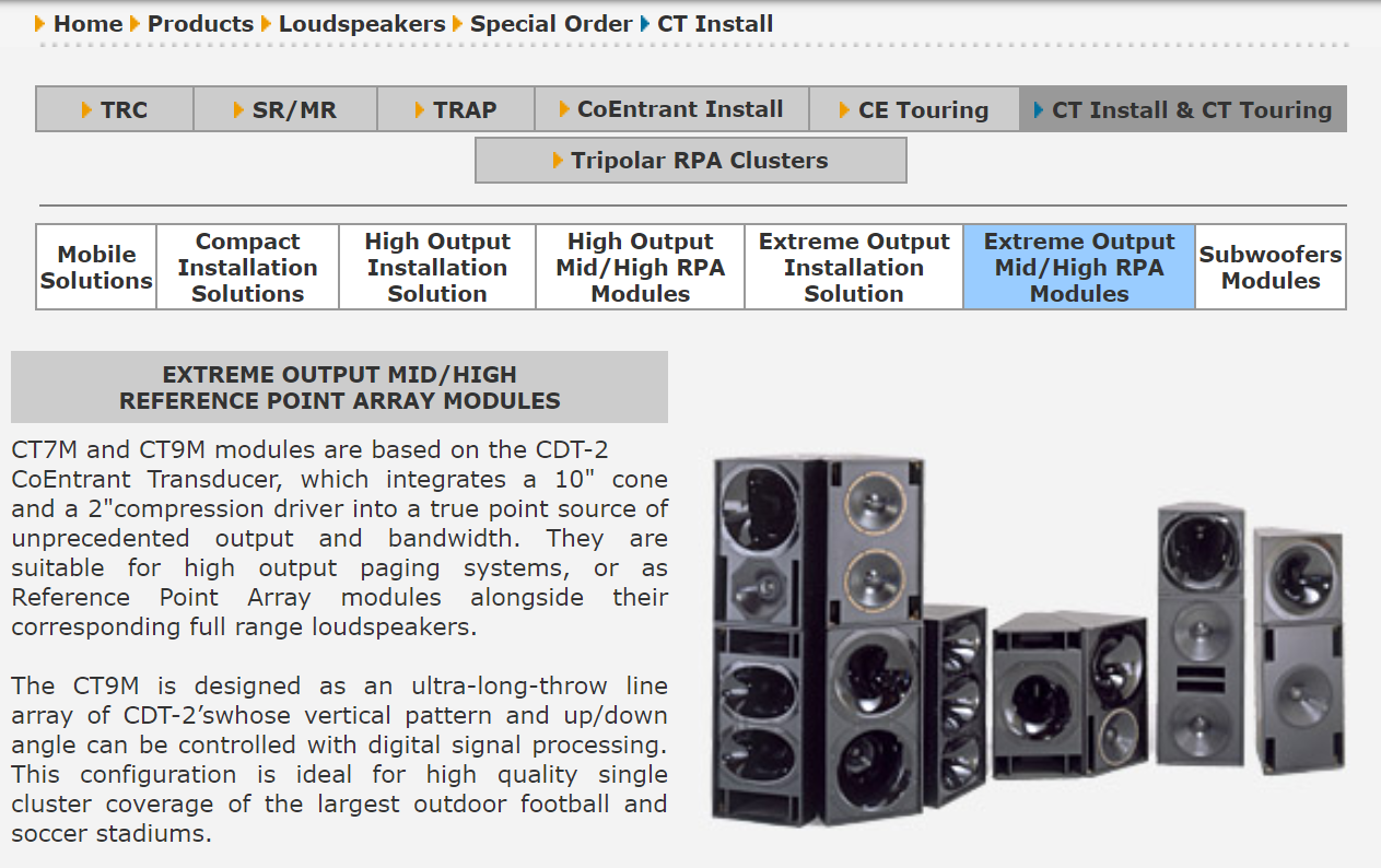

The Co-Entrant Horns in these full-range cabs are the best iteration of the technology. There were 2 versions, 1"+ 8" (CDT-1) and 2" + 10" (CDT-2).
Both were available in a variety of cabs, some with direct radiators.
For those who consider a point-source system, but cannot or don't want to buy Danley Synergies, a pair of CT5MH/66k mid-high tops is currently offered on ebay.
It's basically a 60x60° CDT-1 in a cab.

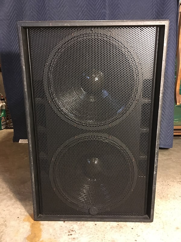

Add a pair of 2x15" Renkus-Heinz subs (used for about $200 each) to complete a full-range system with a point-source horn to cover the vocal range and up.

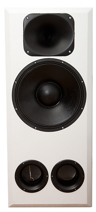

I say definitely to the OP question. I had an old pair of ESS/Heil floor standing speakers, using a 10" midwoofer, a round Heil AMT, and a 10" passive radiator.
I rebuilt them into a roughly 2ft x 2ft x 15" 2 way cabinets with the passive radiators on the sides. The cabinets have 1.25" walls, and a 2.25" baffle, heavily braced and lined with 2" denim insulation on all walls.Rebuilt xovers and new wiring. They play 39hz to 21,000kz. Have almost zero distortion, even at loud levels, and are 95 db efficient.

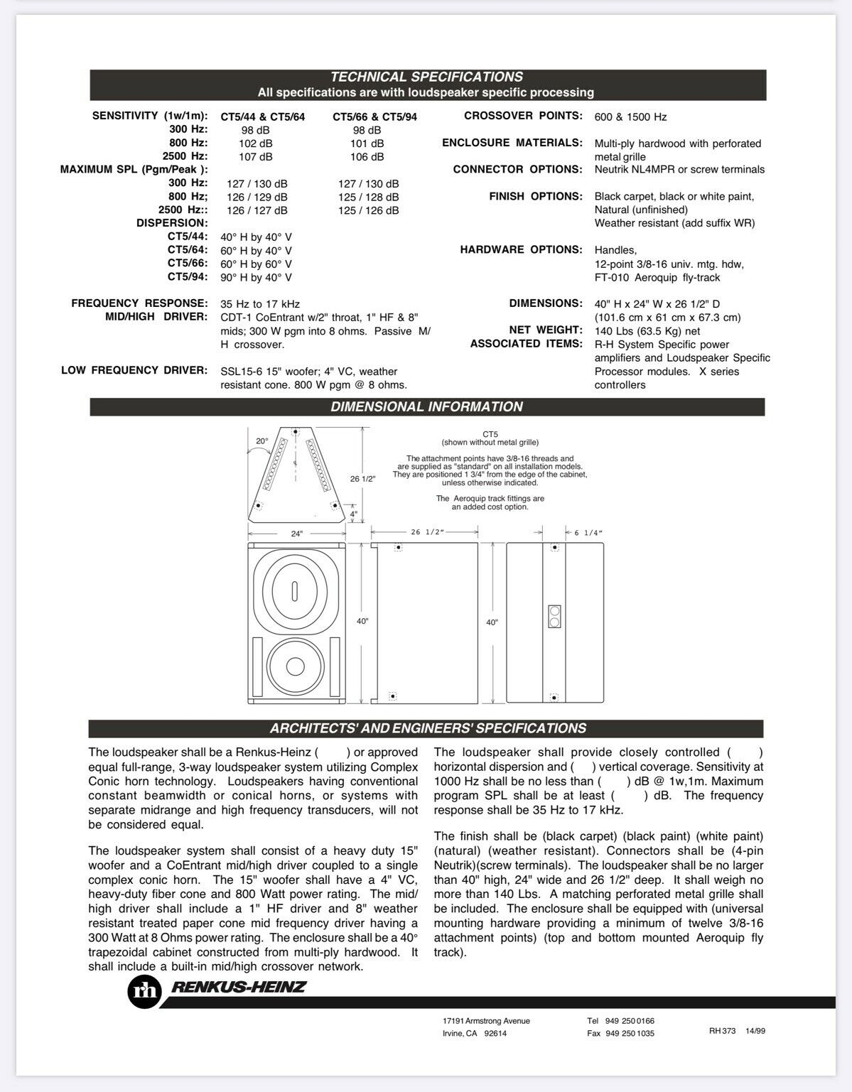

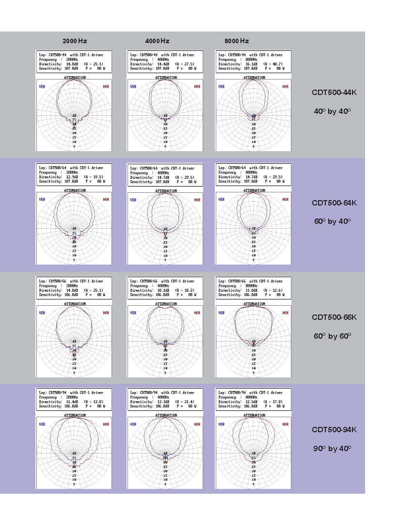

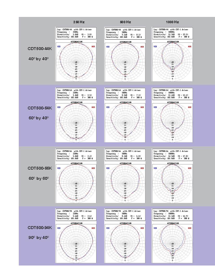

Any measurements on these?
The balloons of the 60x60° are shown. DI is fairly constant, probably the best of all variants.
I'll check my files for some response plots.

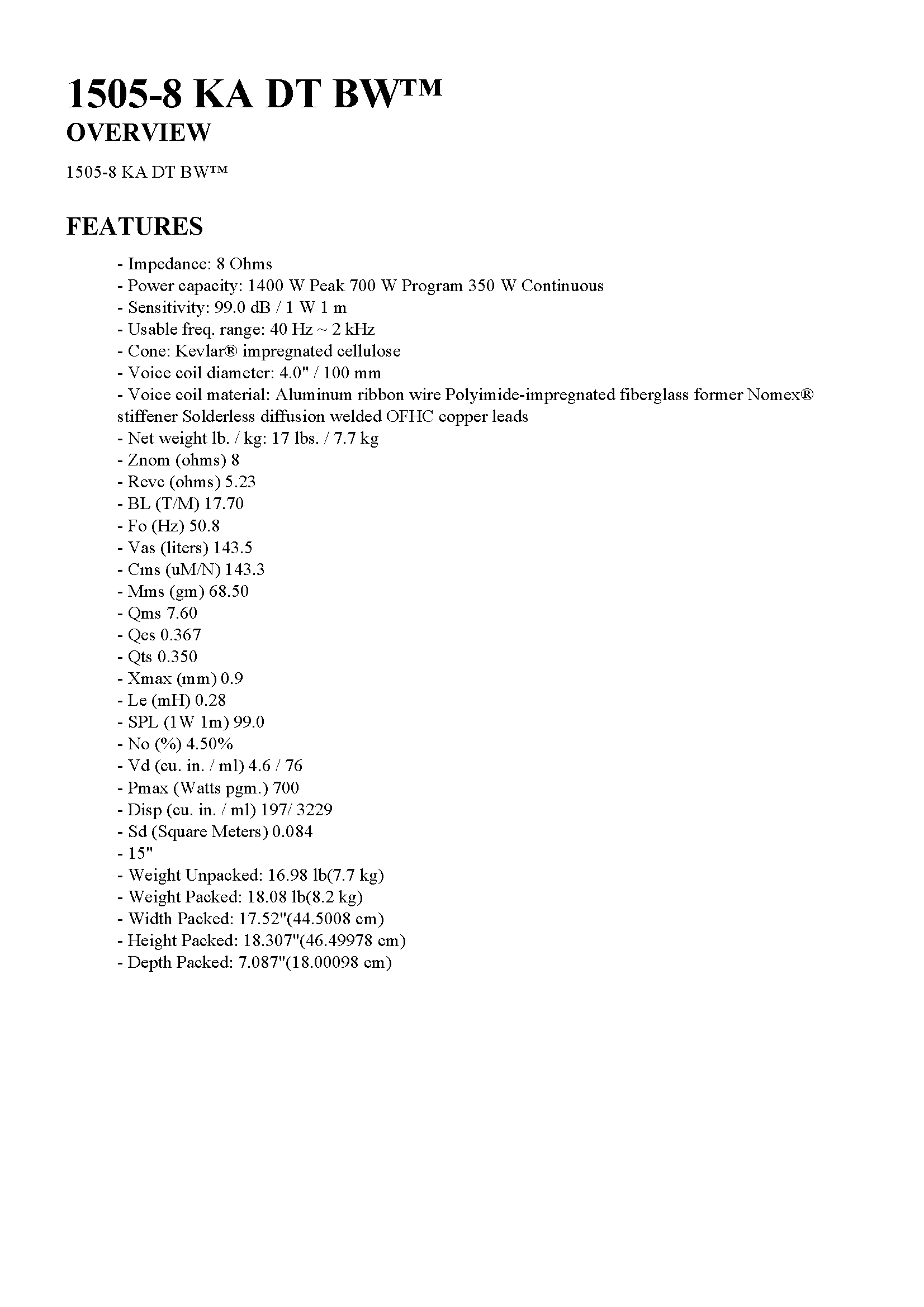

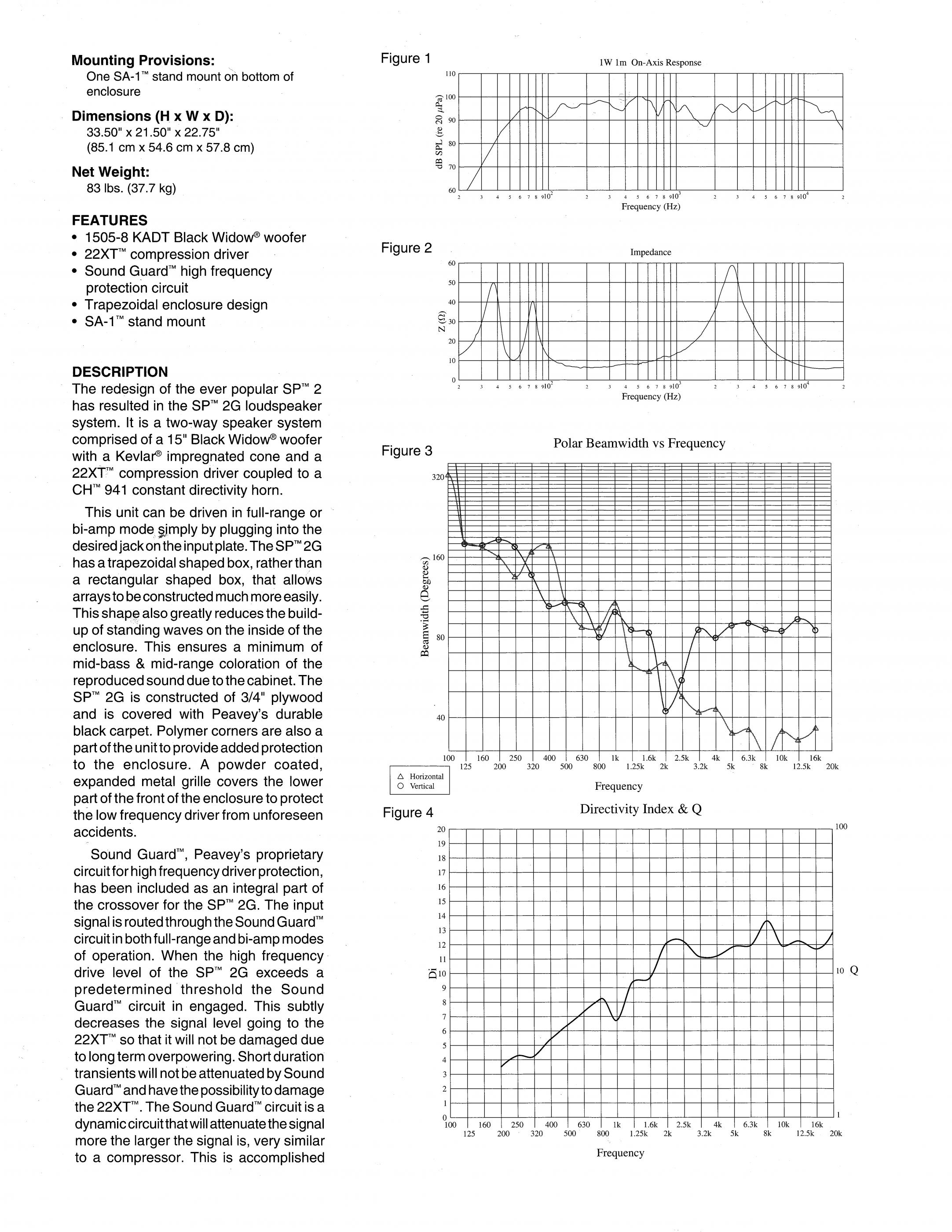

Eminence suggests a frequency range appropriate for typical use of a driver designed with TS parameters appropriate for that use.Eminence tells me I can't use a Delta-pro15a below 54 hz.
Fs 42 hz, qt .4, vas 8.6 cuft.
I want to go to 27 +- 3 db. Is the limit because 27 hz would rip the surround at 400 W? Could I use it at 100 W from 25 hz to 1000 hz in an enclosesure tuned for 25 hz .
Yes, you can use a PA driver designed for mid-bass in a box below it's Fs. It will not have "flat response", but could be equalized to any response you desire.
In terms of this threads topic, "high SPL, low distortion" you left out important specifications of the speaker, Xmax (4.3mm) and Xlim (13.65mm).
Around 1/3 octave above Fb (box tuning) a 15" driver with 4.3mm Xmax can produce about 101 dB SPL, about an order of magnitude less than the 110-114dB definition of "high SPL" at 1 meter in post #5.
Driven past Xmax, harmonic distortion will increase rapidly from around 10% to 100% or more, not low distortion by anyone's definition. Driven to Xlim, the driver will make very un-musical sounds.
A big box will require less power to drive the speaker past Xmax, but will put out more SPL down low with less power.
The Delta-pro15a surround is capable of 13.65mm one way travel, with most music program material, it's voice coil will burn before the surround will rip.
