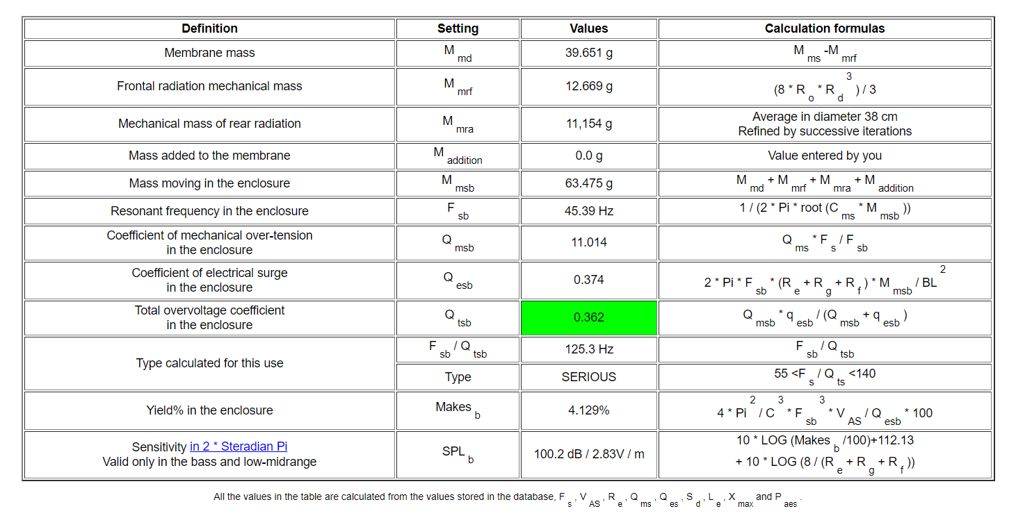

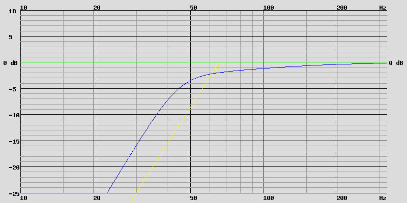

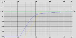

I had a similar question...basically...how to judge Q of vented design or rather why doesn't the sim software predict Q at tuning for vented designs...I figured one way is to measure it with DATS.
You mean Box Q?
I use the French online calculator and verify the sim in VituixCAD.

In practice, the tuning and damping can depend on several factors. The above example illustrates a low xmax midwoofer in a slightly oversized cabinet with port tuning slightly below Fs.
The intended response is imo ideally suited for an average European room.
Depending on the parameters of the driver and the application, you can opt for a specific alignment. The Q is just a hypothetical value and doesn't tell us much about the actual driver in a specific cabinet in a specific room.
