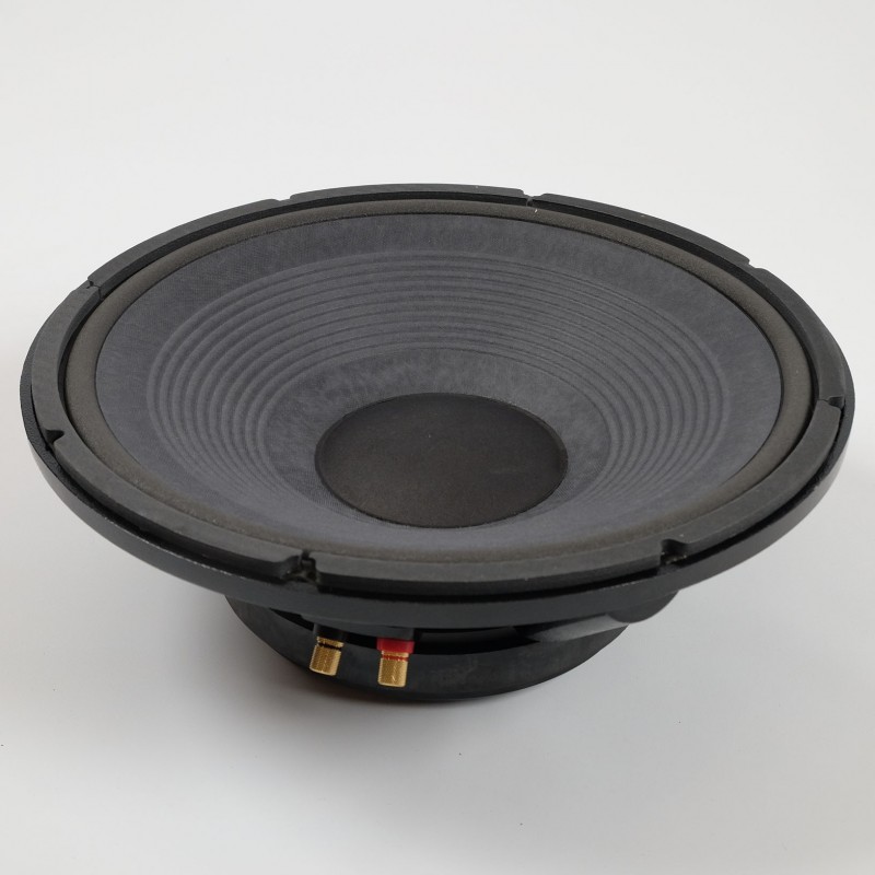

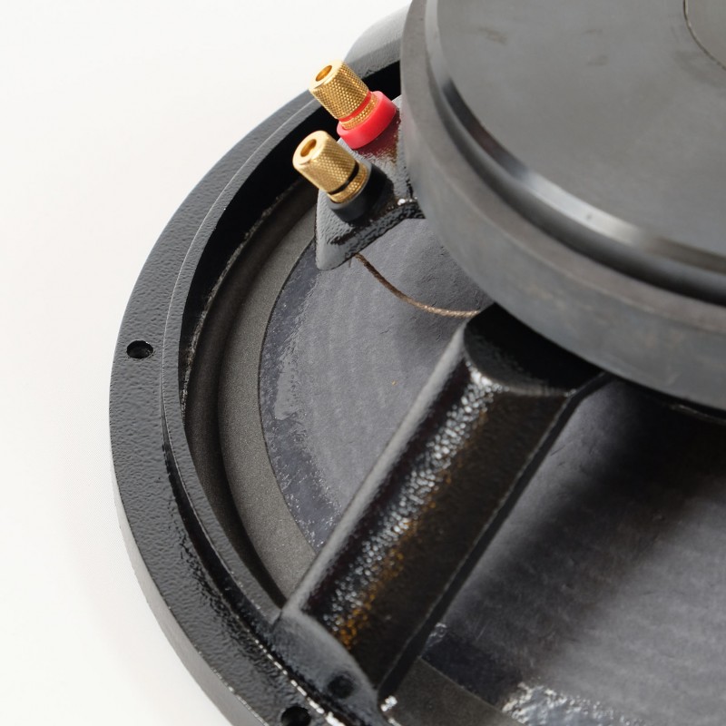

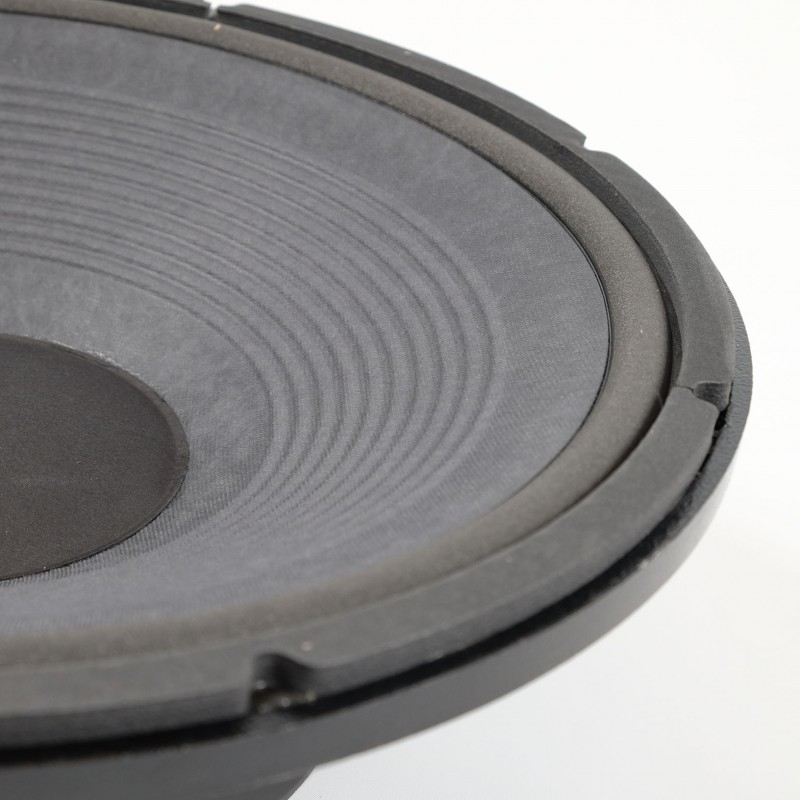

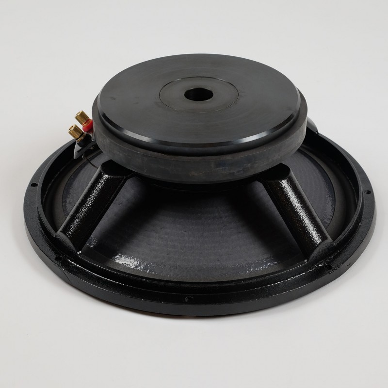

The woofer used is a rather esoteric and expensive one (€ 910,00).
The cone and foam surround resemble those of the famous JBL 2235.
T&S:
Nominal impedance Z 8ohm
Mean sound pressure level 98 dB
Resonance frequency fs 25.5 Hz
Rated power 200 W
Outside diameter 390 mm
Total Q factor Qts 0.26
Equivalent volume Vas 530 L
Electrical Q factor Qes 0.29
Mechanical Q factor Qms 2.53
Dynamically moved mass Mms 72 gr
Compliance susp. (CMS) 0.54 m/N
BL 17.29 N/A
Weight 10 Kg
Diameter of the motor 224 mm

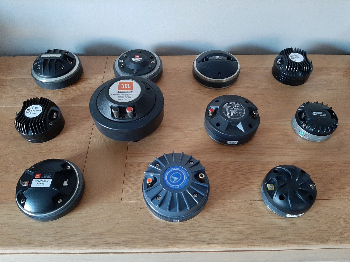

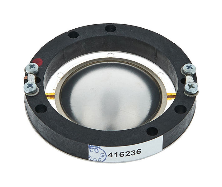

I recently tested some 2425J drivers and I'd guesstimate that you'd go with a 700Hz crossover on a horn that big.
Their claim of 21kHz extension is marketing magic.
13-15kHz is more realistic:
The 2425Js Are SWEET!, but what Horn did I get? - Page 3

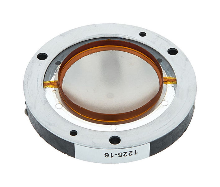

The JBL 2426J - including a Radian Alu diaphragm, was tested by another Frenchman:
Was there meant to be a link here? I'm curious to know the results.
for me it is an outdated compression that is history.
500 Euro is a ridiculous amount for this driver.
Yep. My pair were salvaged out of cabinets that I picked up cheaply. I wouldn't pay the price they cost new.

Here's the 1" comparison, including the 2426J (in French > use translate).
I don't think any of the vintage JBL drivers are bad, quite the contrary. But somehow JBL is synonymous with expensive over here.

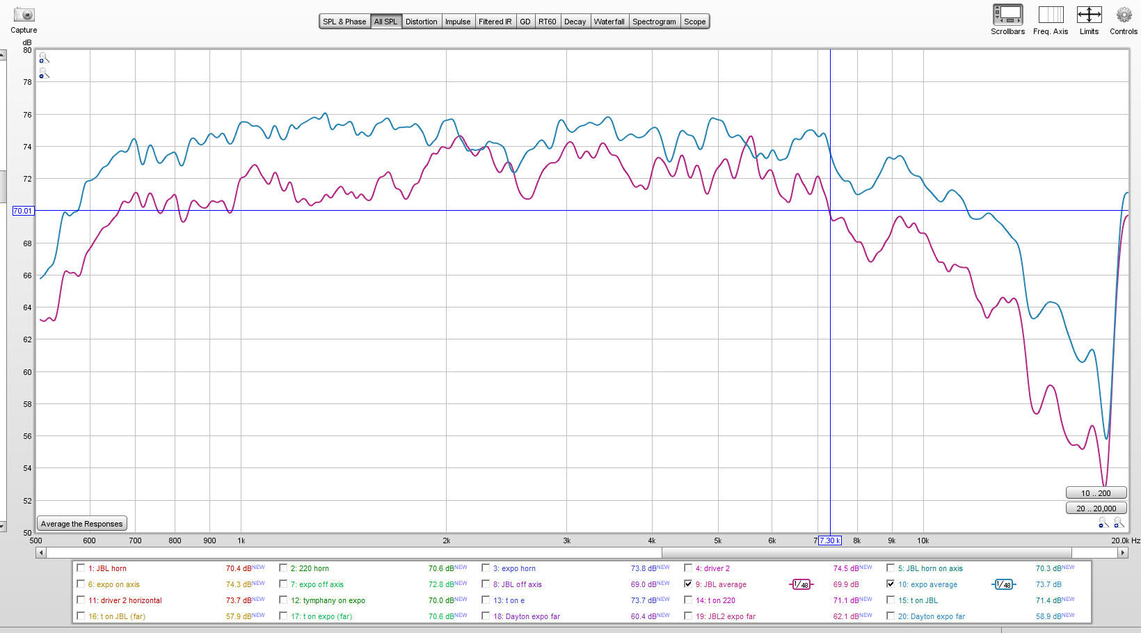

I have also measured several drivers on that same horn (I tried the JBL vs some cheap new units).
Mine show a similar HF rolloff to what they measured, but they are less in need of eq, so I guess I will stick with the diaphragms I have.
I should, however, open them up to check for grit / rubbing.
Image: blue line = response on the cheap expo horn (vs the JBL 2370 horn).
This is 1/48 smoothing and not on a baffle. Putting them on a baffle will add another couple of dB at the low end, and make them more usable for a cross <1kHz.

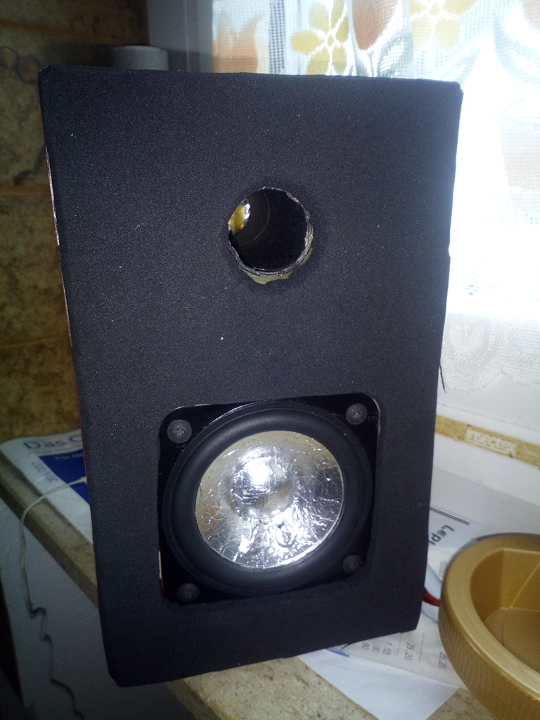

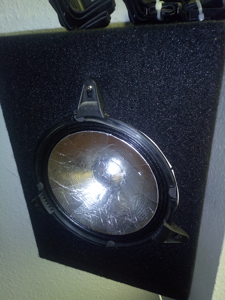

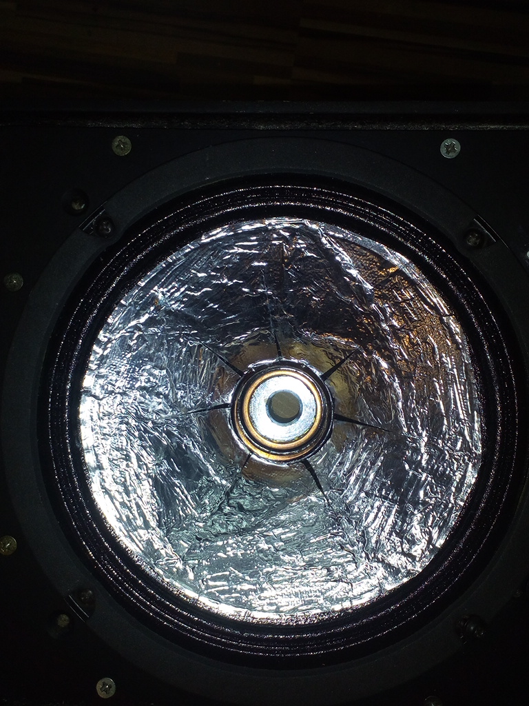

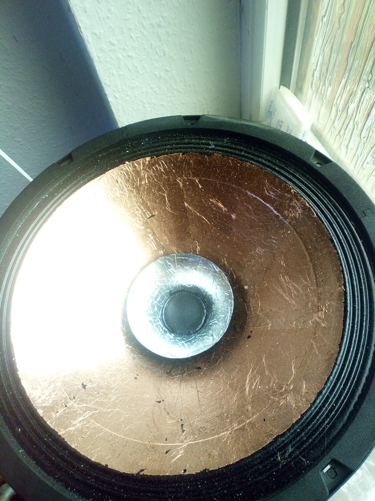

Here some work I did for myself - paper cones with aluminium foil.
For design purpose you can also use copper foil - looks vintage alike.
Aluminium has in my eyes a space age look.
I even grabbed a bluetooth speaker and tweaked the diaphragm.

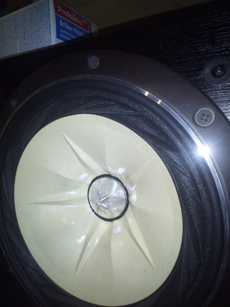

I think the future of diagram building can be seen in the Axi2050. The idea of "micro" sculpting the geometry in the favor of SQ. I imagine a 3d printed diaphragm with some kind of geometrical bracing within its printed structure. Resin(epoxy?)+paper pulp is probably hard to beat is my guess. The different print materials may provide some unique options and being able to print a diaphragm with some kind of geometrical bracing (honey comb or some variant) may create this light and rigid goal we are looking for without the high cost of material.

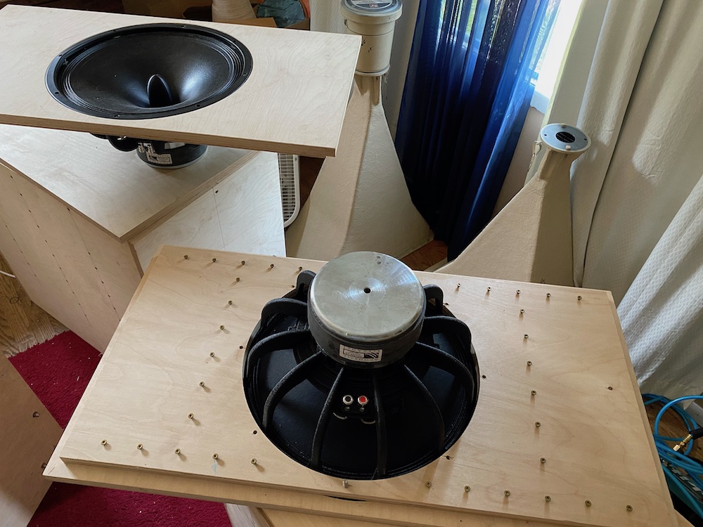

I don't remember if I showed my mid woofer, front baffle...its just two panels glued and screwed...smaller panel fits snug inside the enclosure inner dimensions. I have to attach the back/front baffles on all enclosures and then nothing is left to do but install connectors...damping material and a finish. Hopefully I can get some measurements up tonight or tomorrow...cutting this damping material will be a chore.
