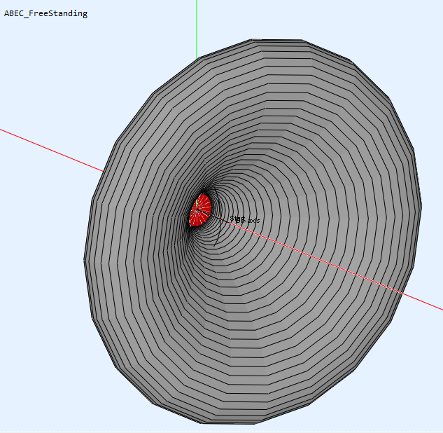

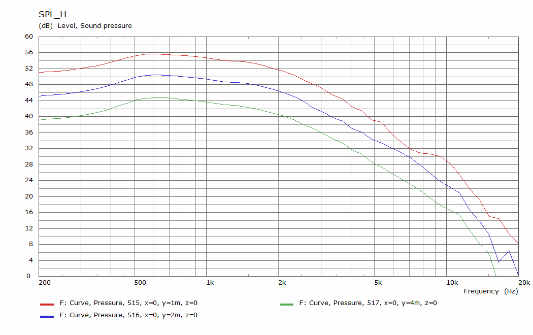

As part of a previous difficult discussion I made a BEM simulation of a horn at 1m, 2m and 4m as you can see by 2m it is pretty much settled and falls at a nice rate of 6dB per doubling of distance thereafter.
What this also shows is that the measurements should be made at the intended listening distance. The difference between 1m and 2m is obvious 2m and 4m not so much.

I don't remember exactly but it would be around 450 to 500mm. You can see from the graph the same things that Pat Brown is talking about, that it is the high frequencies that need the extra distance before they settle down to a steady level. Up until 3 to 4k the level drop with distance is already settled between the 1,2 and 4m simulations.
