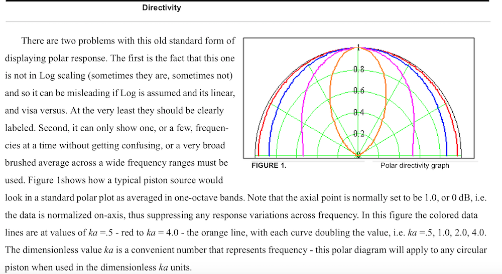

I only know Ka from the pages on directivity written by Geddes. So in my mind I see the chart available there, where Ka=0.5 (iirc) is the level at which dispersion covers a full 180 degrees (or at least very close to it)...
Figure 1.6 shows a graphical demonstration of where the ‘flat’ response comes from. In practice, this seemingly perfect on-axis response is compromised by non-piston diaphragm behaviour and voice-coil inductance etc. Even with a perfect, rigid, piston for a diaphragm and a zero-inductance voice-coil, the flat on-axis response has limited use; the piston directivity function in Fig. 1.5 tells us that as frequency increases, so the radiation becomes more directional and is effectively ‘beamed’ tighter along the axis.

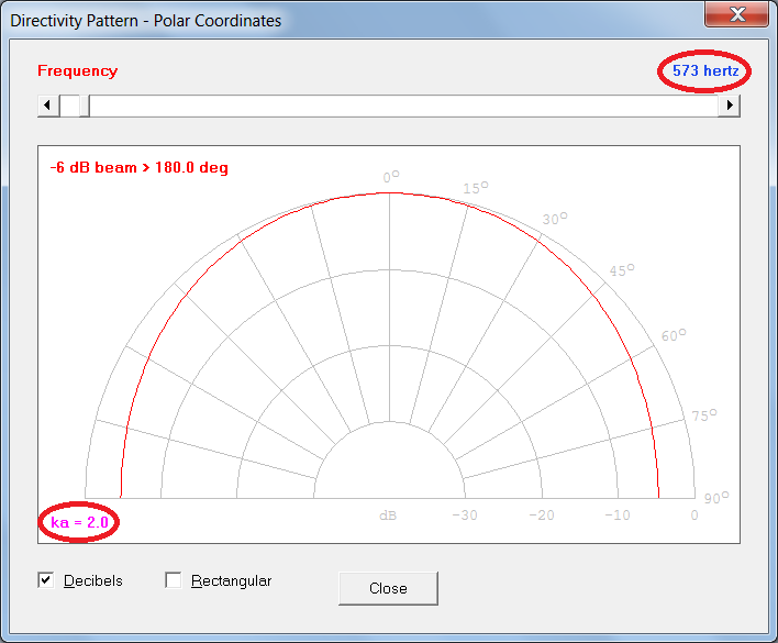

Ka=2 for a 15" driver is 573hz....
2149.6hz for a 4" driver...
Limiting the driver to only being used when it is completely omnidirectional is not practical in all cases and not desirable always either.
For a plane circular piston source, ka is the wave-number k = 2 * Pi * f / c multiplied by piston radius a.
Using camplo's example of a 15" driver at 573 Hz:
ka = 2 * Pi * 573 / 34400 * (15 / 2 * 2.54) = 2.0 (to one decimal place)
Yes sir, Seems like everyone has same definition and math for once :)
