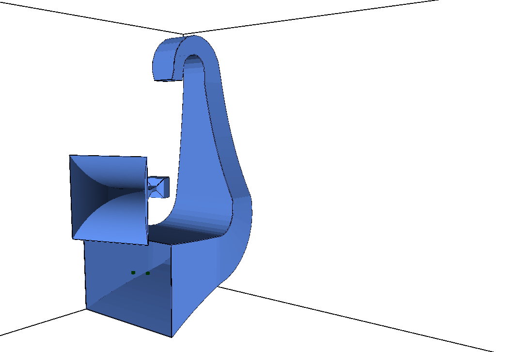

OK here are separately. Windows are not exact but close. Why are you concerned about separates when the system will be filtered and combined? JBL uses it @ 800Hz I went a bit lower to 700Hz or so. Depends on how you define cutoff. 700-750 is right on the knee so I am pushing things a bit.
Looking at 700hz...unless its due to the filter... its pretty clean yet. The horn is slightly cleaner than the woofer, decay wise. Not drastic....yet if the the 700hz area is the cutoff of this horn, it is supporting a part of my idea that a horn, even at tuning, can compete with a dynamic radiator.
Well the underlying statement was pointing towards the idea that a bandpass system has more sound quality than a strictly sealed or vented enclosure. A synergy is a bandpass device. So we would be comparing the synergy to sealed or bass reflex/TL to make a point. Anyone have any CSD data on synergy or similar?
...And don't be surprised if he replies in the affirmative, or says: "Inspired by investigative journalism".
Moreover, Holland & Newell's most important publications were used as source material for his own authoritative book.
