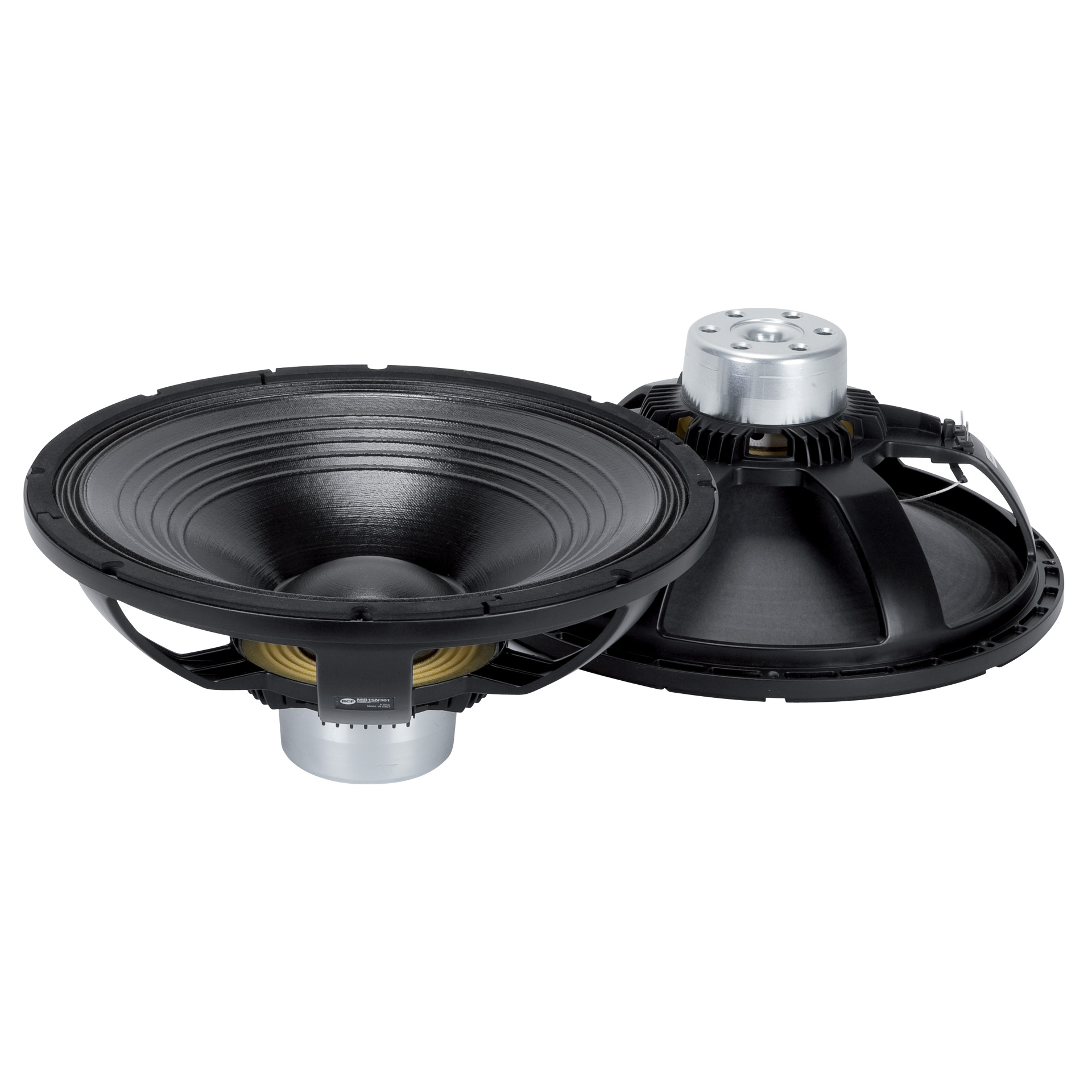

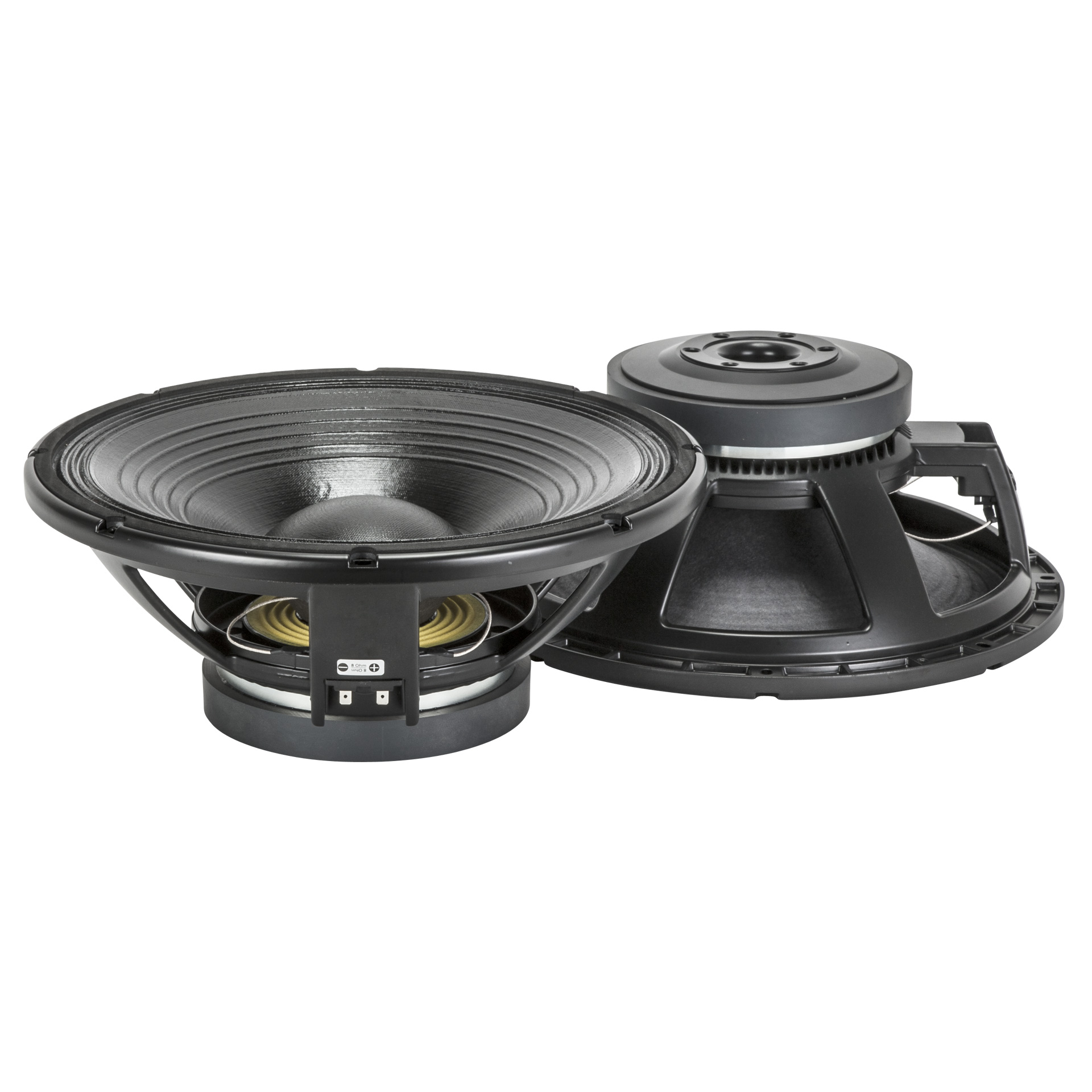

It's the Neo version of the MB15X301 which I recently recommended to krivium.

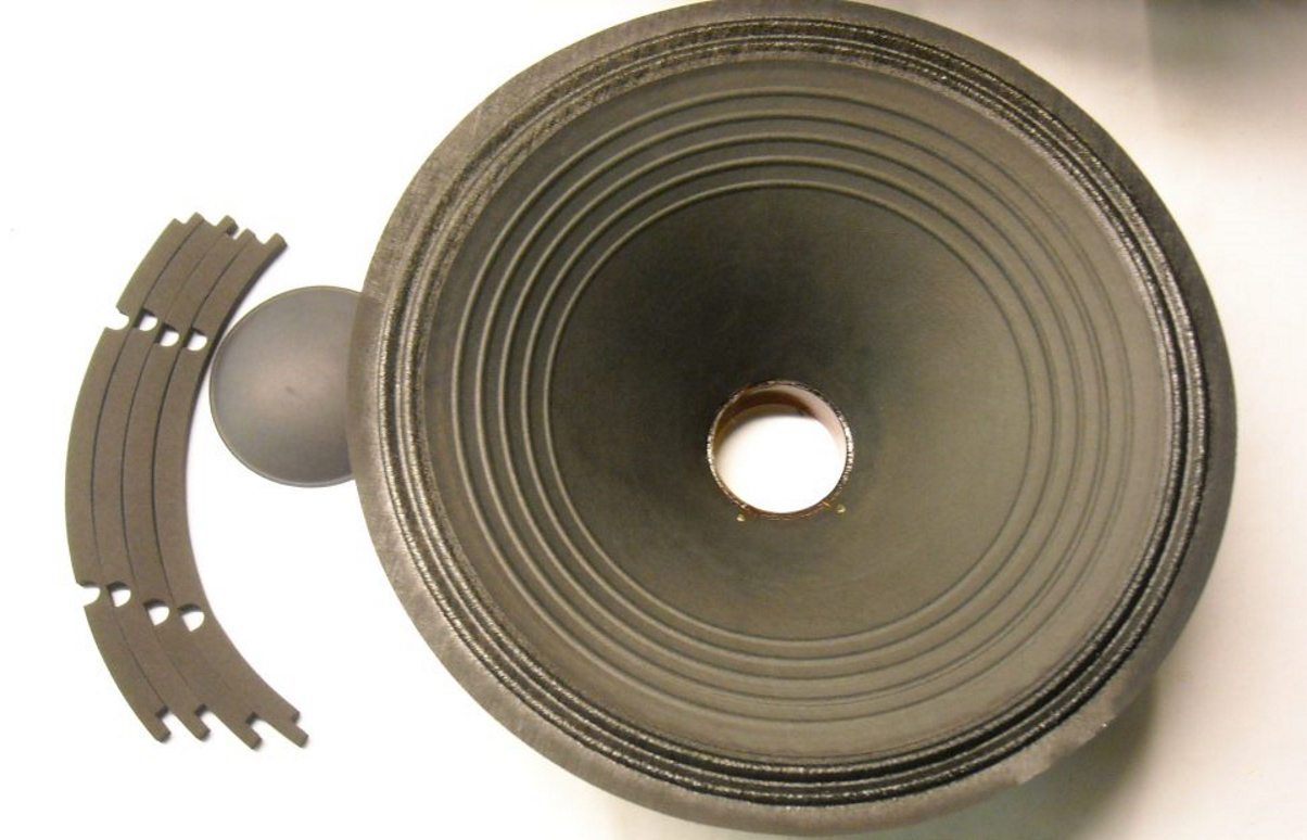

The corrugated curved cone has been used by RCF for decades.
My vintage drivers have the same type of cone, only about 40-60% lighter (see attachment).
The N301 and X301 still tend to have a rising response due to increasing efficiency with frequency, albeit to a much lesser extent due to the heavier cones.

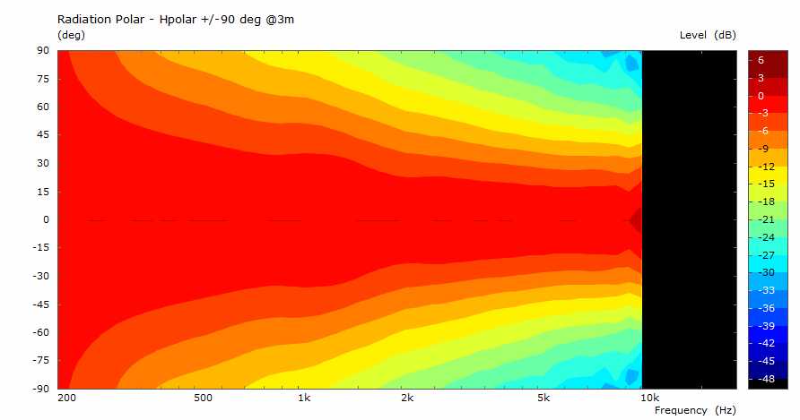

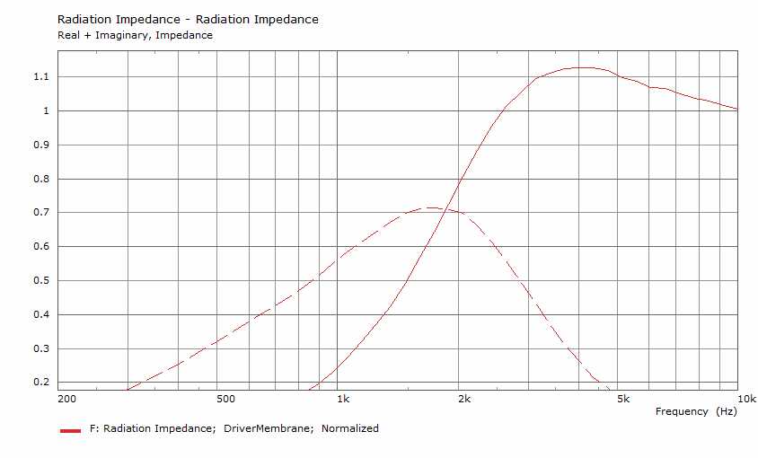

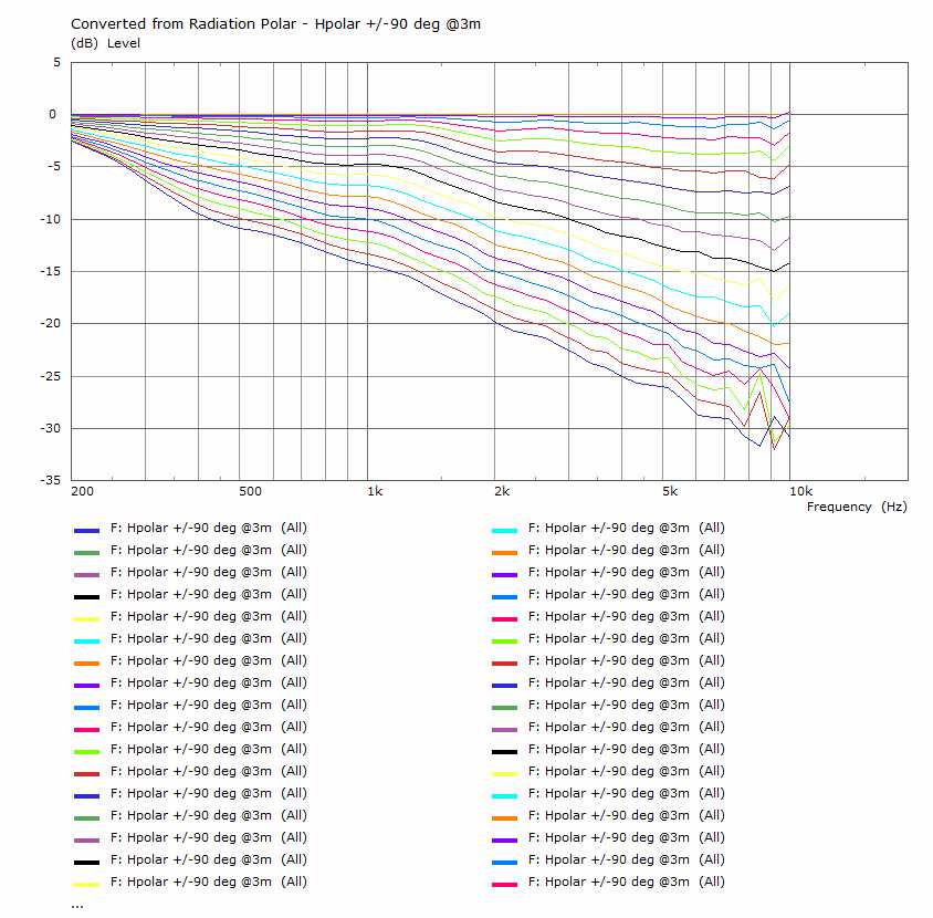

This is much better than the native SWH profile but what about radiation impedance?
There's room for some improvement in this respect. The horns (simulated by Don) should effectively load the driver from about 920 Hz. Probably just enough for a powerful 1" driver and a crossover frequency of around 900 Hz.
