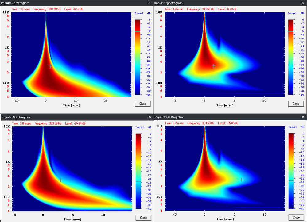

Doing my best here, work with me...Sims are a sort of compression driver mock up on a 300hz JMLC vs a 15" woofer in a 231 enclosure.
So its a matter of 3ms more decay and ~3ms bump in group delay that makes a horn not fit to me used down to its Fc....

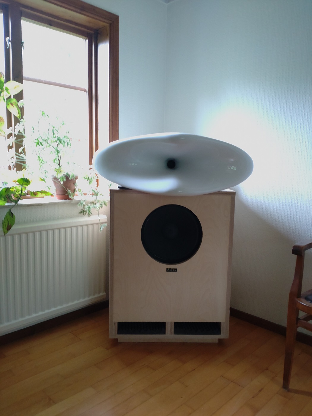

I run a 2-way that is pretty much full range. When i moved into the house i was set on making a full 4-way, dsp assisted system and started with the 2-way that i envisioned as the heart of it. For bass duties in that 2-way i use my trusted GPA 416 in a 280l BR cabinet tuned to 30Hz after some port flow restriction. Above that i run a TD-4001 in a E-JMLC 300 horn. I used these horns at my previous place and there they where placed very far from any side wall and worked fine. In the current house they where not happy at all as they had to end up a lot closer to reflecting side walls. I tried many different ways of fixing this, both with EQ, crossover, room treatment etc and it was not until i jammed them into the corners that they started to sound balanced.
They do cover the spectrum from 30 to at least 16k but do beam a little more than i would like over about 8k. All i have to do now is to build some new corner cabinets.
//Anders

When you say that they "beam" more than you'd like....could you elaborate your experience please
Well, if I am sitting where I "should" it is not a problem but the room is big with more than one place to sit and enjoy music and as it is I can't get the right tonal balance at various places. I do have two different settings in my DSP that I can shift between but I would rather not.
