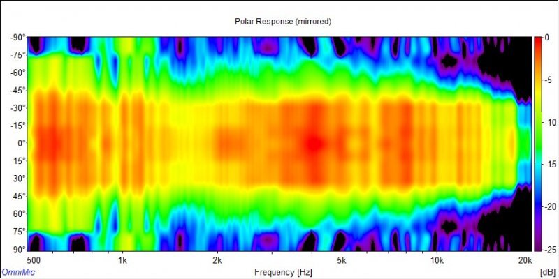

Here
The importance of Kms(X) and BL(x) for mid-ranges
is an interesting discussion of theory and towards the tail end of the "meat" you'll see a common denominator of Low excursion being the epitome of SQ. Nothing new but, it is King. Vented designs do help lower excursion and make this 2 way goal a reality. All of this being a focus on music....The expectations people exhibit if you mention the words "sub bass" tells me that they are serious about getting below 30hz regardless if "upper sub bass" has been handled....Without getting into that, my point is low distortion of even 30hz is going require.....low excursion....I just pointed out above that THD will permeate all the sound being produced even if the excursion causing it is not seemingly suffering....Get it?
You can produce acceptable bass at higher thd levels it seems....but as soon as you let that driver incorporate midrange into its output, the excursion from the bass is going to be a problem. This is whats going to make or break your goal of reaching the full range 2 way dreams....from here you have driver SD, Xmax, TMM/MTM, vented cab, and complimentary subwoofers, as tools to thread the needle of success...and allow me to say Yes to the titled question.
The best advice I've received in this thread was from....(?)....who told me to not allow any driver handling mid range exceed 2mm ....and Gedlee who said, see it move, see it distort. Combine that with the necessity of a double bass array, more/less, the multi sub approach, to achieve linear FR response.....if we null that out of the equation since its true for everyone usually...then again a large 2 way is going to be choice, to sit on top of the status quo sub bass system for SQ.

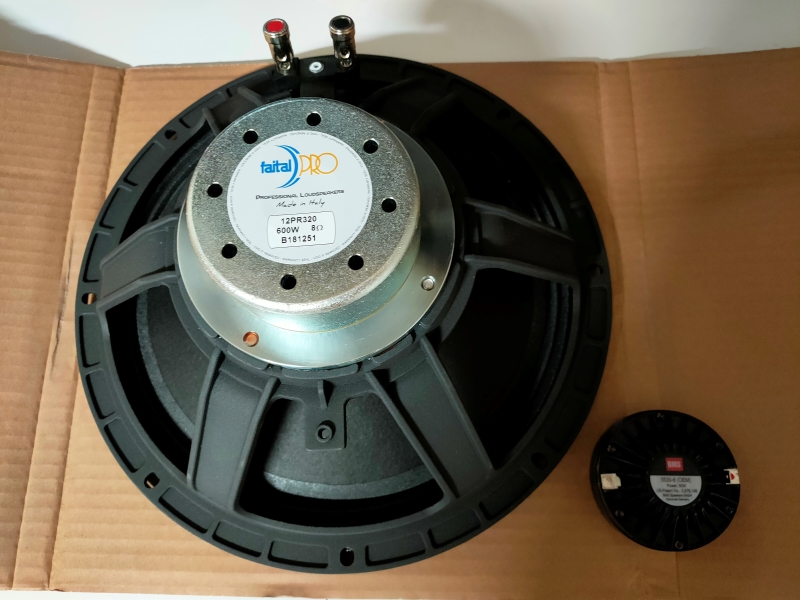

The 12PR320 is the obvious partner for a 2 way that is almost full range....

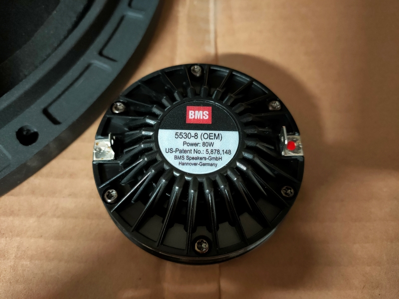

I would definitely opt for the much more recent and advanced 5530ND
Consider your advice taken 😉
The 5530 is really quite small.
If the 12PR320 is as good as the 12PR300 then it is a hell of a woofer. The sound is incredibly natural and organic, very very linear, extends well in the higher midrange. Useable for high fidelity applications well into 2Khz or so. The powerful magnet, and stiff yet very light cone, make for a very precise and transparent low mid range. Bass is tight and clear, with good intelligibility.
I have indeed a 2-way with Faital Pro 12PR300 paired with a modified Beyma TPL-150H. I added subs, up to 60Hz. The result is stunning.
