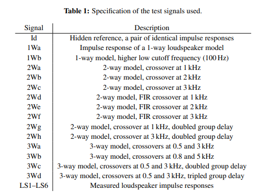

The impulses used in the study were both real and simulated and were either from real speakers or designed to resemble possible speakers.camplo> I think fluid's plot is showing how much GD is necessary to be subjectively different, the frequency band shown is probably arbitrary and not relevant.
The frequency band is not arbitrary and is a very important part of the research it gives an idea of what amount of group delay at what frequency resulted in no audible difference in the tests.
If the group delay between 300Hz and 1K and above can be kept below 1ms then there should be no audible problem resulting from it.
Between 1 and 2ms in that region then it might be audible, but if it gets above 2ms then it is almost always audible in reversed testing.
Below 300Hz the group delay can get quite high quickly without much audible penalty based on this study.
So they tested other bands?
I'm not sure what you mean by testing other bands. The full frequency response of the impulses was tested and the amount of group delay in those impulses vs frequency plotted and compared to whether the forward or backward versions sounded the same or not.
Some impulses were convolved with another filter to make them "Pink" and the differences in the pink impulses were easier to hear.
I see. I thought they were just adding GD to a narrow-ish band around 400hz and seeing how much it took to be audible. If that is (essentially) the case, the point I was trying to make was they could just as well have picked 1.5khz (or whatever) and there was nothing special about the 400hz they used. My impression was that camplo was pushed to move the crossover higher based on those plots and their arbitrary selection of the 400hz area to use as in the test.
300Hz to 1k or so is probably the critical region to keep low as that was where the differences were noticed. Below 300Hz the group delay can rise, above 1k would need a fairly high order IIR filter to add enough to be audible.
This is the list of test signals
