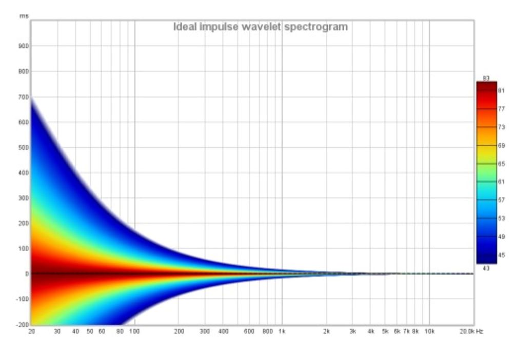

Does that answer your concerns about negative time area in CSD mode? The above graphs are from basically an ideal source. So every note is instant, no group delay and from zero to infinity Hz. (well almost)
I created that Dirac pulse with RePhase, and so could you. That could serve as study material and an the example of the illusive ideal.
Thank you for trying to help me understand...
If you look at the the Dirac...nothing is happening before 0ms...
What the heck is happening in the negative time space on the CSD! lol
Yeah but do either of you understand the negative time area of the CSD in wavelet mode![]()
What is being done here is to "expand" the impulse in a special set of functions. When these functions are wavelets, which are symmetric and get wider as the frequency gets lower then the wide wavelets get extended into the negative region - more and more as the freq goes lower. It is an artifact of the chosen set of functions (what is called the basis set.)

Now if you chose a different set of functions, say damped (complex) exponentials, which are not symmetric (this set are called a Prony expansion,) this will not occur.
FYI, the Fourier transform basis set are sines and cosines of infinite extent, which leads to an altogether different artifacts to the expansion.
Maybe a bit too mathematical, but none the less, it is the answer.

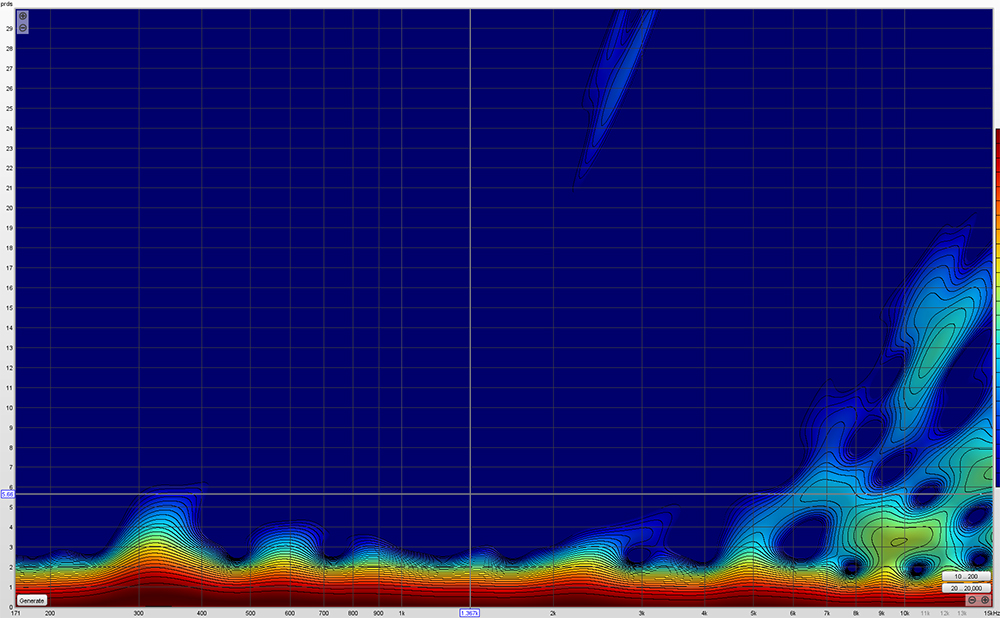

I do agree that a compact impulse response is the goal. I don't like to see late arrival stuff and I worked very hard to minimize them. Basically this comes down to - primarily - the frequency response being flat. But occasionally one can detect small artifacts that have little influence on the FR, but can have a big effect on perception. At least that is what I have found.
I showed how the usage of foam in the waveguide decreased a small ripple in the impulse tail, while having little effect on the frequency response. I belief that this ripple was a late arriving HOM that was damped by the foam. There is a significant audible effect.
- That part, I wanted to be able to say that this system is going to be an awesome tool for Eqing....in order to eq properly I need accurate perception of whats there.small artifacts that have little influence on the FR, but can have a big effect on perception
How bad did I do? Whats the bad news Doc....as they say
So it is in one sense it is still a FR problem, just a FR in a different point in time (later) for the "same" acoustical event (the stimuli). Its (almost) all in the FR...

If the impulse contains any acausal elements from linear phase filtering then they will still appear on the negative side as pre-ringing.Just to make sure I see you, full circle, I can literally ignore everything on the negative side of this view?
The Burst Decay plot is affected by the window and the time zero used in the settings.I think my assumption about Burst Decay beginning at peak energy is correct then, See Markkkk![]()
