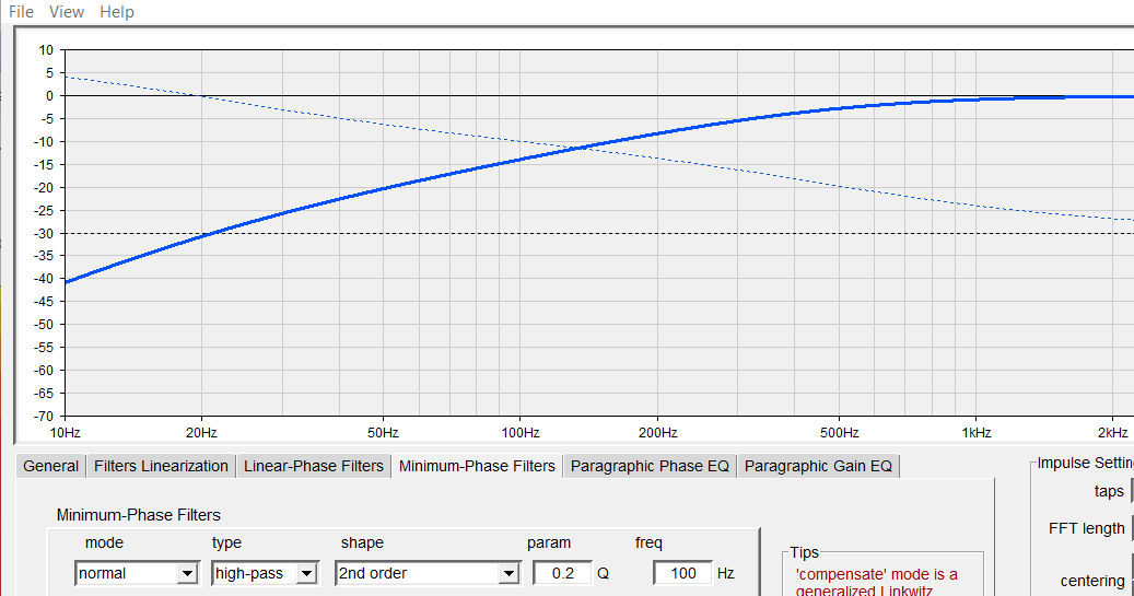

You can look at this yourself with rephase example of settings below.They stopped at 0.5....should of kept going to like 0.1 to show the trend.
FR issues can be adjusted with Filters, I am more concerned with other factors of over dampening that may occur....Dynamic compression and a loss of low level signal?
Those step response shapes cover the whole bandwidth, the sharp rise is high frequencies. A woofer or mid will not look like that with a crossover. So they can be misleading to look at without considering the context.
Lowering the Q puts increasing strain and power requirements on the system so going below 0.5 doesn't make much sense. With a second order Q of 0.2 look how high the rolloff starts, increase the Q of the filter and that moves back down.
This also comes back to time and frequency being linked. The flatter and more extended the frequency response is the better the step looks.

Unless you plan to use the rolloff of the midrange in the cabinet as part of the crossover the Q of it is irrelevant as it will be completely modified by the crossover and EQ.I am focusing on my midrange, the dual 18's do the extending. The mid will be high passed at say 80hz.
The diagrams you posted are related to low frequency rolloff.
There it is again...you can't change damping characteristics with a filter. You can copy the natural roll off of other Q's but Qes/Qms are unchanged...
You can’t adjust Qtc or fs with a filter. Linkwitz transform is a sort of equalizer that simulates changes is Qtc and fs, but the actual electrical parameters for the woofer do not chance. You can add series resistor, add mass, remove mass or add magnet to really change parameters
