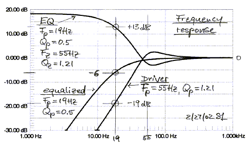

Yes. The time and frequency domains are linked if you change the frequency response the time response follows and vice versa.
Make it a homework project with rephase. Generate the high Q box as a filter, import to REW and look at the step.
Make the corresponding filter to match the desired Q, convolve and look at the step.
So another way for me to see this is that the only way to achieve 0.5 for example.....design towards a Qtc 0.5 but I can't use any low pass filters because it will change the Q?
If I change the "Fc" with a filter I bring the negative of traits of F because the filter is going to cause ringing....so you can't truly "high pass" Fc out of the equation!!!
Its just a bunch of high pass filter knees....you get rid of a lower filter knee just to add another one higher up the band.....
That would of been useful thinking for this thread too ->The importance of Kms(X) and BL(x) for mid-ranges
End goal....shape LF roll off in that of the 0.5Q slope......Raise Fc until excursion is miniscule....Walla midrange
Not sure where that leaves me with Qes though....it would seem that since we are forcing the driver to do what Qes would have done, its a non issue but....it just seems too simple? At least Qes still is a independent and critical factor factor right??? Somehow the goal involves creating the response as efficiently as possible I can be assured....A higher Qes raises midrange sensitivity so I guess a low Qes is still desirable

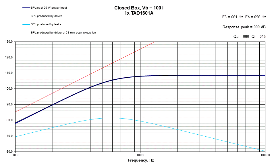

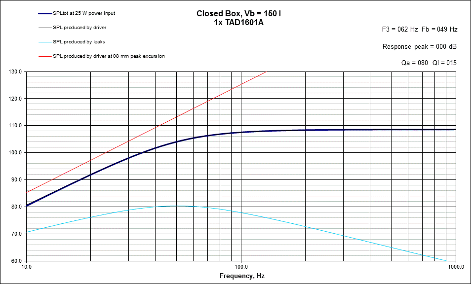

Is that true? According to the model, a driver in a 100 l box has F3 = 61 Hz, which is comparable to the driver in a 150 l box, with F3 = 63 Hz. The former box has Qtc = 0.656, the latter has Qtc = 0.576.
Yet, with the same 25 W input power, the latter box - with the lower Qtc - has about 2 dB higher output below about 100 Hz where it starts to roll-off, cf. the attached figures.
Could you please comment?
Kindest regards,
M
Lowering the Q puts increasing strain and power requirements on the system so going below 0.5 doesn't make much sense.
Kindest regards,
M
