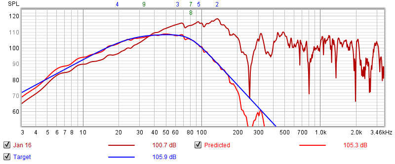

In yours that is the caseA 24 dB/oct low pass at 100Hz, (above the 80 Hz you mentioned)....needs but a little attenuation to bring the peak down to curve.
And the notch is entirely inconsequential.
But for camplo the dip is at more like 270Hz, which is not terrible but not ideal either. As you say putting the drivers on either side of a box of whatever size keeps all the main benefits without the air mass cancellation.So imo, a PPSL or any dual opposed sub, is very viable and desirable, steep xovers or not.
A 12db/oct low pass at 21hz on a sub to knock the response more flat is a little bit of eq? I would call that beating the response into submission with a ton of eq. I don't mind the plan, CD waveguides often utilize a 6ish db highpass set at 10-20ishkhz for similar purpose, but calling it a little bit of eq is quite a stretch.and a little bit of eq....

um When I can get a result, be it the anechoic version, thats +\-2.5db or so with just 3 filters...that is, a little, eq.

Semantics I guess. Flattening your beginning response can be done many ways. All of which call for a difference of what, over 20db of some form of eq to get there? Even if you used a single filter to do it I would still call that a lot of eq. I must have missed fluids solution. Apologies for not following this thread word for word.
No, absolutely not...as duscussed, what I did was similar to gain used in a Linkwitz transform..... Fluids iteration did not have 20dbs of gain but,...as you say, the semantics are neither here nor there...lets analyze the results.
Even with the gain boost that you are speaking on, you must conclude; no drawbacks...I posted measurements, no issues.

I do believe camplo's design works just fine with only a 24 dB/oct low pass...IF he will use the box as a sub. (crossed at around a 100Hz +/-)

Pretty conventional EQ with either a little boost or all cut
