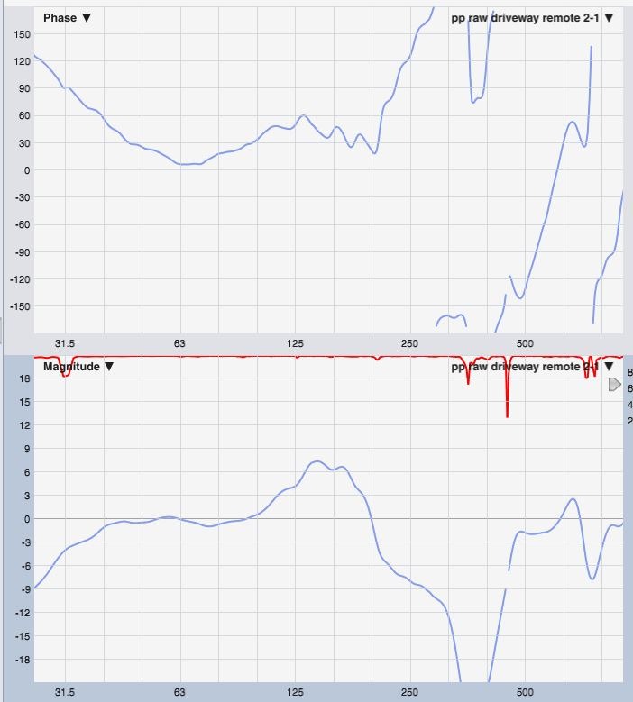

You made me pull up a raw measurement and check a shallow (for me) slopeWith a steep enough slope like you use it wouldn't matter, but at 24dB /oct it was still interfering in the response with an 80Hz crossover.
My slot, which is wider than camplo's gives a notch at about 370Hz. And a boost in response as shown.
A 24 dB/oct low pass at 100Hz, (above the 80 Hz you mentioned)....needs but a little attenuation to bring the peak down to curve.
And the notch is entirely inconsequential.
![ppsl raw drive.JPG ppsl raw drive.JPG](https://www.diyaudio.com/community/data/attachments/928/928090-2d7a33df7b605ec762f7a2da2286dcbe.jpg)
So imo, a PPSL or any dual opposed sub, is very viable and desirable, steep xovers or not.
