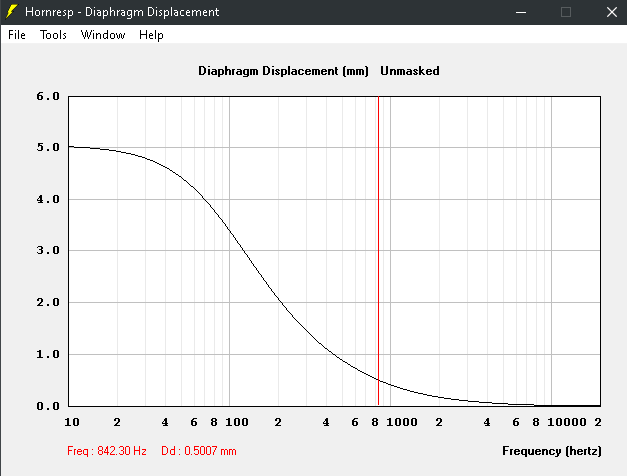

Seems like 800hz is about right for the Axi no less than any proper 4" compression driver, with exception that the Axi would have better midrange or slightly lower extension, via slightly more excursion ability. I'll gamble and say that Axi has about 100hz more extension than the alternative compression driver. 300hz vs 400hz with a horn for pro use.

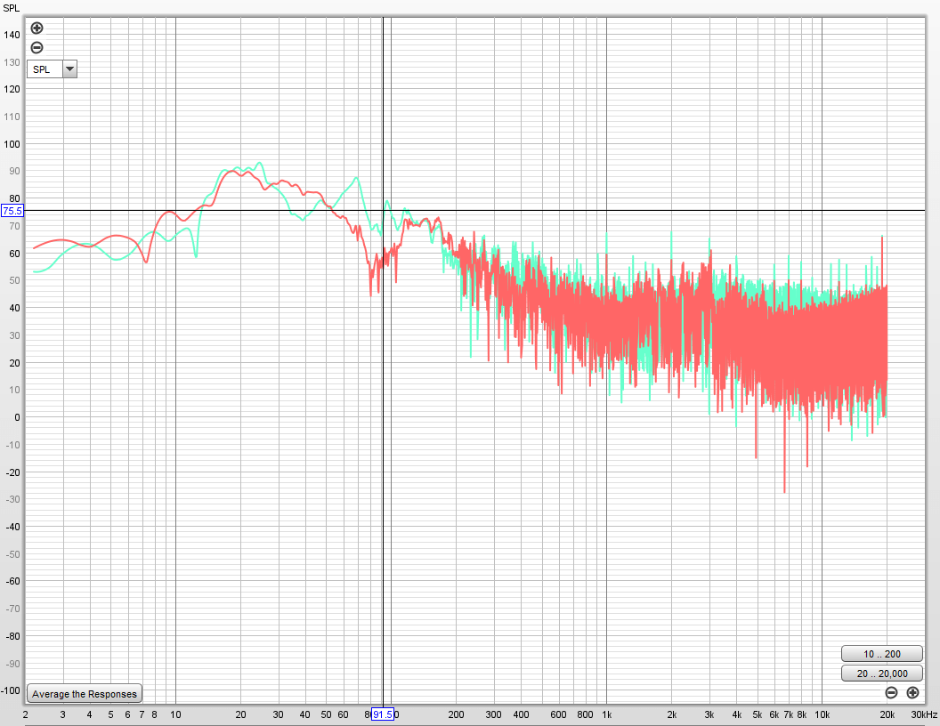

Messing around with EQ....I am really impressed with the effectiveness of EQ on the response. The green is the low pass 2nd order at 21.5hz. The Reddish color is after some eqing. My EQ as not so effective in my previous system I feel (a 12" about 27" off the ground, 7ft ceilings).
This is in a completely different room so take with a grain of salt. It seems that, Room eq is more effective with the principle of having the Bass Source in close proximity to the floor plane, along with the higher direct energy of the larger system. The 26" tall slot allows an increase in the height of the source. My woofer is off centered towards the top of the slot....I wonder that means for the end result, At some point I need to get this into 3d sim.
In Vituixcad I had to flip polarities sometimes, according to the type hp/lp....In real life I think with reflections, one still has to a/b, polarity, and decide "in-situ", what ends up best for the XO living within the room modes.
I also just realized this dsp has 32 bands of eq per driver...
Its funny, now that I am attempting to room eq the mid woofer which is about 36" off the ground, the predicted response of Rew isn't lining up with real life results. I'm giving it a go but these "91.1hz 18gain followed by 95hz -19 gain" type filter jobs don't seem to come out.
On a 240 dB scale everything looks a little prettierView attachment 1019314

Get that left scale to present ~50 to 60 dB, from 40 up to 100 would be nice in this case.
Thank you fluid.

Could be - If you try and boost an acoustic cancellation you will probably not end up with much gain. (The old 'Bring down the peaks, don't boost the dips' mantra )Can someone explain whats the issue when the prediction is off? My guess is that it was trying to correct something that was more to do with room versus direct energy
Have a read of this, it should help you to identify something that can be easily corrected vs things that cannot
https://www.roomeqwizard.com/help/help_en-GB/html/minimumphase.html
