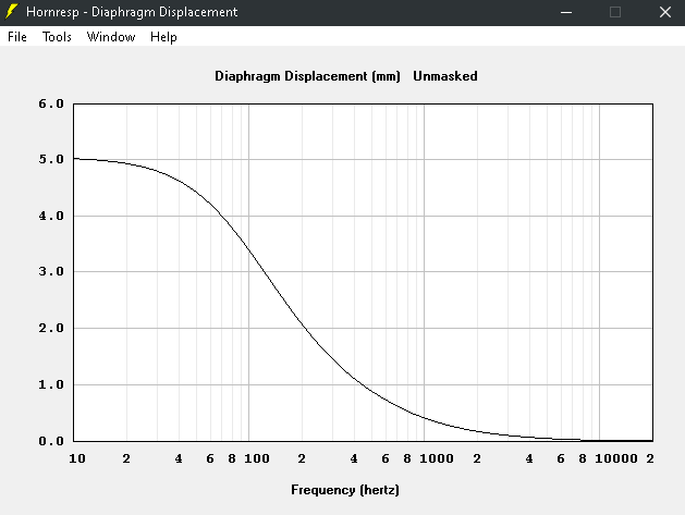

looks like we could do a pretty low Xo to me.
Camplo,

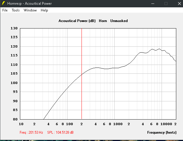

The Hornresp simulation uses a flat circular piston as the model for Diaphragm Displacement. A flat piston's displacement is simply Sd x excursion.
The Axi2050 has a ring radiator diaphragm, the inner and outer annulus is fixed (no excursion) the center can move approximately 1mm, the average displacement being that of a 4" (100mm) diameter piston moving .5mm.
The center point of the Axi2050 diaphragm will hammer the phase plug at approximately 1mm excursion, while the displacement equivalent would be only .5mm.
Your Hornresp simulation indicates that .5mm is reached at about 800 Hz, at 108 dB, with only 2.83v input (1"watt" into an 8 ohm load), but you used 200 rather than 78.82 for S1, oops.
Try again.
Art
Art, I always want to believe that the Axi2050 has 1m of linear travel in either direction....800hz is what I would of guessed for most drivers.
Earl gets it (thanks!) but you will believe whatever you want...
The AE woofer is a soft bottom Xmech design.
The Axi2050 has a "hard bottom", it hits Xmech (1mm travel one way when the diaphragm contacts the phase plug), it's displacement being equal to that of a 4" diaphragm traveling 0.5mm one way.
The Axi2050's relatively heavy diaphragm reduces it's HF output sensitivity considerably compared to most 4" diaphragm HF drivers, your OS horn model with rising HF response was a giveaway something was wrong with the model.
There are no decent 4" diaphragm drivers that will reach 0.5mm one way at 800 Hz with only 108 dB output if mounted on a usable horn.
A 1.75" diaphragm driver on a 90 degree OS horn could easily exceed that level without reaching excursion limits.

I wonder what allows the Axi more low frequency extension if the displacement is no different than the 4" diaphragm
I cannot say because I never reached it on my axi with or without the horn....have you? Without the horn, things got too loud, before I could reach xmech, full sine sweeps with no xO.

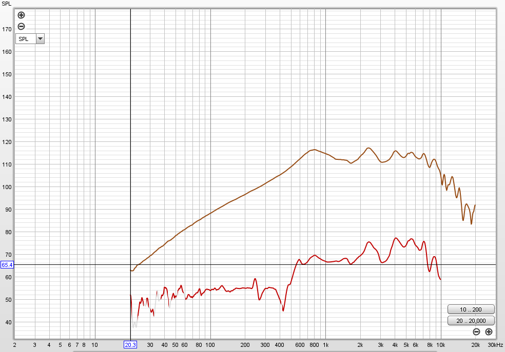

This was taken with the mic right at the exit. If I use the pink noise slope to figure head room for the tweeter, placing 115db peak at the bass....above 600hz something around 105db is needed? By 20khz 85db is needed.
My mock up is pretty crude its just a 78.82 diaphragm with a 2" exit in front of it.

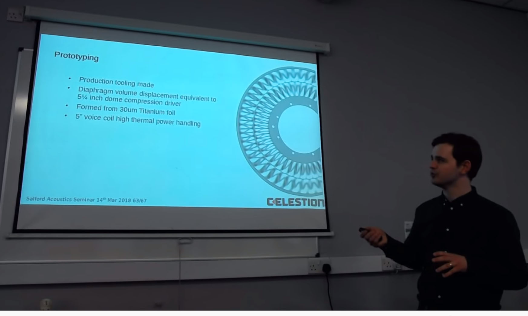

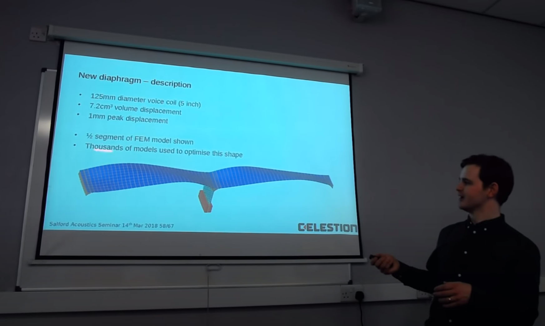

Diaphragm volume displacement equivalent to a 5-1/4 inch dome
1mm peak linear displacement (sounds like its more like 0.9mm) 7.2cm3 volume displacement.

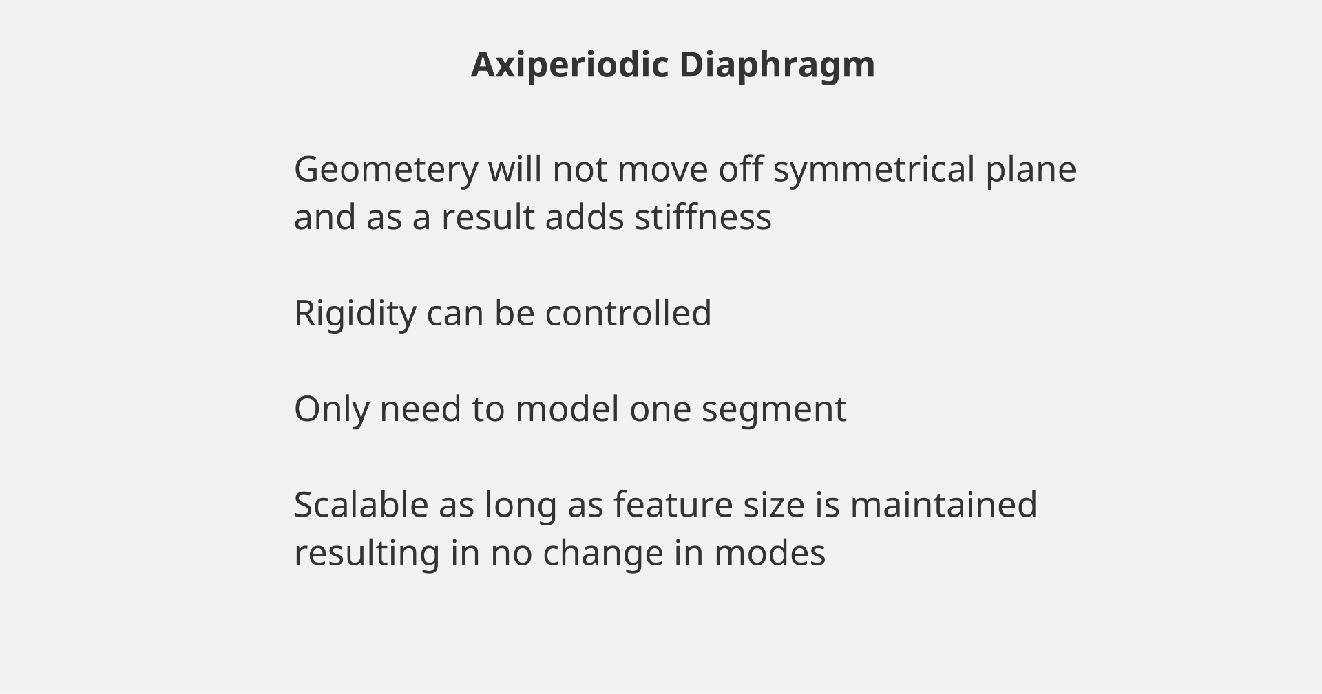

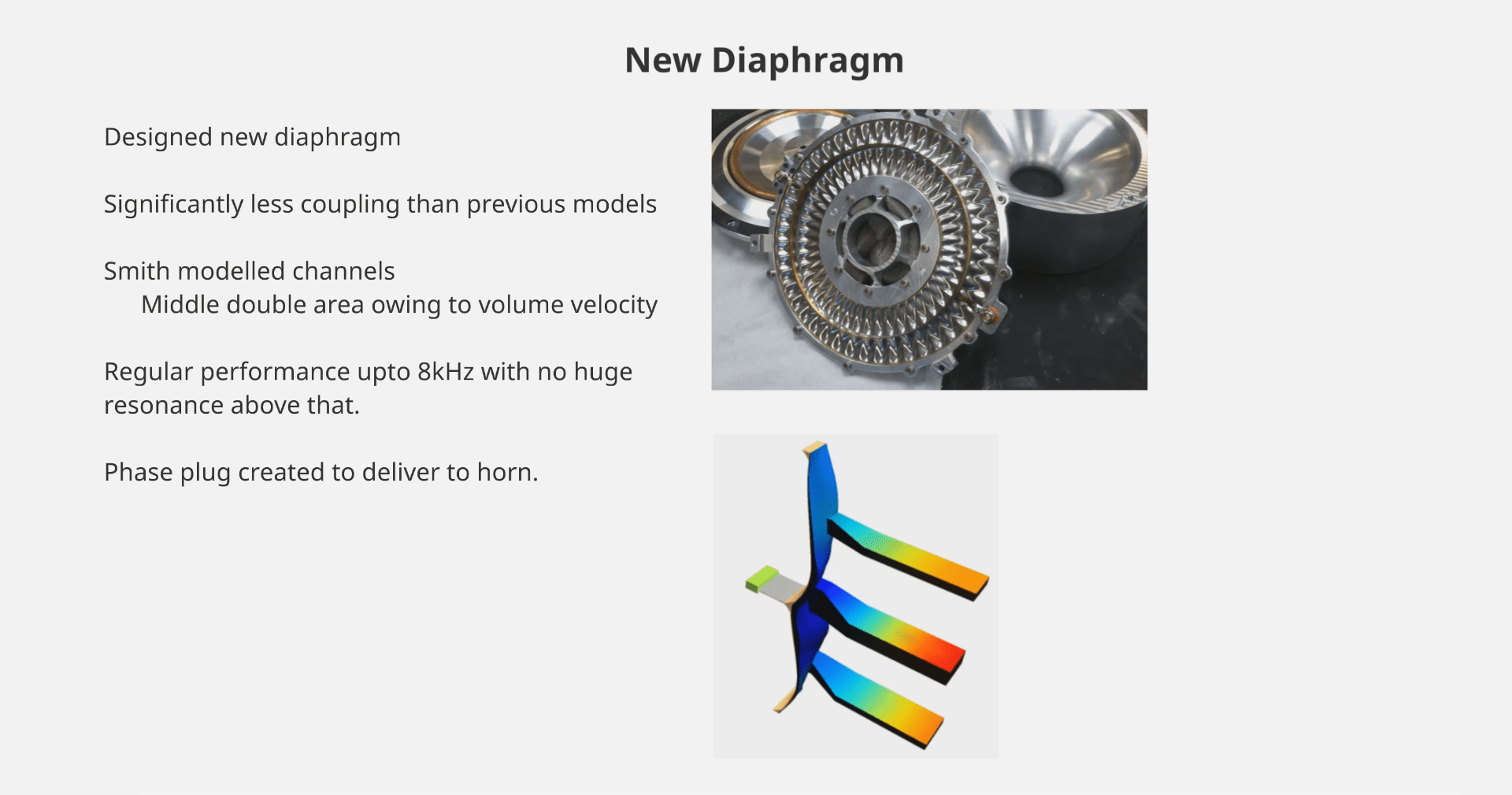

The axi has a very different operation to most compression drivers you can see in the exploded photos and videos. The displacement and Sd they are quoting is the equivalent value that it would be for a normal dome.

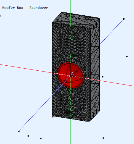

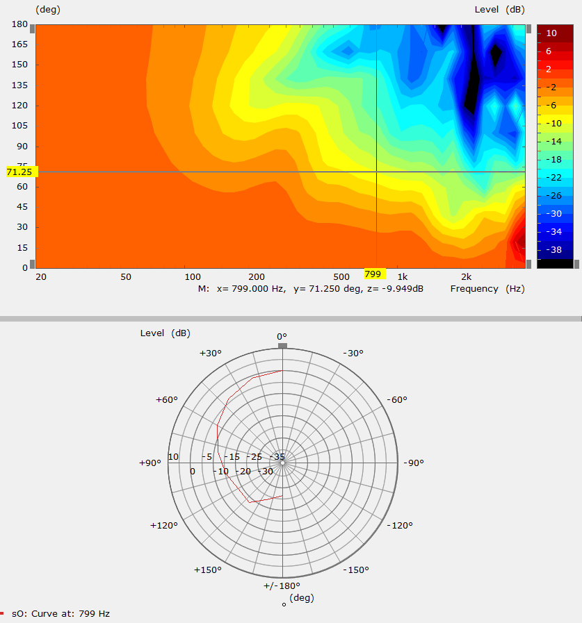

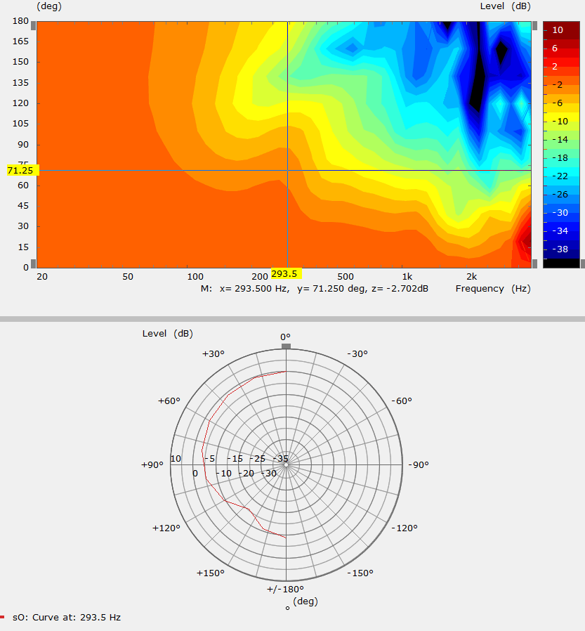

To go back to the point about the woofer polar and the cabinet it is in. Here are some graphs that show why I think it is a good idea to go with something like Earl and bmc0 did.
With a 15" woofer here is the 180 degree directivity polar screenshot at different frequencies to show the line chart view of directivity. I think this a good way of showing that the woofer and box by themselves produce a pretty decent supercardioid response from 1k to 400Hz and there is still 10dB of rear rejection down at 300Hz, which doesn't go back to zero until close to 150Hz.

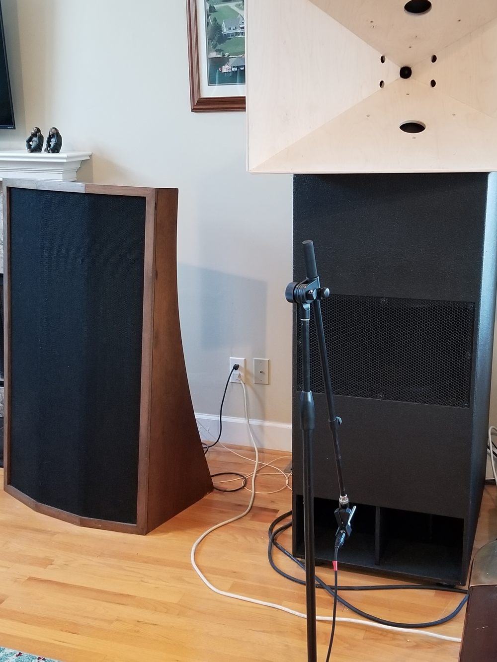

Hey camplo, just as an example and some food for thought.....

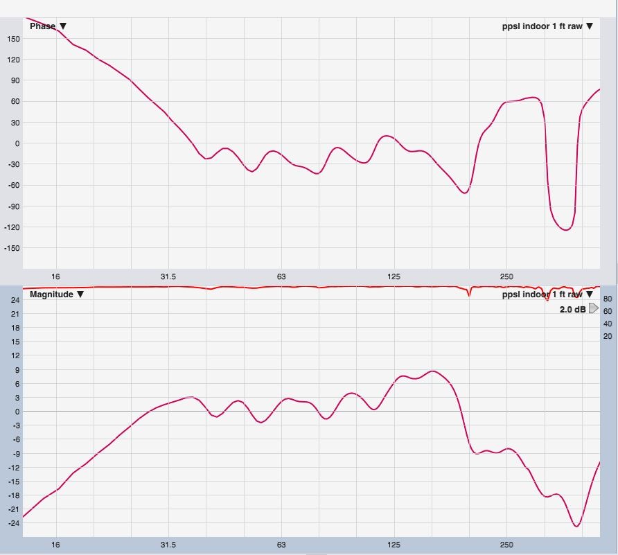

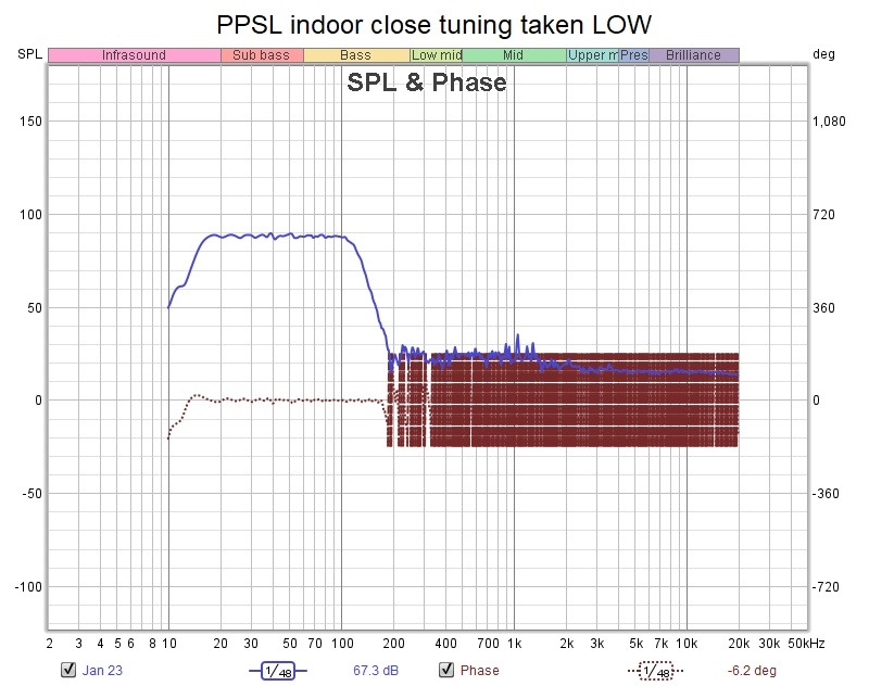

I showed earlier in #9544, the tuning i have with my PPSL's made outdoors, which has f-3 @30Hz (really more like 28Hz) .
For grins and illustration, i've made an indoor tuning to go lower.
Here's the mic setup, simply placed between driver slot and ports, about 1/2 m away. Followed by the raw response.
There was surely more ripple than outdoors, but quite a bit less than i expected with that mic placement.

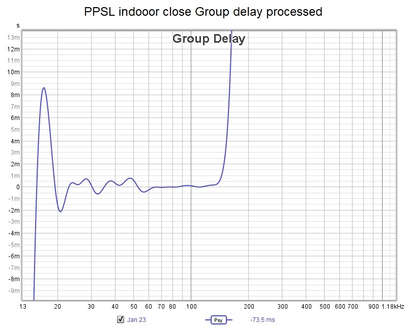

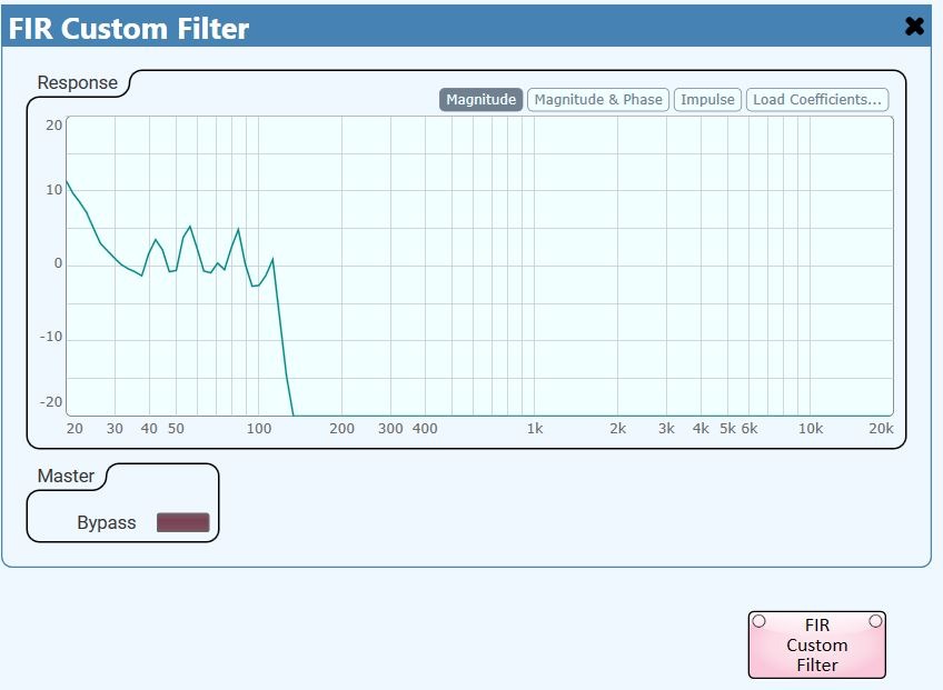

Anyway, popped the raw response into FirD, and said take her response on down to 20Hz or so...
here's the processed response, followed by Group delay.
SPL is 1/48th, Group delay is Psy, as i'm sure you've learned how unreadable any GD trace is without smoothing
here's the processing magnitude curve to let you see the boost applied to go low.
Boost not all that bad really....well, i shouldn't say that until checking excursion in Hornresp, should i?
The ripple adjustments are hokey, and shouldn't be that extreme, but i let them in to show the simple power and ease of FIR.
(Outdoor 4m ripple adjustment are much smaller and fine ime...)
Ok, the food for thought....
This PPSL is bass-reflex. Is that a group delay curve you could live with?

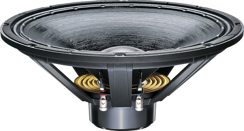

A couple of 15 woofers (not a typical midwoofer) can easily cover the first 4-5 octaves, without IMD etc. becoming an issue.
Voilà, the recipe for a high output 2-way monitor.
