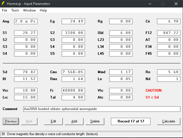

My mock up is pretty crude its just a 78.82 diaphragm with a 2" exit in front of it.
78.82cm2 is the equivalent Sd of a 100mm, (4 inch) diaphragm, the Sd Axi2050 of the Aragorus was provided from Celestion along with the other lumped model elements you loaded in the simulation posted in #9615.

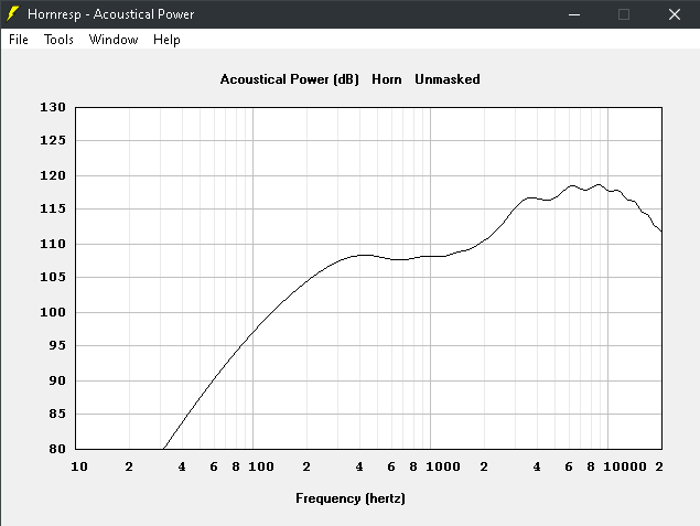

You used 200cm2 (a default parameter, IIRC) for S1 in the Hornresp model, which would be the equivalent of starting the horn with a 160mm diameter circle (over 6"), but the Axi2050 has a 50mm (2 inch) exit, only 19.63cm2. That "horn" would provide no low frequency loading, hence the rising, rather than falling HF response.

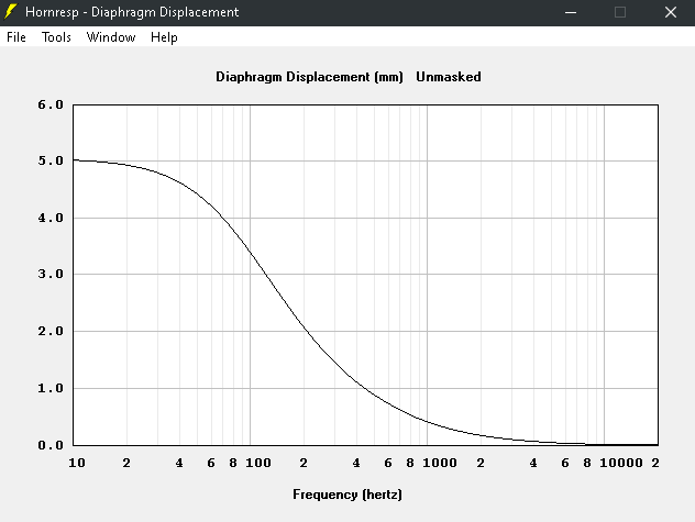

Probably a lower Fs. It's plane wave LF impedance bump is an octave or more lower than many 4" diaphragm drivers.I wonder what allows the Axi more low frequency extension if the displacement is no different than the 4" diaphragm
I have never heard the Axi2050, but I have heard the sound of aluminum 4" JBL 2440 diaphragms reaching Xmech, and replaced many of them that shattered when crossed at 500Hz using the 220 Hz cutoff JBL 2350 horns.I cannot say because I never reached it on my axi with or without the horn....have you? Without the horn, things got too loud, before I could reach xmech, full sine sweeps with no xO.
The Axi2050 titanium diaphragm should withstand hammering the phase plug with less damage than aluminum.
That said, I honestly don't know if the Axi2050 surround is capable of enough excursion to cause contact, but it would be easy to test at low frequency- I'd think it would start clicking at 20 Hz with under 10 volts sine wave below a conversational (60dB one meter) level.
No its not, I used 20.27....Wait....Yes I did. 🤦🤦🤦
A comedy of hornresp errors....yes, but the non 2" exit is not on purpose lol!

That makes 2 of us. I tried to ease into it and the volume started getting too loud, so I figured, why even touch xmech if I've proven that the driver can out SPL me with an XO........I'd say like to see if I can use EQ to extend the range...That said, I honestly don't know if the Axi2050 surround is capable of enough excursion to cause contact, but it would be easy to test at low frequency- I'd think it would start clicking at 20 Hz with under 10 volts sine wave below a conversational (60dB one meter) level.
I'll fix my sim and see what it says. WIth the waveguide setup, I have to let go of any XO goals.....I know that. Its still possible that the AXi2050 can go a little bit lower than the other compression drivers simply from low distortion surround and a little bit more excursion capability.

OK this is my fault still but....The graph is actually as it should be. My s1 was "correct" when I produced the graph. I tried producing a small waveguide, not sure why I landed where I did, but the point, was to create something where the low end was not assisted.You used 200cm2 (a default parameter, IIRC) for S1 in the Hornresp model, which would be the equivalent of starting the horn with a 160mm diameter circle (over 6"), but the Axi2050 has a 50mm (2 inch) exit, only 19.63cm2. That "horn" would provide no low frequency loading, hence the rising, rather than falling HF response.
