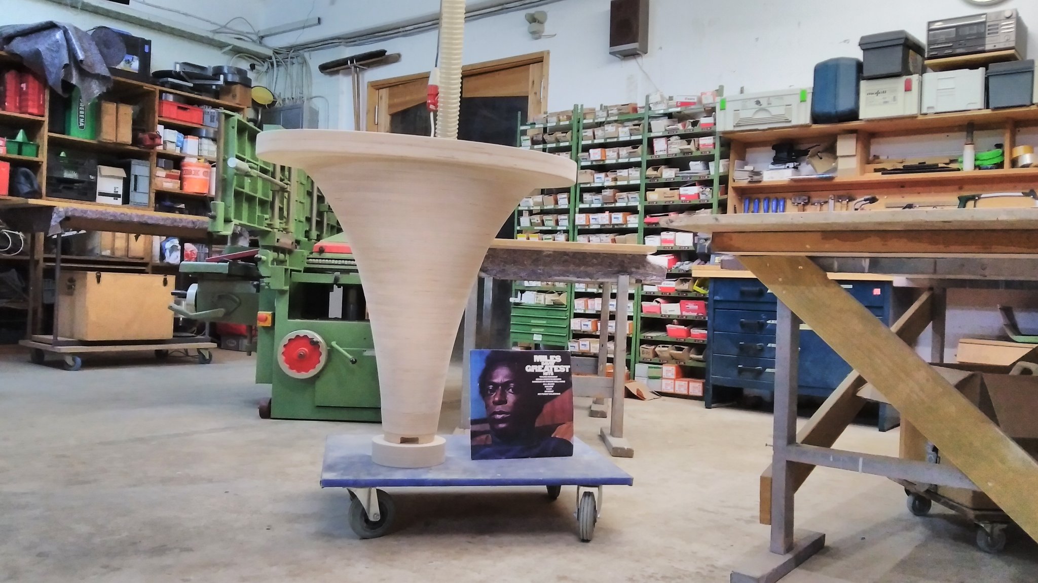

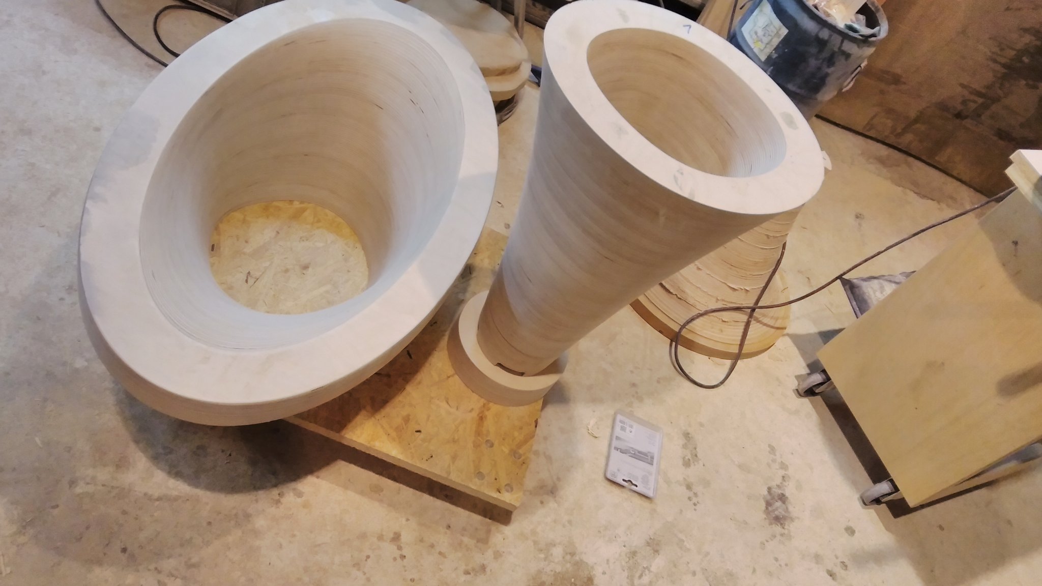

Mmmhh, hard to see on the photos but it looks like a truncated tractrix profile. Even if the profile is transformed to an ellipse there should be 180 degrees exit angle everywhere around the mouth. The vertical has almost no flare and it will beam like hell. What you also will get is a huge waist banding effect especially in the vertical plane. You cannot correct this with EQ.lol, it is, good thing I am able to see both sides of the fence...

Guess I will see first hand... In hindsight I would recommend just buying a cnc router and going to town,Mmmhh, hard to see on the photos but it looks like a truncated tractrix profile. Even if the profile is transformed to an ellipse there should be 180 degrees exit angle everywhere around the mouth. The vertical has almost no flare and it will beam like hell. What you also will get is a huge waist banding effect especially in the vertical plane. You cannot correct this with EQ.
