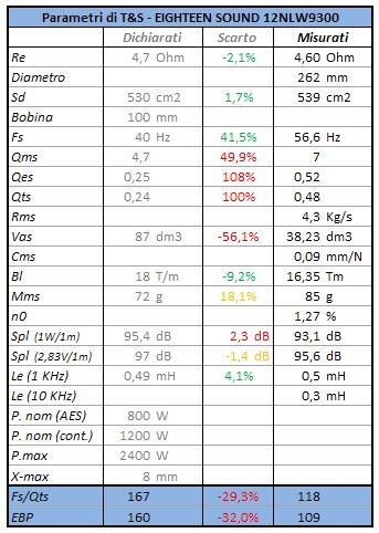

The 12NLW9300 isn't a bad woofer, even though the measured parameters deviate from the specs and it's not particularly efficient.

Add to this the (frictional) losses inherent to the electro-magnetic structures and suspensions of nearly all modern pro woofers and it becomes obvious why very few large format 2 way systems are tube-friendly, despite the (specified > not necessarily realistic) high sensitivity.

Beyond baffle step these higher efficiency woofer have either to much motor not enough mass or both so they are not good candidates for sub 40Hz if they can even make 40Hz. I wouldn't consider any speaker as "tube friendly" without looking at the impedance/phase plot. They can say what they want! The plot doesn't lie.

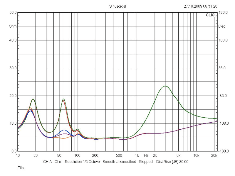

The man who recently installed this custom 2-way system:
- Green: Impedance without linearization,
- Orange: Impedance with cross over impedance linearization but without Low frequency-impedance linearization
- Blue: low frequency impedance linearization put on Low
- Purple: low frequency impedance linearization put on Medium
- Yellow: low frequency impedance linearization put on High.

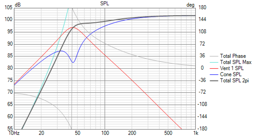

There's plenty of output left after BSC around 200 Hz:
