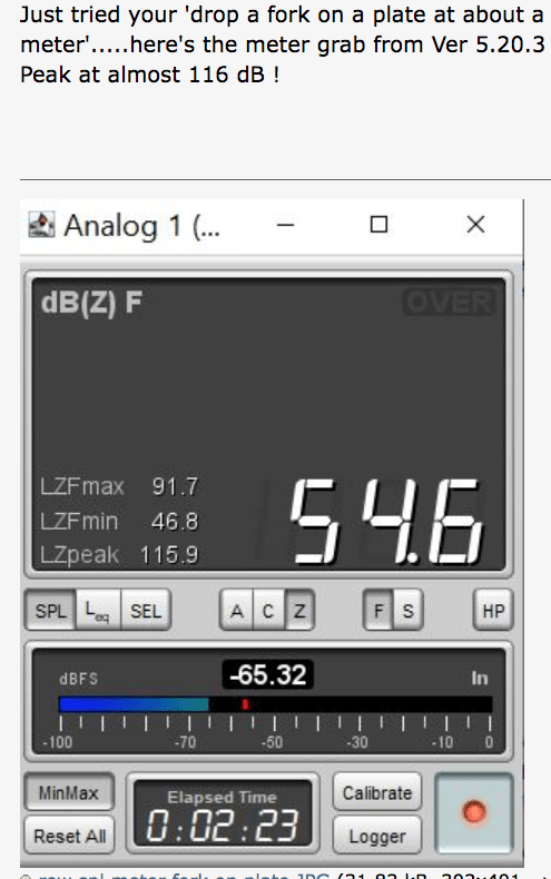

At one meter, a HF transient from dropping a fork 1 inch on a plate is over 100dB, a fingernail clipper can put out in the 110dB SPL range, but won't read anywhere near that unless you can record the peak.When judging peaks vs rms is REW good enough for this or do I need to run this through my DAW and visit a true peak limiter or something simular?
When we talk about this peaks vs rms the idea of a 115db at 1 meter comes up....
Mark 100 just did, recently:
Perhaps you never play your drums as loud as a fork dropped on a plate, good for you!
Of course, you would never want to record an instrument's HF transient or hear it reproduced with the dynamic range of actual live music, would you ;^) ?
Bass heavy rap material often has hardly any crest factor in the low end, and may be less than 12dB (like pink noise) in the top. Less crest factor sounds louder because the average level can be recorded higher.The Peak, as I see it, being the highest part of the Mix, normally resides on the Sub bass side...And when visiting the Bass heavy rap material, it normally is 20-30db over the midrange.....
Retain the HF transients of real music in recording, and watch the average level drop by 10 dB (or more) and when it sounds only "half as loud", engage peak limiter, crank it up...
