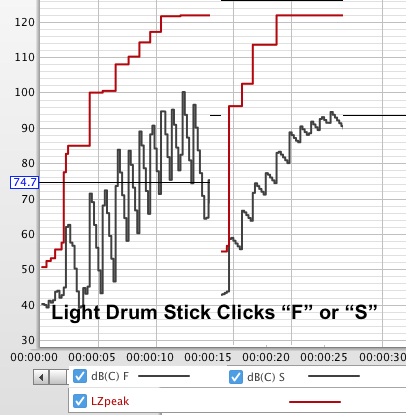

Light drum stick clicked together are over 120 dB at more than a meter distant, though would read only read 88 dB(C)S (slow).
Hitting an Latin Percussion "Jam Block", a plastic imitation of a wood block, with a heavy stick had to move it to another room to not go over 122 dB, at which point the measurement system using an iMac internal mic was clipping.
Even with the Jam Block half closed and damped with gaffers tape and paper towel, (dropping the resonant frequency from around 1kHz to 700Hz), it still was too easy to go over 122dB.
If a recording is clean with no limiting, drum peaks in the 500 Hz and up range may be +30 or more than what a dBCSlow reading will read. Having monitors that can reveal that requires some serious headroom.

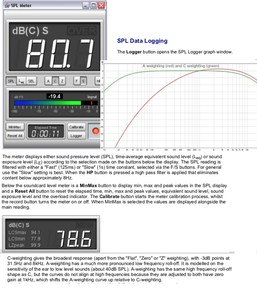

When it comes to musical transients, the time constant, (or “time weighting” taken from the weight of an analog meter’s needle filter used to slow it’s movement) used for the SPL reading makes a huge difference in the average reading. “Impulse” has a time constant of 35ms. “Fast” is 125ms, “Slow” is 8 times that, one full second.I need to check this stuff out in a C weighting lol... because 85db peak Z weighted is almost loud...and 95db is loud....God forbide anything to touch 120db in the midrange or treble...🤣
“Peak” does not any time constant applied.
Peak level is the true peak of the sound pressure wave at maximum.
A monitor level of 79-85 dBC “Slow” is not an indication of peak levels, which can have a duration far less than impulse. If Krivium or you are using “dBC slow” as a reference of 20dB dynamic range, that is a completely different reference than what the actual range may be.

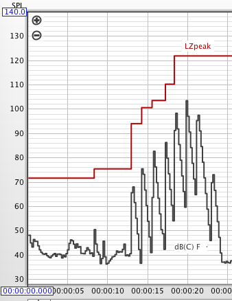

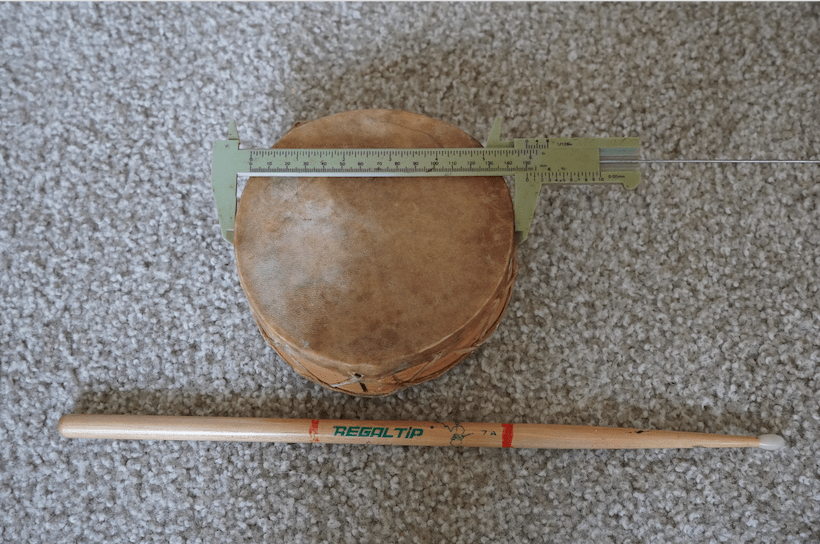

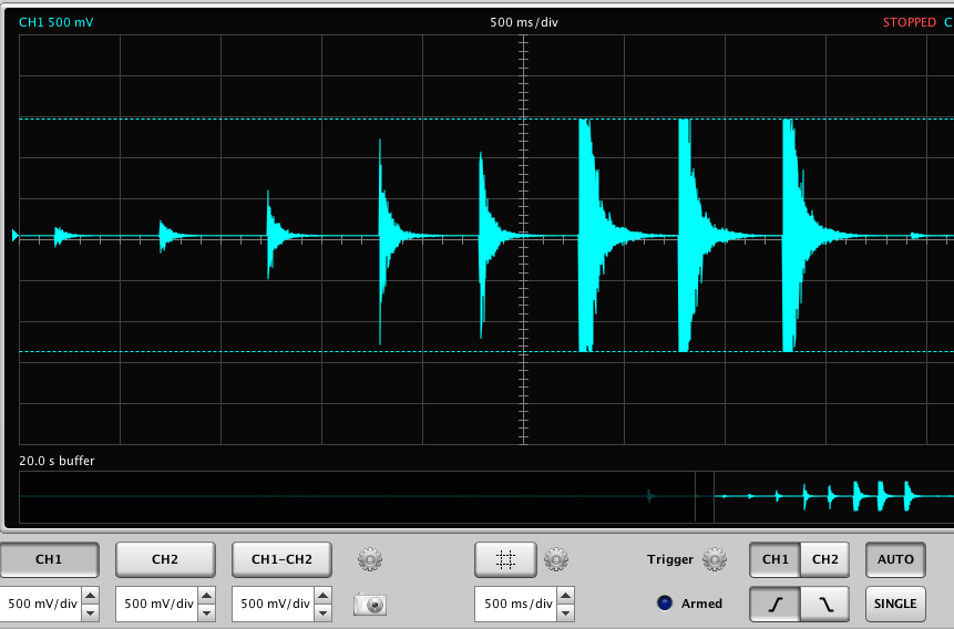

Using a little 6” (150mm) drum, approximately one meter from the microphone in a 4x4meter room, with a noise floor of 40-50dB(C)F (Interstate Highway 75 and air conditioners outside the window..), the eight drum hits rise from 68 to 102dB, while the peaks range from 75 to 102dB(Z).
Certainly not a Grammy winning performance, but illustrate a “drum solo” with a dynamic range of 80dB or more, with peaks above 120dB.
Camplo, as you well know, that little drum is a far cry from usual trap drum levels.

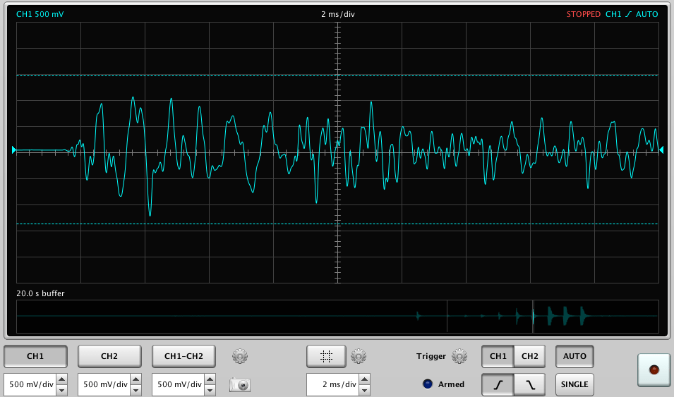

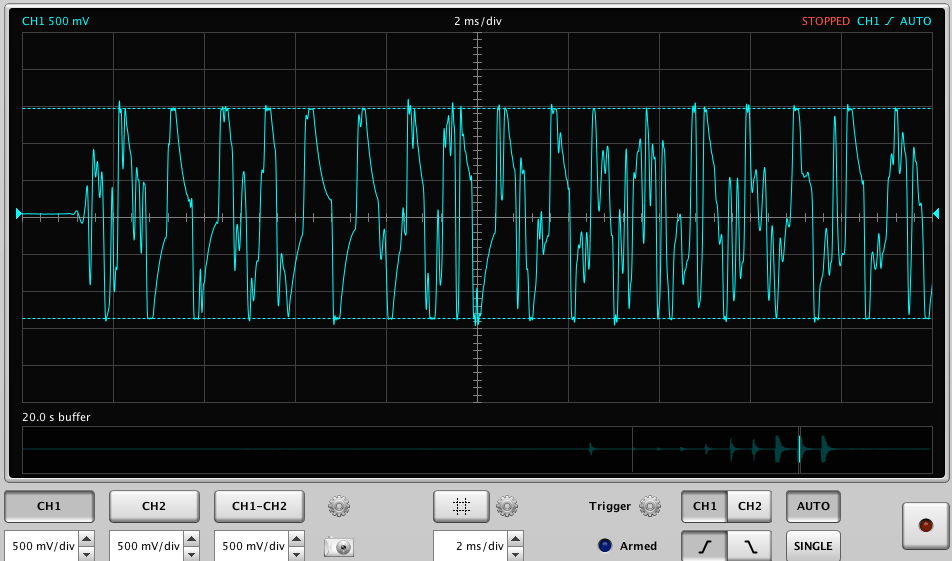

Calibrate your REW SPL meter, record some fortissimo snare hits at one meter on the logger, and if the peak Z readings are not well above 125dB, I'd be surprised, as hand claps are that loud.
That said, many mics are not capable of that input level without clipping- the flat LZ peak at 122 dB in the logger above is due to the microphone limit.
