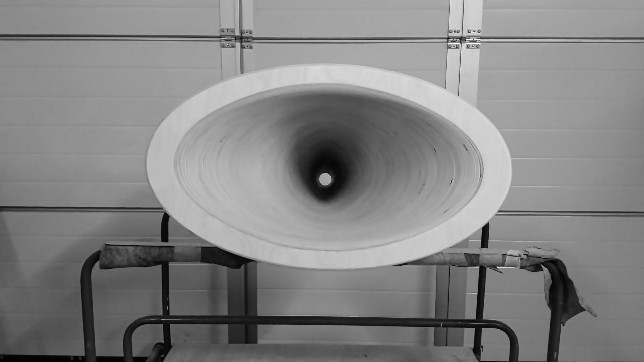

It should not be too difficult to add a provisional roundover just for testing.
Regards
Charles
Indeed, although the underlying phenomena can also have causes that are only partly or not solved at all with an additional mouth termination.
Think about the hypothetical ideal horn, which should provide a constant (purely resistive) load that matches the impedance of the driver, thus suppressing resonances.
Obviously, the mouth of Camplo's long horn is small compared to the wavelengths at low frequencies. This is one source of reflections.
Another possible source is the elliptical schape of the mouth that stretches the wavefront asymmetrically which may introduce additional energy storage (reactive impedance).
Also, we can only assume that the flare (rate) of camplo's horn does not give rise to interferences (and is therefore correct).
My latest posts may come across as very critical, but this is primarily on the basis of theoretical principles.

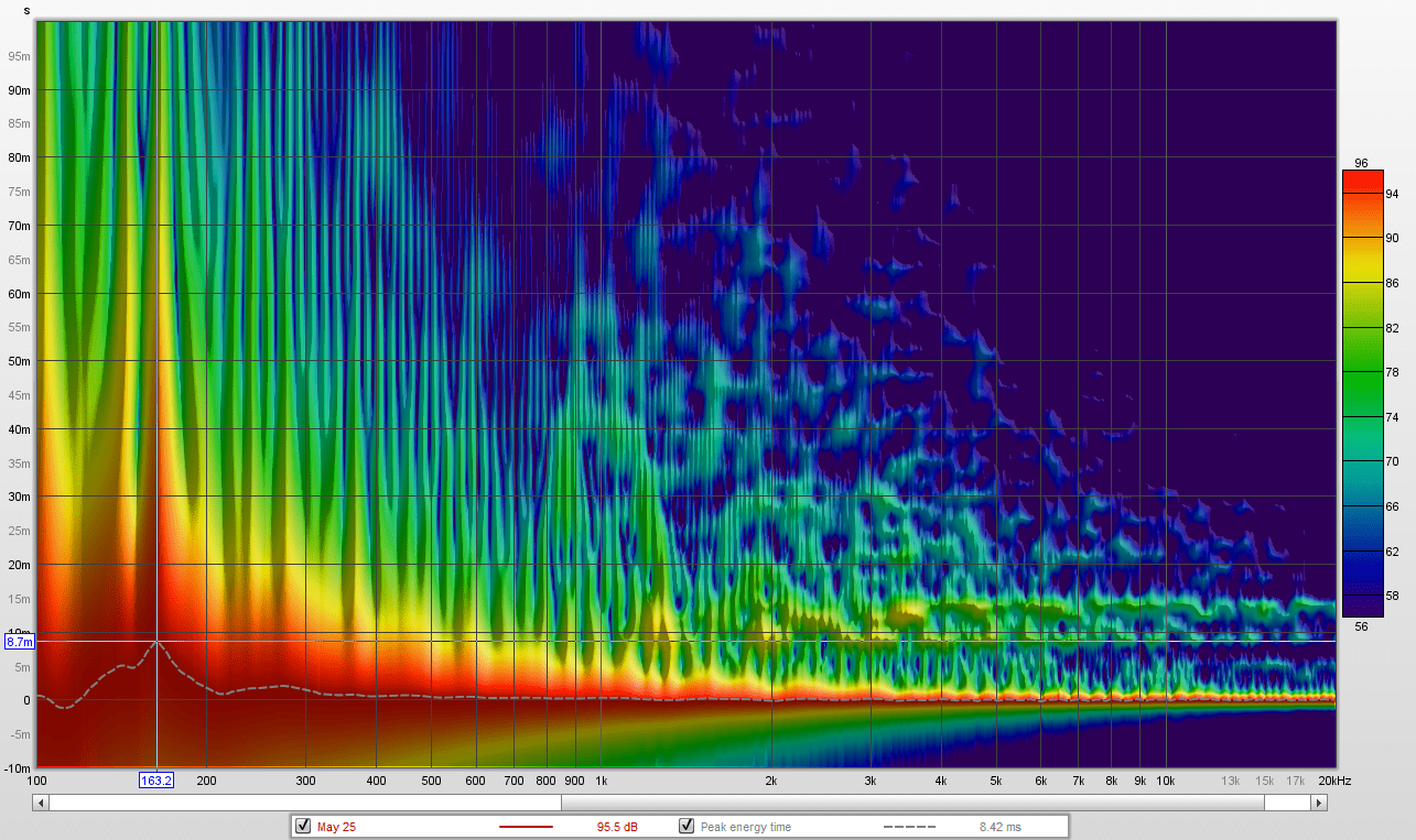

If we look at the measurements (especially the waterfall) of the smaller brother of Camplo's horn - with only the mid diaphram of the BMS 4590 connected, it becomes clear that the measurements largely correspond.
This 300 Hz variant is recommended for use > 500 Hz, since the irregularities and distortion increase sharply below it.
Therefore Camplo's horn seems usable from 300 Hz.
Camplo, maybe you can repeat the BD, or post a classic waterfall plot with different settings (time window etc.) and measured at several distance(s).
Based on the freq. response, more resonances should be visible in the BD below 500 Hz.
If the plots are as clean as your first BD, I wouldn't worry.

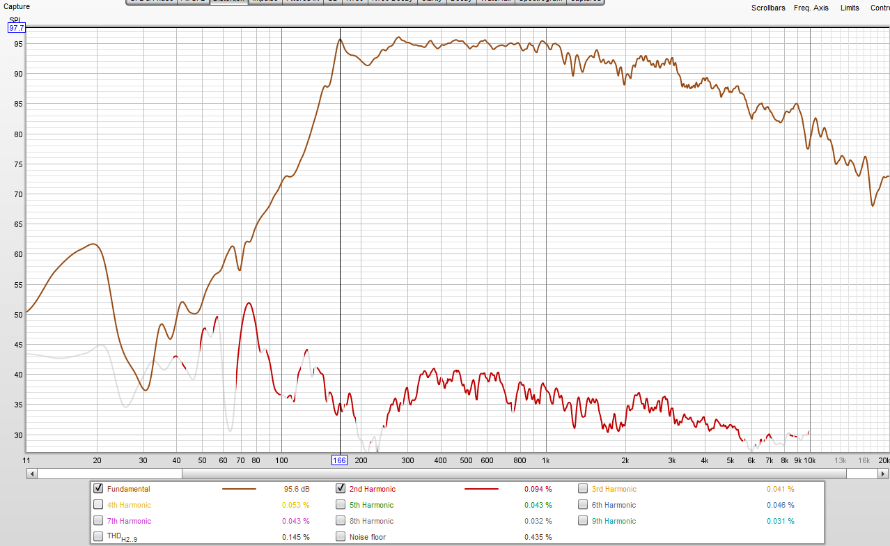

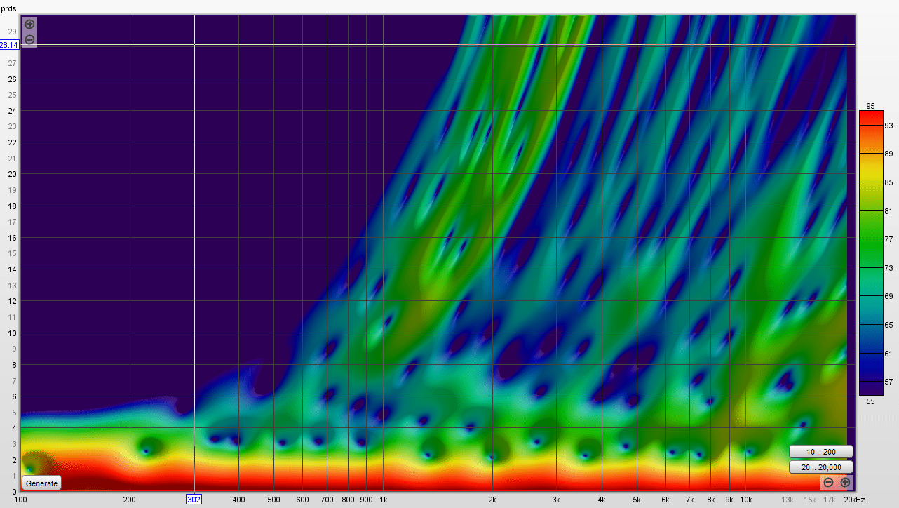

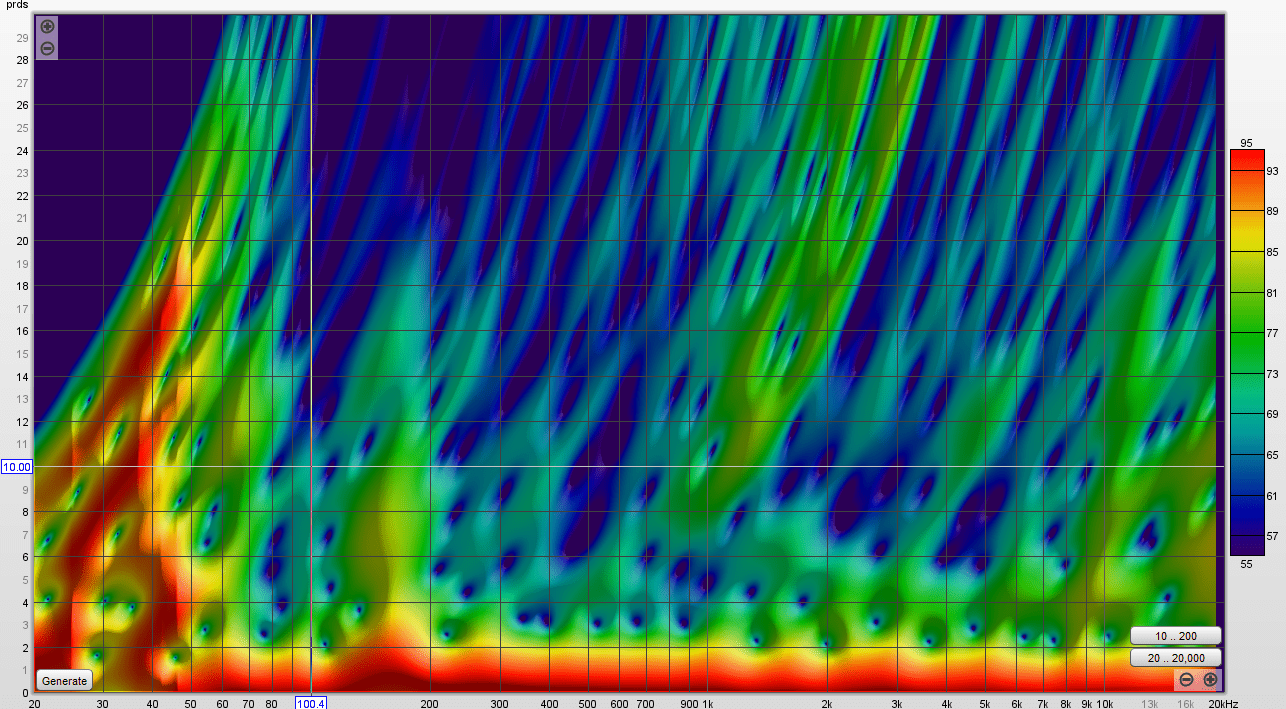

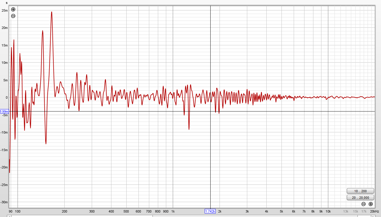

You see, with the 20ms window you basically mute the resonance at 166 Hz after only ~3 periods - it almost disappears, yet the reality is that it takes much longer.Here's the burst decay using a 20ms window
Which driver did you use?Very crude measurement, mic pointing down into the horn 1" or less above mouth...horn facing ceiling, sitting on floor...100ms window for the FR...the setting doesn't seem to change Spectrogram view....I guess those are ungated?
Rob
So the 100ms is more accurate but as I open the window, I potentially swamp the measurements with room.... gotcha...You see, with the 20ms window you basically mute the resonance at 166 Hz after only ~3 periods - it almost disappears, yet the reality is that it takes much longer.
